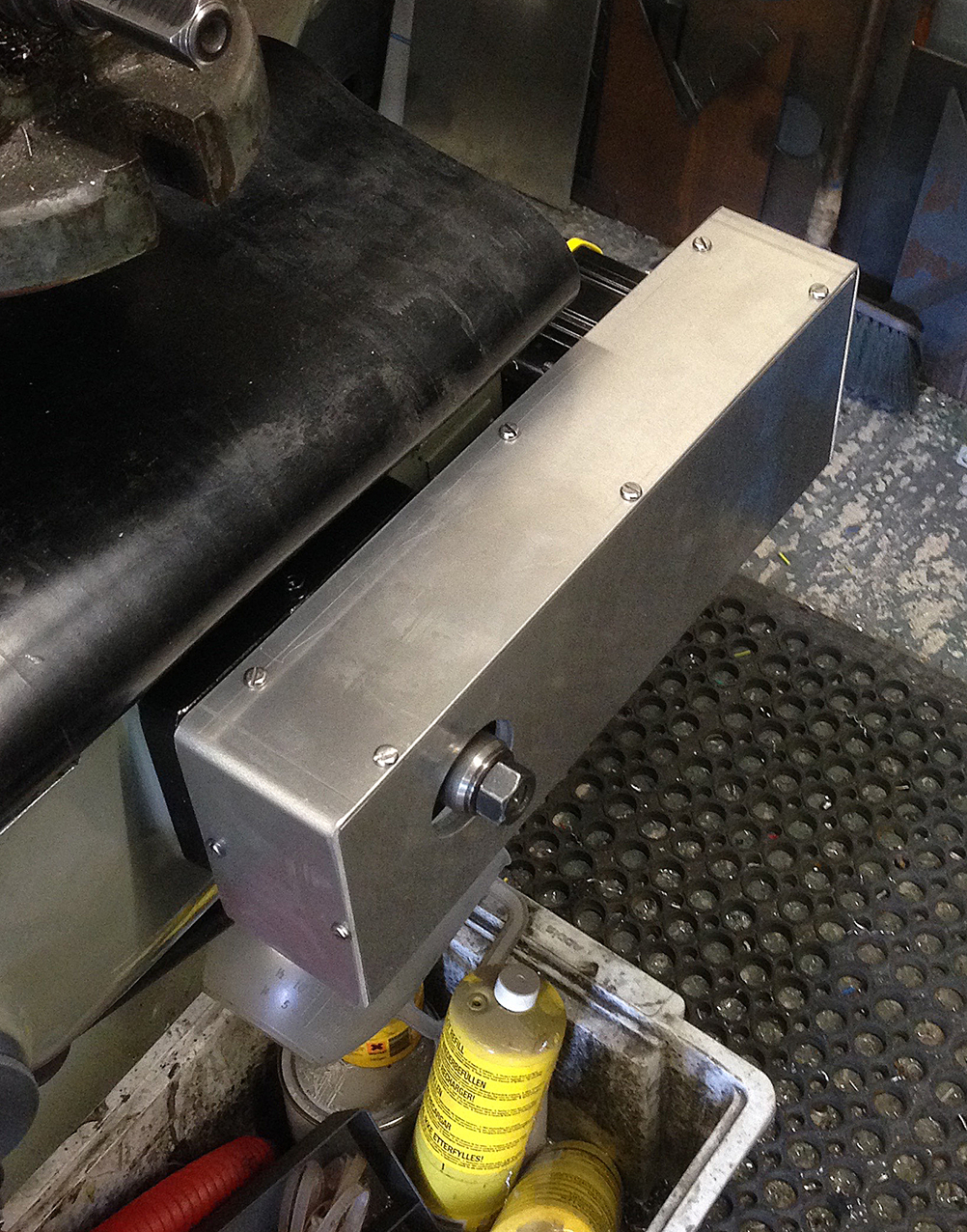

    Fitted some chip covers for the ways, nitrile rubber, tomorrow will be making the belt covers for X&Y drives.
    Lowest and most forward position...
    The front cover will just hang over the front like many of the real CNC Bridgeports do.
  3. #183
    Got the X&Y axis chip covers fitted today...
