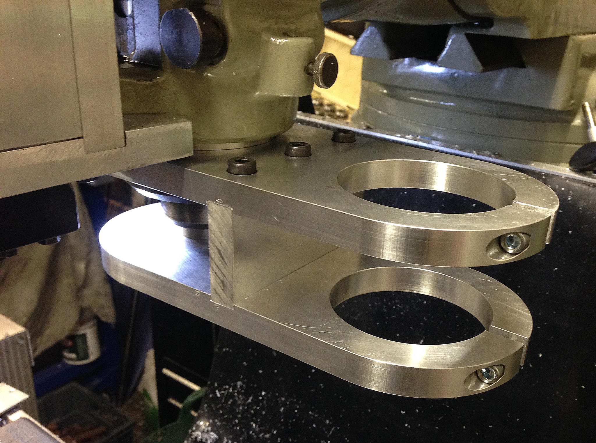

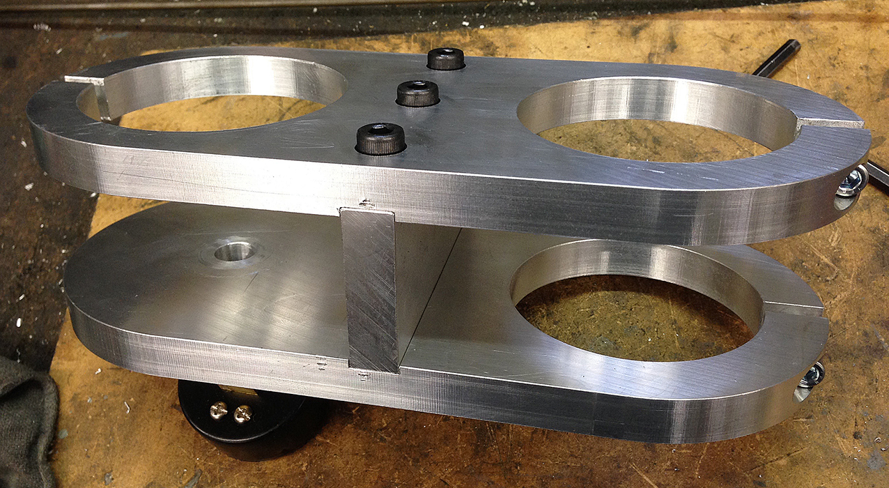

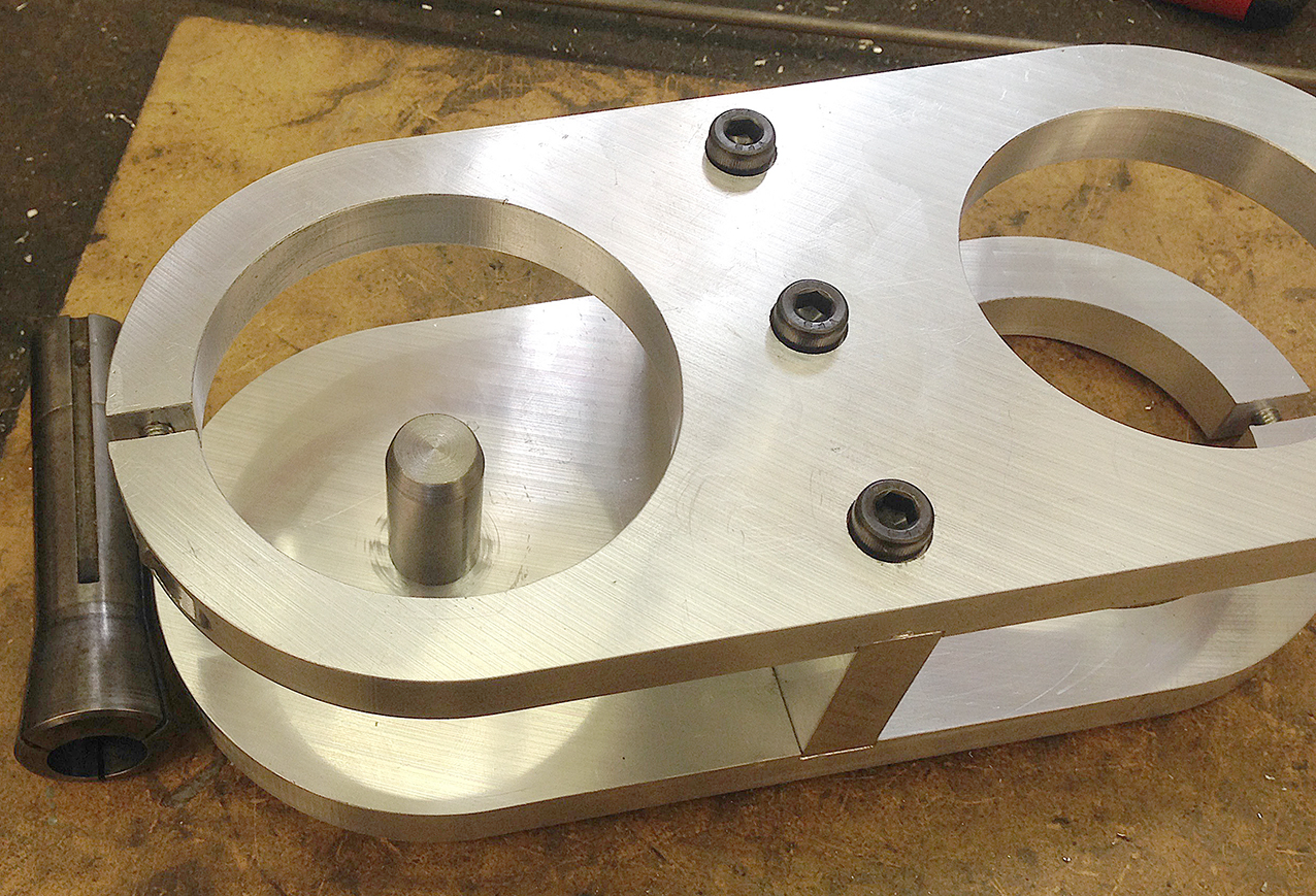

    USB Issues solved - it works well without the hub and just having two extensions, i have ordered another extension and some clip-on ferrite blocks to suppress any interference.
    Also, at last - the adaptor I have mucking about with for the last couple of months is finally done Admittedly it took so long as i was building the machine to make it and figuring out how to operate it but in the end, after ironing out all (so far) of the bugs in tooling, offsets, post-processing etc it really only took a couple of hours.
    It's also the first part designed in Fusion 360, that was a learning curve!
    It fits the mill snugly and as long as the high-speed spindle motor fits ok, should work beautifully, still got some jobs to clear before i can strip that down though.
    Total cost in Z axis travel is 22mm - not bad i thought - that leaves me about 95mm to play with but on a small spindle with tiny tooling that should be ok i think.
    Thanks for all help guys
