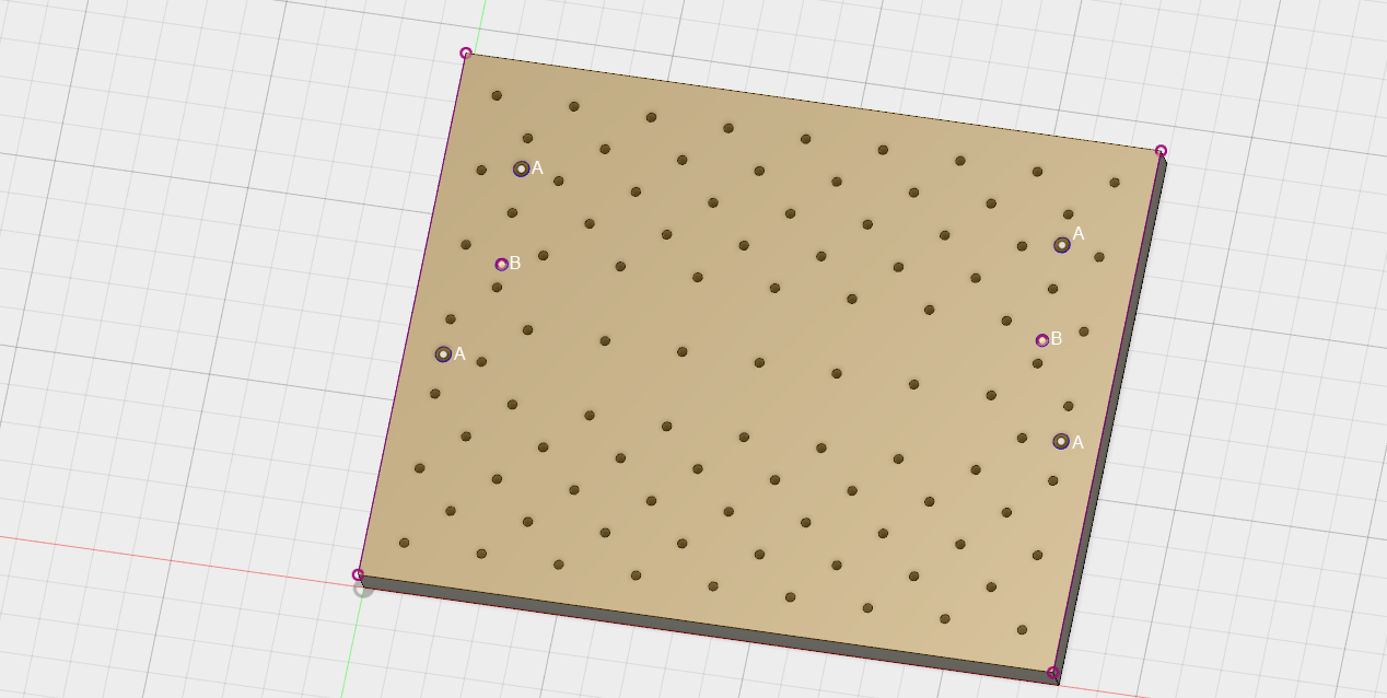

    Sub-table for the engraving spindle...
    Holes A are for M10 or M12 CSK socket-head screws to bolt into the Bridgeport T-Slots, holes B are two locating dowels on the rear face to sit in the middle slot on the main table, keep it all square etc :)
    25mm eco-cast tooling plate.
  2. #222
    Dave, once setup drop a couple of shallow keyways in the plate both vertically and horizontally so you can drop a piece of key steel in to act as back and / or side stops to get parts square
    John S -

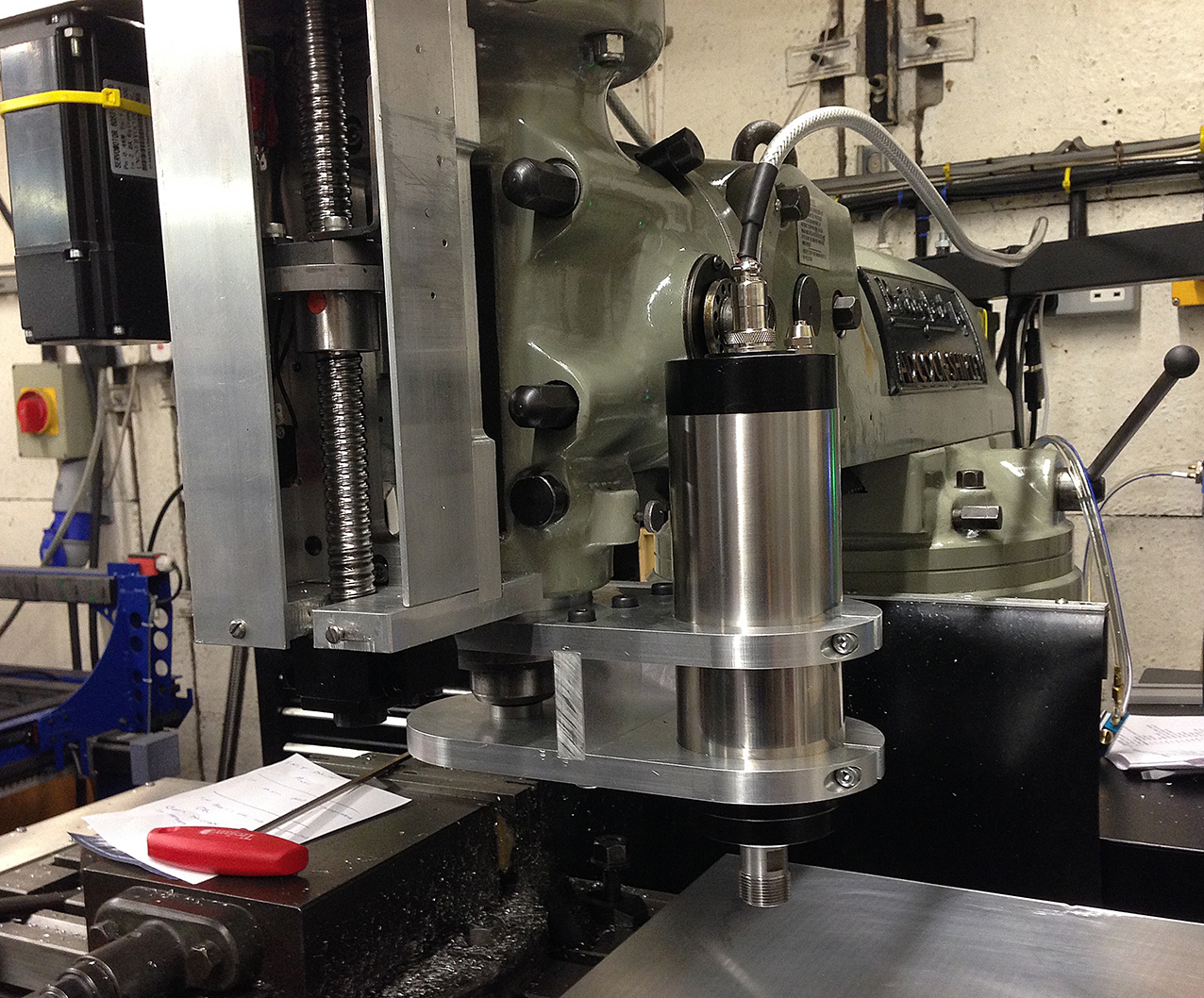

    Sub-table is coming along nicely, can just be seen in the bottom of the picture, just the matrix holes to drill & tap now...
    The new spindle motor fitted my adaptor perfectly, got the VFD dialled in nicely, just the water cooling to sort out.

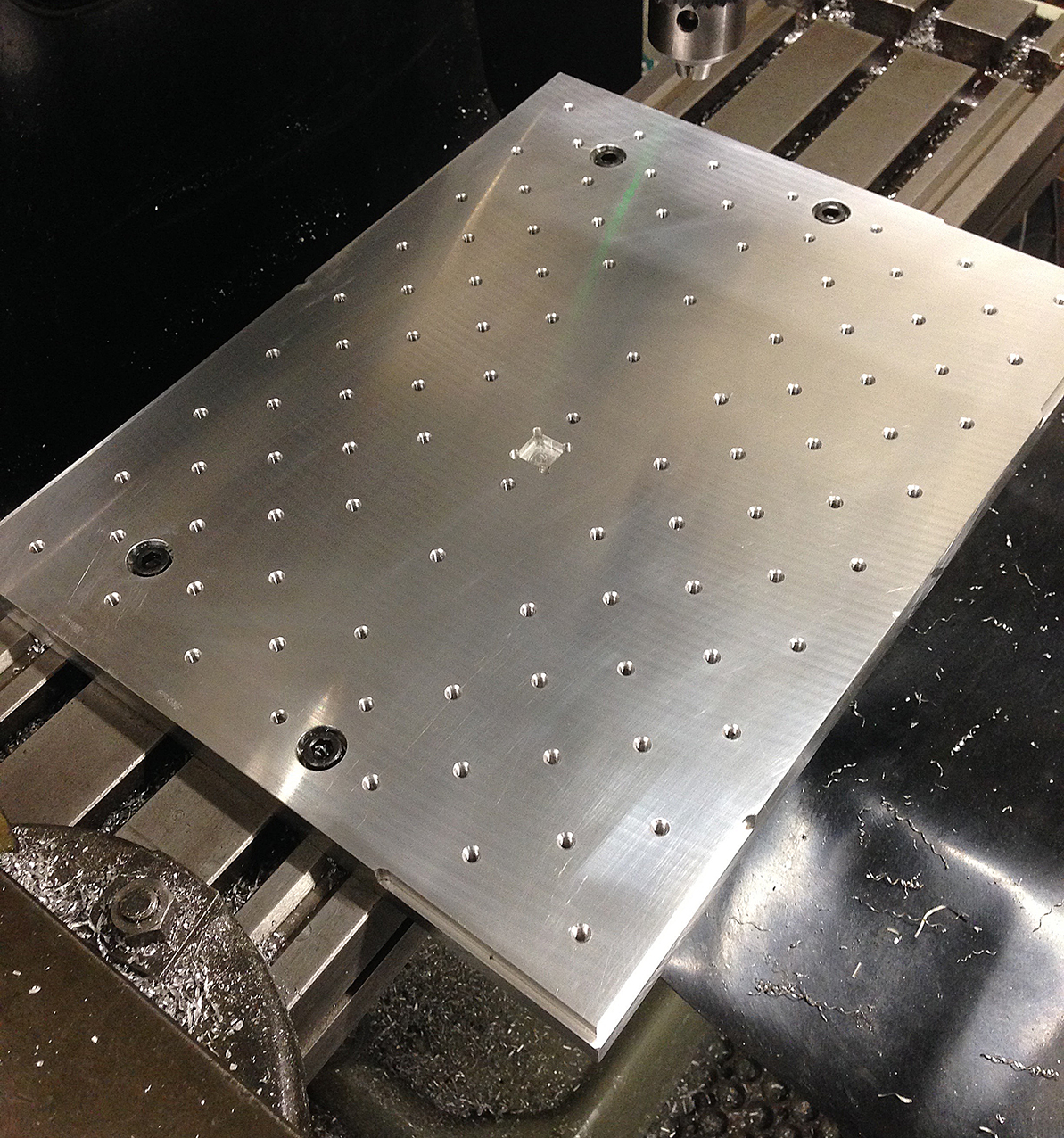

    Job done, turned out very nice.
    100 holes, spotted, drilled, countersunk, blind-tapped M6
    Surface was parallel to within 0.03mm max so i'm not going to bother running a facing cut.

    Have decided to replace the little Bridgeport motor and simple V/Hz VFD with a 3Hp inverter rated motor, sensorless-vector vfd, timing belt drive and encoder - this should give me usable torque and power from about 300rpm to 3000rpm and also semi-closed-loop speed regulation as Mach and the CSMIO controller will maintain the speed as load changes, up to the point of tripping the vfd :)
    It means i can finally get rid of the clattering vari-speed pulleys and power-sapping drive and not have to mess with setting the speed manually. I also get actual speed display on-screen.
    Also got the braking resistor so stopping time should be about 1s or less.
