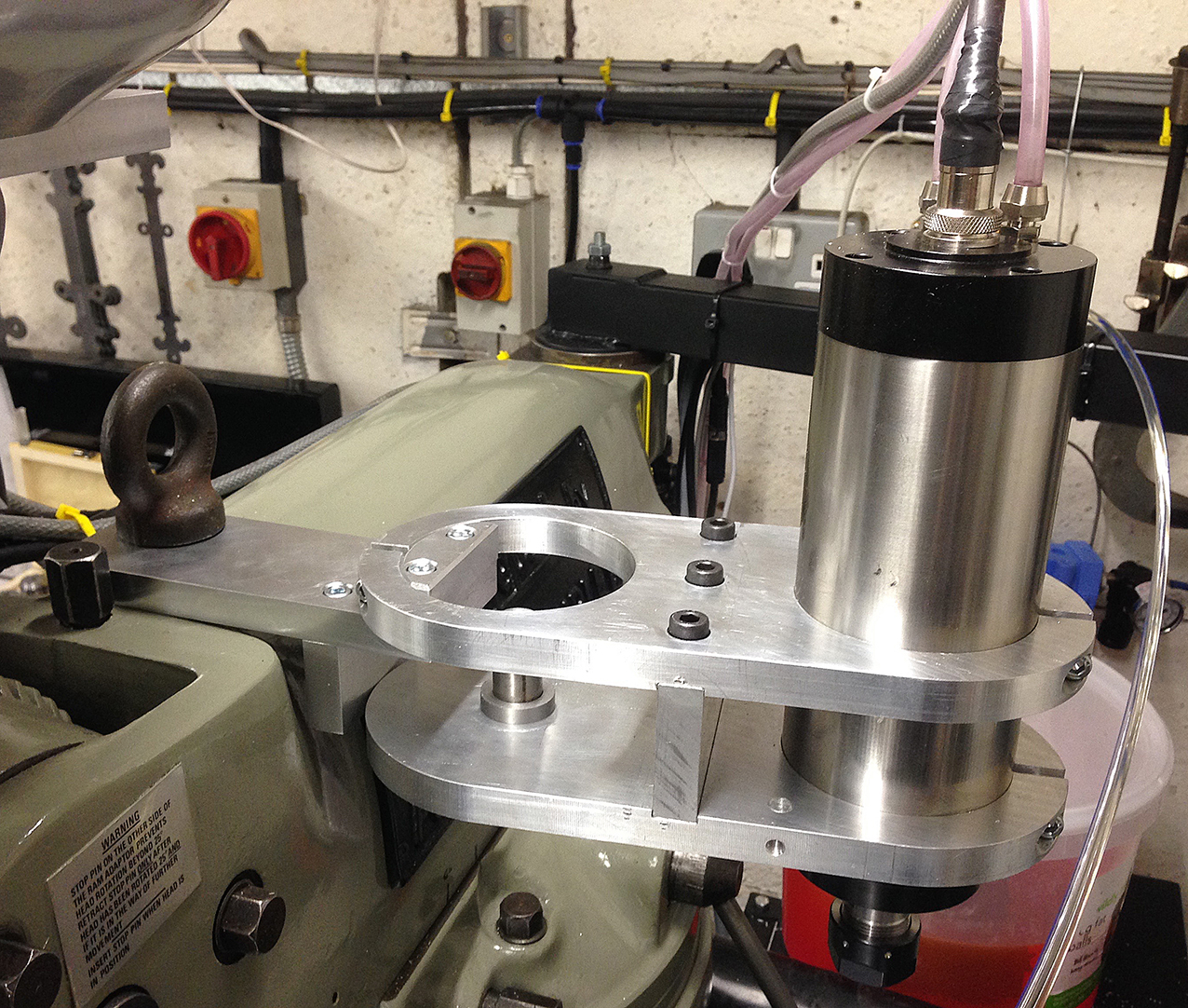

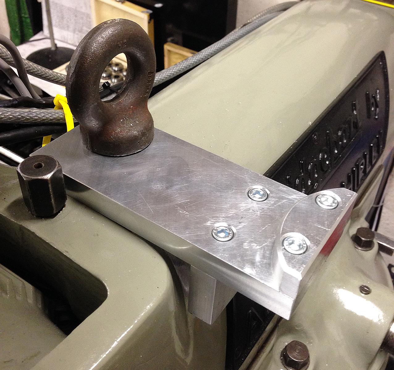

    Fun little Sunday morning project to aid my education in Fusion, CAM etc...
    Support bracket for the high speed spindle when not in use :)
    Junk bits of 15mm ally plate, rigid tapping, chamfers the works ;)

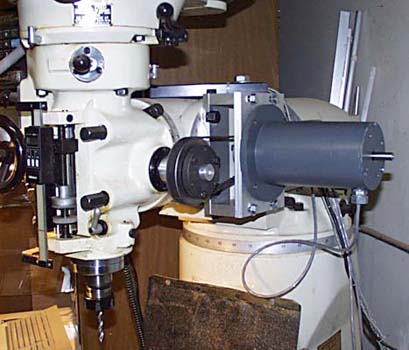

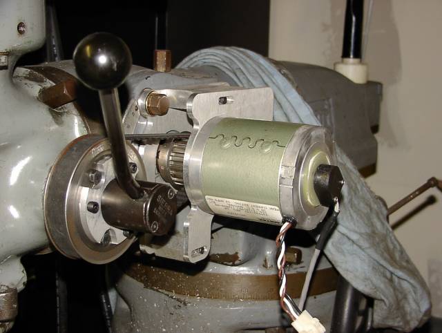

    Future thoughts...
    Machine is working very nicely so far. However I still have big doubts about the weakest link in the system - the Z-axis drive, its a pretty tortured setup, the connection to the quill is poor being just one bolt, the block face is only around 15-20mm square where it bolts on, there is around 75mm from the quill to the ball-screw so there is a massive twisting moment acting on the joint and the ball-nut.
    There is already movement visible between the nut and the quill - you can see the connecting arm twisting when nudging the ball-screw pulley by hand so it would be pretty rough under drilling or plunge-milling forces. I can see a very short life for the ball-nut as they don't like twisting moments, axial or radial but not twisting.
    It was assembled with loctite but with only the one bolt I doubt that would do much.
    I have a feeling it would have been better to go with the drive idea in the pictures below, the quill rack is designed to take all the Bridgeport can do, there is not much backlash and what there is could be helped with a gas-spring maybe to keep it under positive pressure.
    No idea what the pinion gearing ratio is but likely something like 3" per turn so would use a bigger reduction from motor.
    Just looking ahead, but as i said, I can see issues here already and thats only after a few jobs....
