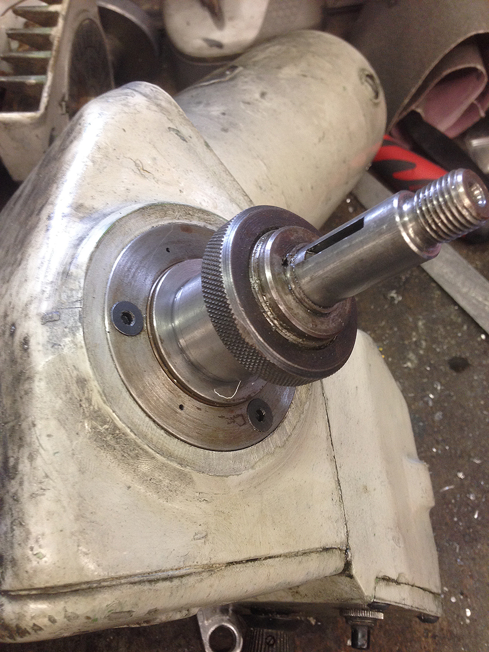

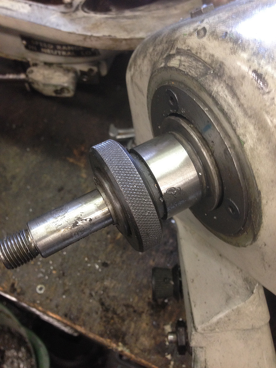

    Should these collars just slide off, it feels like they are hitting a hard stop?

  8. #67
    Just a thought, have you tried tapping them round had similar collars in a different setting but they were threaded.
  9. #68
    No, one of them slides about 3mm and then stops, the other is stuck fast

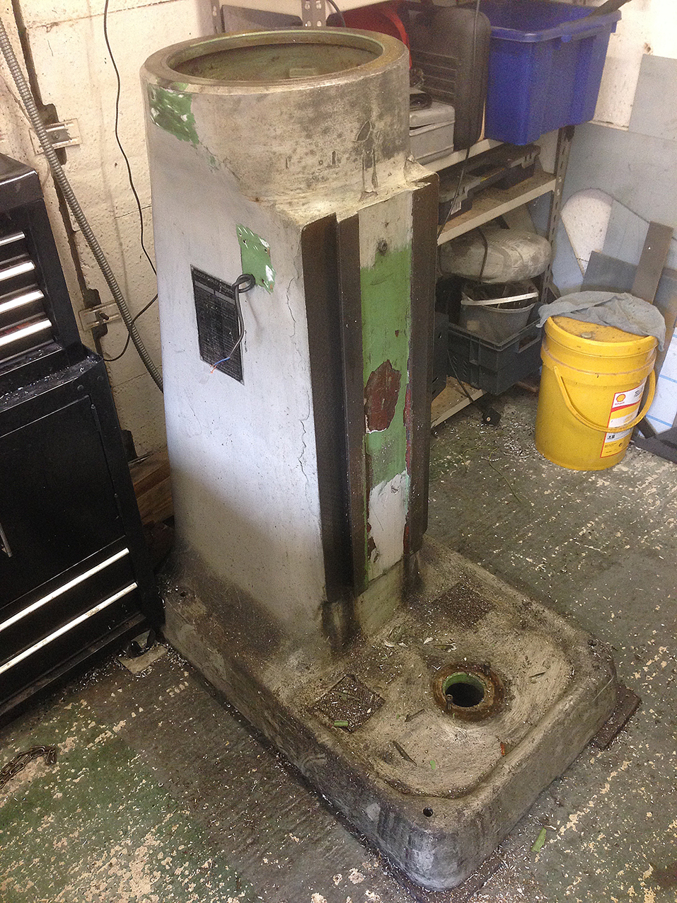

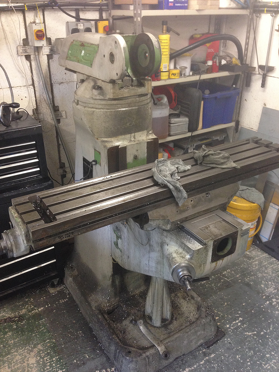

    Can't go much further ;)
    Stripped most of the poor paint job off now, will be sanding and painting this weekend, not filling the dents in as it's a machine not decoration ;)
