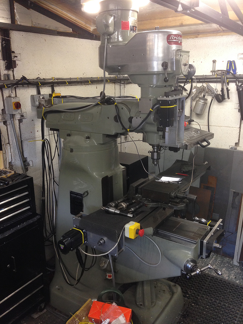

    Got the panel wired to the machine today, most of the big jobs done now, its running again, ready for testing.
    Small jobs to do like secure some of the cables when i work out where they need to be, make the belt covers, cover the Z axis drive, fit the light, then figure out how to run her ;)
