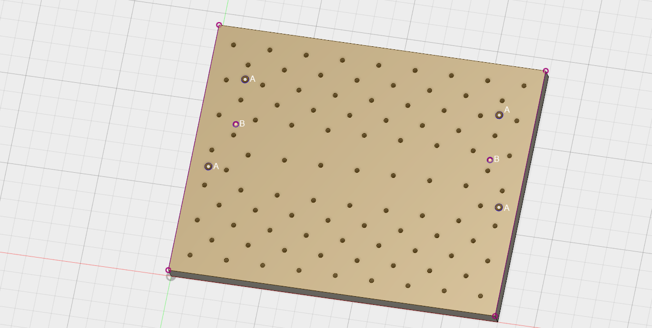

    Sub-table for the engraving spindle...
    Holes A are for M10 or M12 CSK socket-head screws to bolt into the Bridgeport T-Slots, holes B are two locating dowels on the rear face to sit in the middle slot on the main table, keep it all square etc :)
    25mm eco-cast tooling plate.
  2. #222
    Dave, once setup drop a couple of shallow keyways in the plate both vertically and horizontally so you can drop a piece of key steel in to act as back and / or side stops to get parts square
    John S -

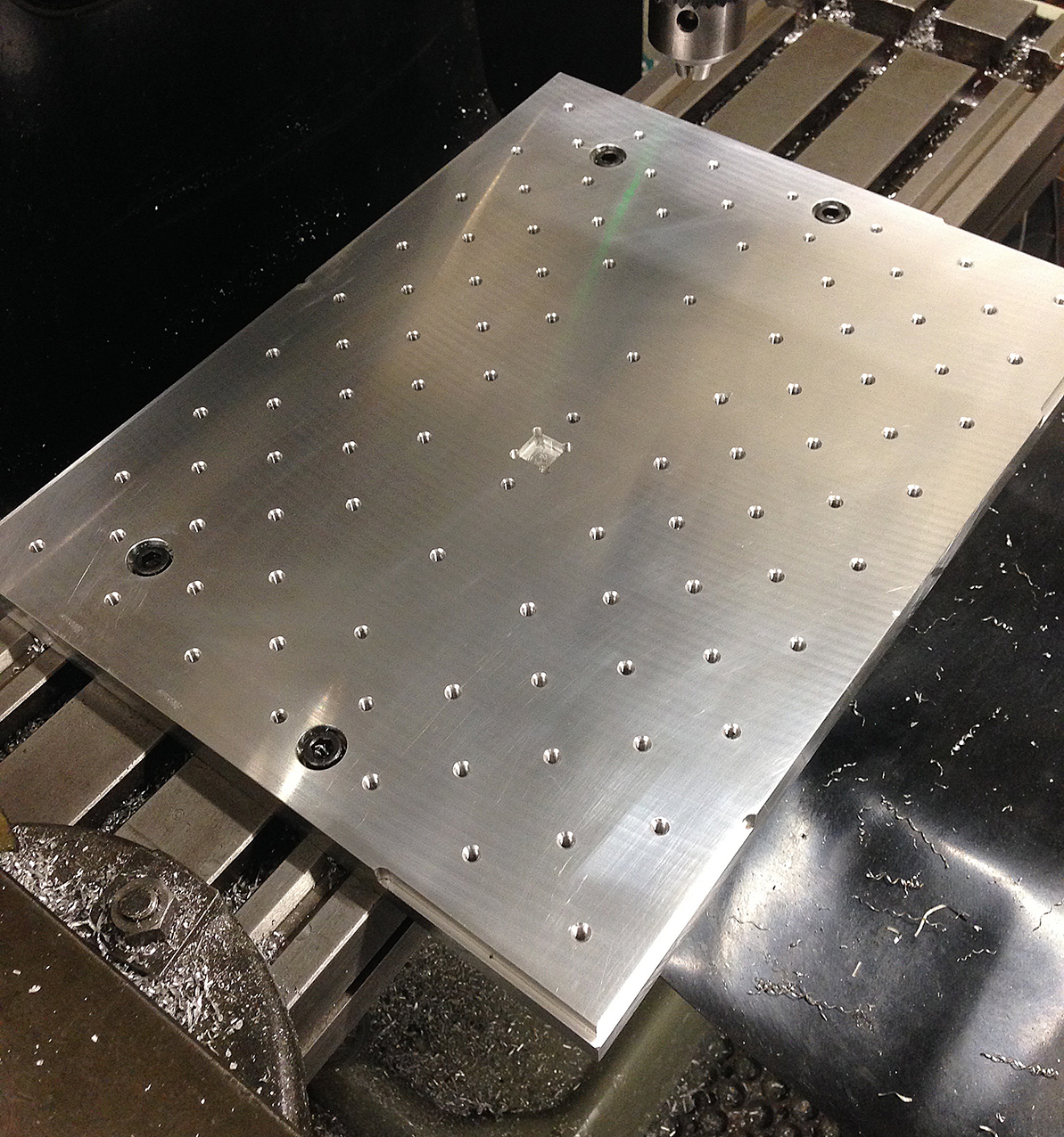

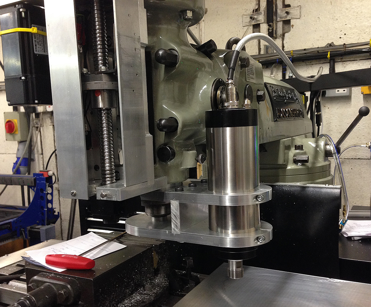

    Sub-table is coming along nicely, can just be seen in the bottom of the picture, just the matrix holes to drill & tap now...
    The new spindle motor fitted my adaptor perfectly, got the VFD dialled in nicely, just the water cooling to sort out.
  5. #224
    Job done, turned out very nice.
    100 holes, spotted, drilled, countersunk, blind-tapped M6
    Surface was parallel to within 0.03mm max so i'm not going to bother running a facing cut.
