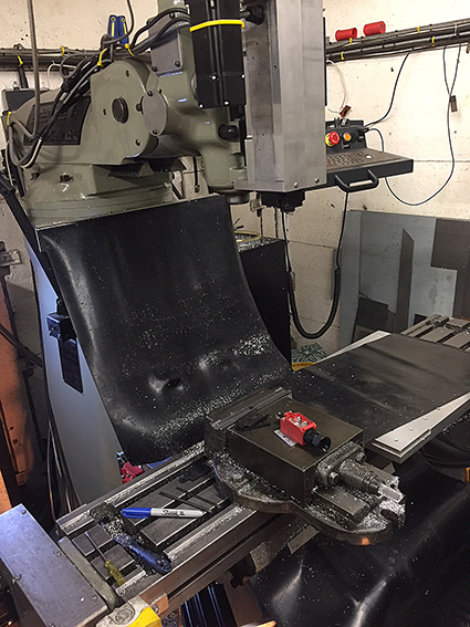

    Started modifying my conversion - I am powering the knee with a servo so i can send it tool length offsets, this will give me full Z travel with any length tool, hopefully.
    Got the motor mount fitted today, hopefully get the limits and home switch fitted tomorrow:)

  2. #302
    Got the limits and home switch fitted today, moving switches and fixed cams so I could do it all with two switches :)
    Top switch is limit and bottom is home.
    had to alter my plan of homing to top as with the vise fitted the bed will crash...
    All the way down, a lot of cranking....
    Wired the limit switch into the loop, just the home to take back to cabinet...
