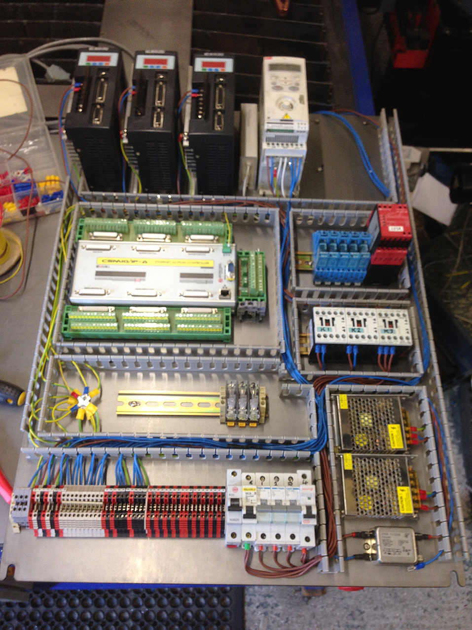

    Started panel wiring today, one of my favourite parts of a build :)
    Got the grounds and most of the neutrals in, plus the motor supply from the VFD to the terminal bar.
    The space at top-right is for the high-speed spindle VFD - can't fit that yet as its still on the mini-mill.
  6. #166
    You are not putting the output from the VFD onto 3 separate switches are you ?
    If one trips you will fry the VFD.
    VFD has to go to motor with no breaks.
    John S -
  7. #167
    No, no, no ;)
    The output from the vfd goes direct to the terminal bar and then to the motor.
    The three contactors are:- VFD 1 supply, VFD 2 supply and Servo's supply.
    The VFD's are for main motor spindle and aux high-speed spindle, only one will run at any time.
    I think having a terminal bar in between motor and VFD is acceptable.
  8. #168
