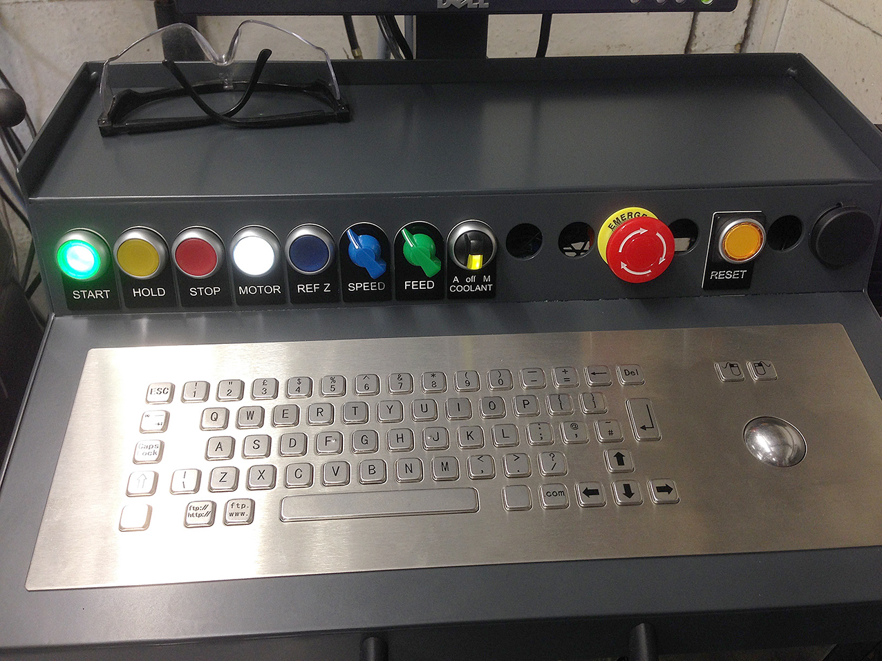

  4. #193
    Got the panel finished, just need to find a few blanking plugs
  5. #194
    Ah ah just bought 2 of those KB of flee bay.
