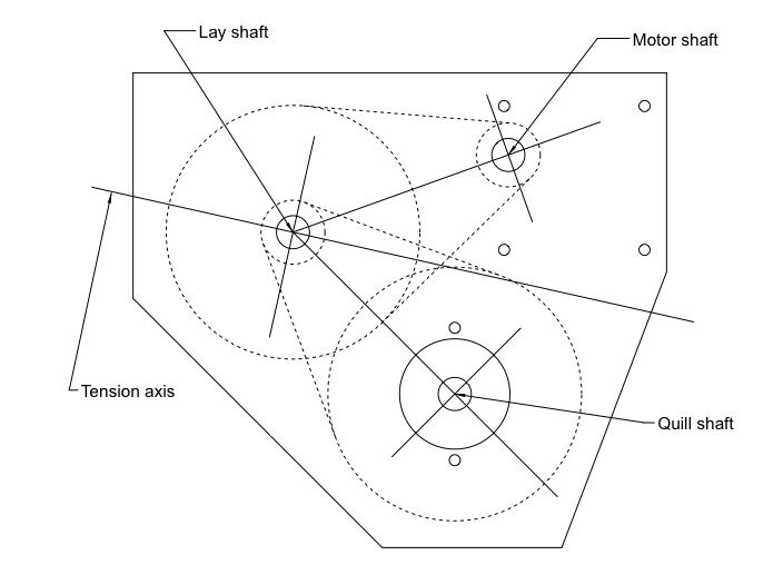

This seems a pretty neat way of backlash control - its a brake cable from a motorbike, one end is mounted to quill and the other has an air cylinder on it with variable pressure. The guy that fitted it also fitted a very tidy gear reduction system in the aluminium casing on the left, 15:1 ratio, double reduction. He reports zero backlash and full quill travel :)
I think on cost alone, it has to be worth a try to run via the quill rack, powering the knee at any speed is going to take some time to save up for.

Alter what i have got - looking at the picture below, is there any harm in removing the web of metal circled?? It would mean i can get a bigger connecting arm in there with much more contact below the bolt to resist the down-forces, without losing any Z travel.
29-10-2016 #275
After some thought I reckon the easiest option based on what i have going already is to modify the quill housing and build a better connector arm - this should give more rigidity and still maintain the full Z travel.
In the attached picture, on the left is the existing setup, on the right is my next version - as you can see, in the existing one a lot of twisting moment is placed on the bolt when the arm is pushed down (heavy lines).
In the new version, the twist is converted to an axial pull on the bolt and the force transferred to the quill body via the longer contact face below.
