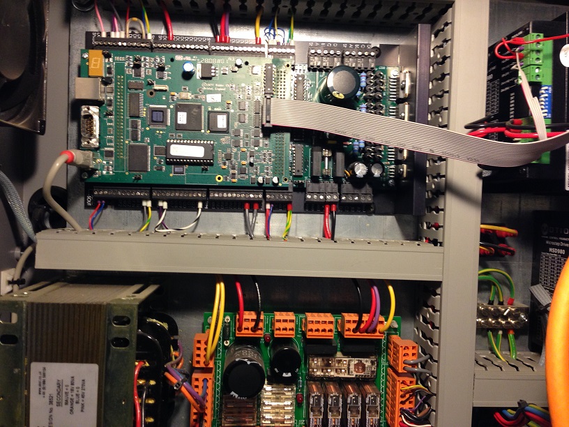

    fyi, here is the inside of the VMC 1300 Pro

    That's quite a bit different!

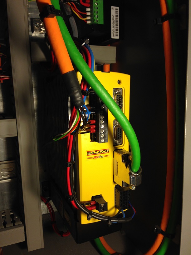

    They're not using the onboard stepper drivers, so there's not really any point in keeping any of the existing motion controller boards. You just need to find a manual for the three stepper drivers that are fitted.
    The biggest thing you'll need to work out is the wiring for the relay board in the centre.
    Is the existing controller using USB? If so, does it still work, or do you not have the required software?

    The steppers are MSD980 Microstepping Drive http://www.motioncontrolproducts.com...ing-driver.pdf

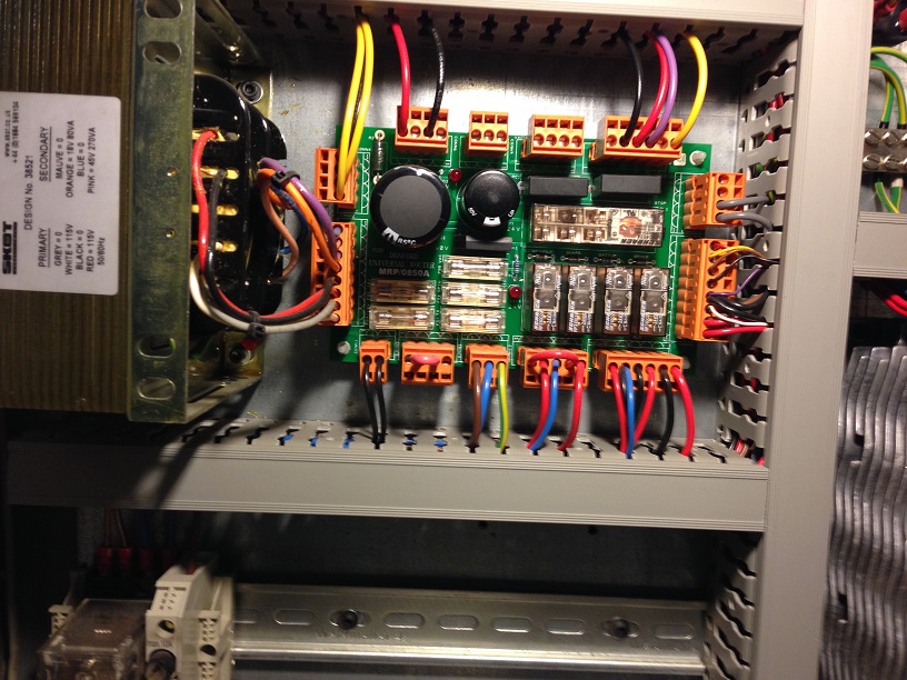

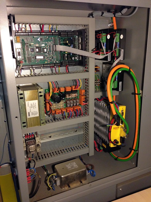

    The cabinet is nice and open so it's easy to see where each wire runs. A few other pics...

    Looks like that middle board also handles the stepper power supply, going by the transformer connections and capacitors. Have you found a wiring diagram for the machine, as it'll make working out exactly what that board does, and what signals it needs to work, far easier. If there's not already one over on the Denford forums, try asking as they're usually pretty helpful.
    Is it running VR Milling 2 or 5?
    If it was 5, I'd personally leave it until such time you have a reason to change. It may appear a bit 'simplistic' but it just works, and accepts standard G-code like most other controllers.
  7. #17
    There's a link in my post #4 to the denfordata forum with the schematic
    I'm running VR Milling 5 and I'm not rushing to change - it's a project for me, so I can move at the pace I learn about the controllers and connections
  8. #18
    Helpful people at Denford confirm schematic Rev C on forum is for my model of VMC 1300 - I was impressed with them
