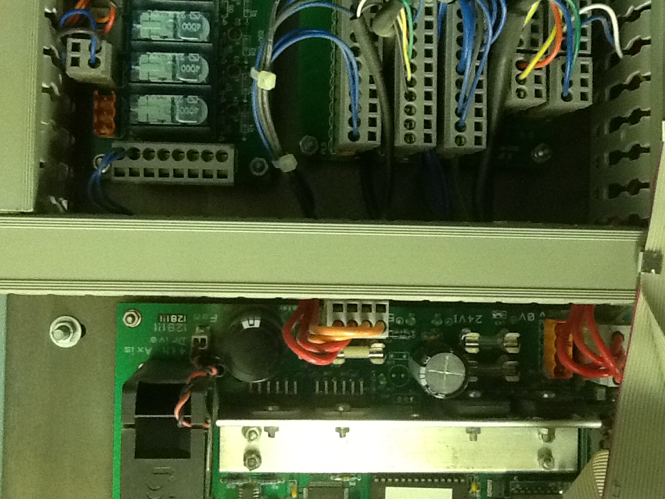

    Sound advice, been into it today, 8 wires in the socket
    2 red singles 2 orange singles.
    1 multicore red blue green yellow.
    traced back to 2 boardsClick image for larger version.
ID:	18516Click image for larger version.
    Ok up til there . . . . I can meter out one of the other steppers to work out the wiring, but I haven't a clue what the red and orange ones do - they are a bigger section (18swg) than the multicores. Could they be for power ? Galloping ahead, I have never seen one of the Boxford 4th axis' in the flesh, does anyone know if they are direct drive or reduction ?
