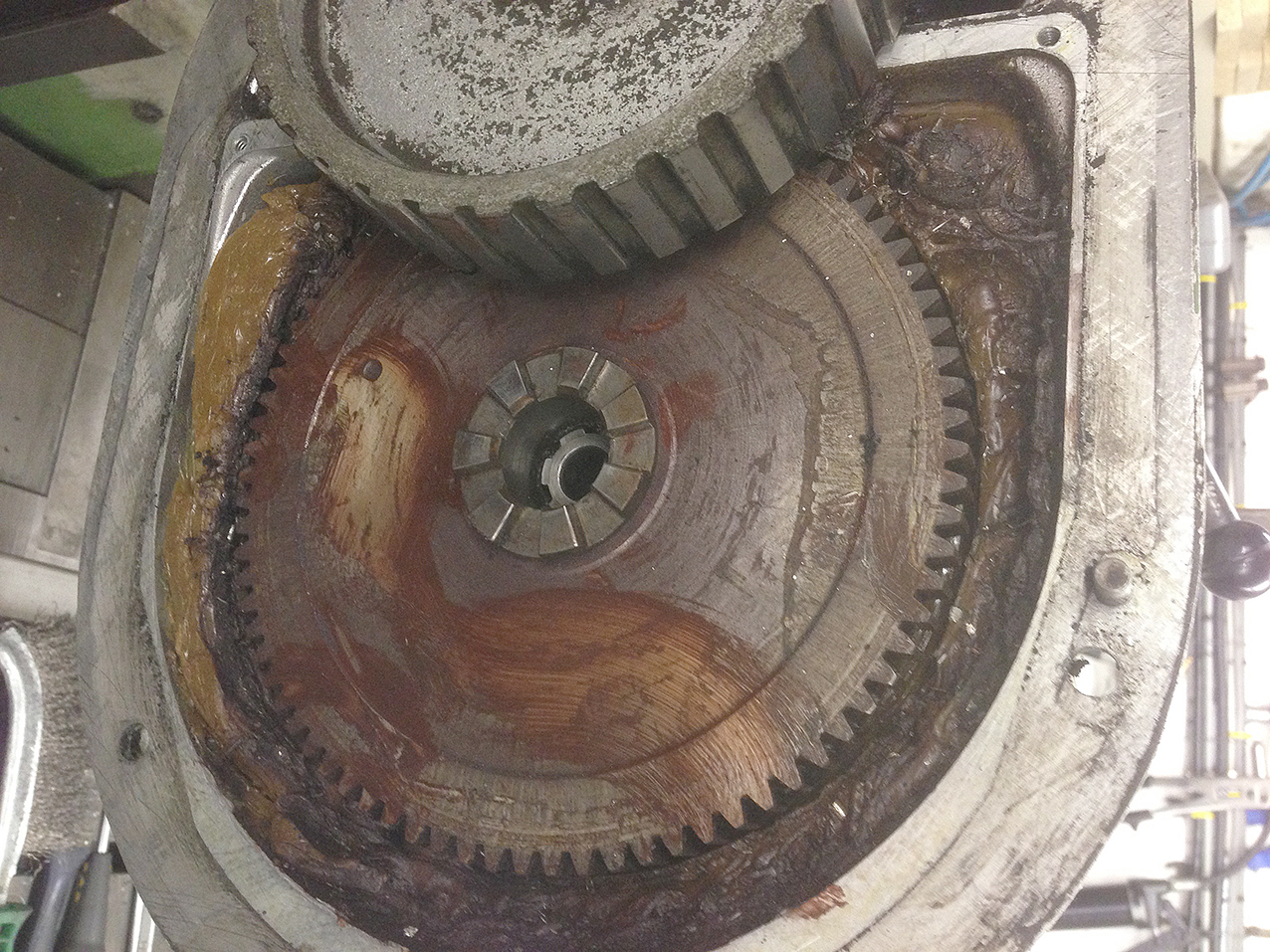

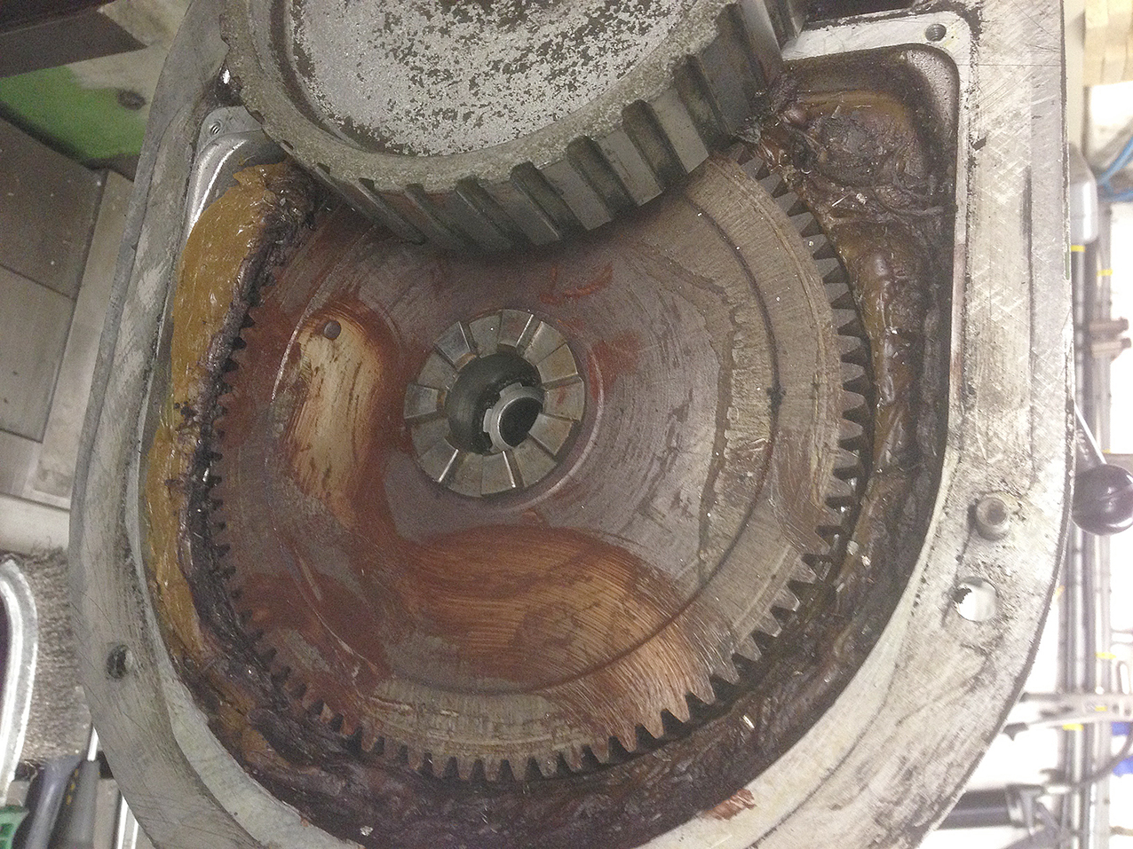

    I need to pull this gear to get the crud out from behind - any suggestions??
