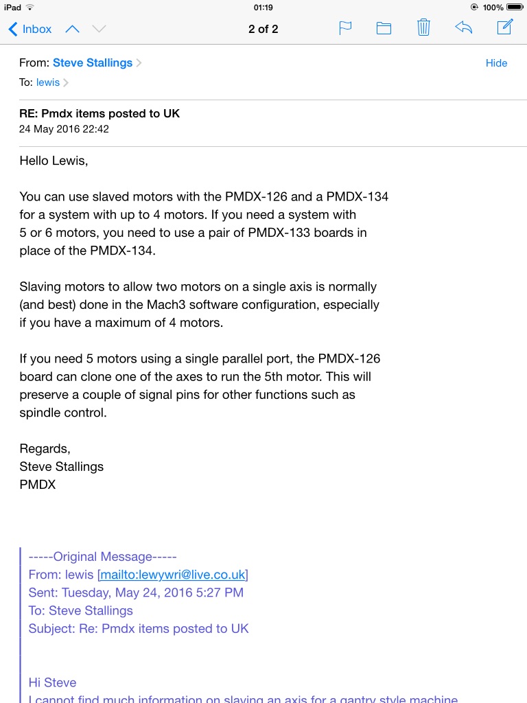

    the pmdx 126 can only be slaved if used with pmdx 134 I think

    Well you are using Gecko drives so why not take their figures? I take it you are using nema 23's motors, It will run fine with 62V but you will get better performance with a little extra.
    I don't see in the manual re the 134 slaving it just looks like a breakout board for the gecko.
    An axis can be cloned but the direction of the clone is the opposite directionso phases need switching Click image for larger version.

    Ok if you are happy BUT can you home them individually to square the gantry!!!
    Asked pmdx direct And got Instant replies as I wasn't 100% on slaving and squaring
