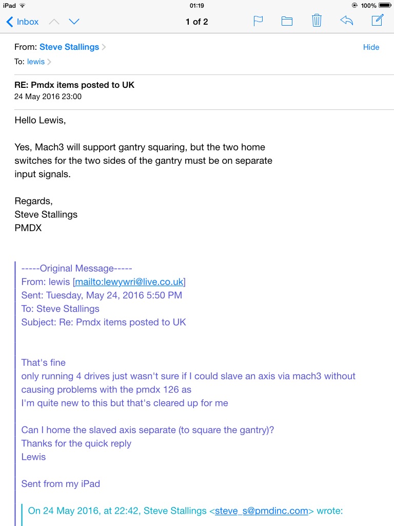

    Quote Originally Posted by Lewywri89 View Post
    An axis can be cloned but the direction of the clone is the opposite directionso phases need switching Click image for larger version.
    Ok if you are happy BUT can you home them individually to square the gantry!!!
    Asked pmdx direct And got Instant replies as I wasn't 100% on slaving and squaring
