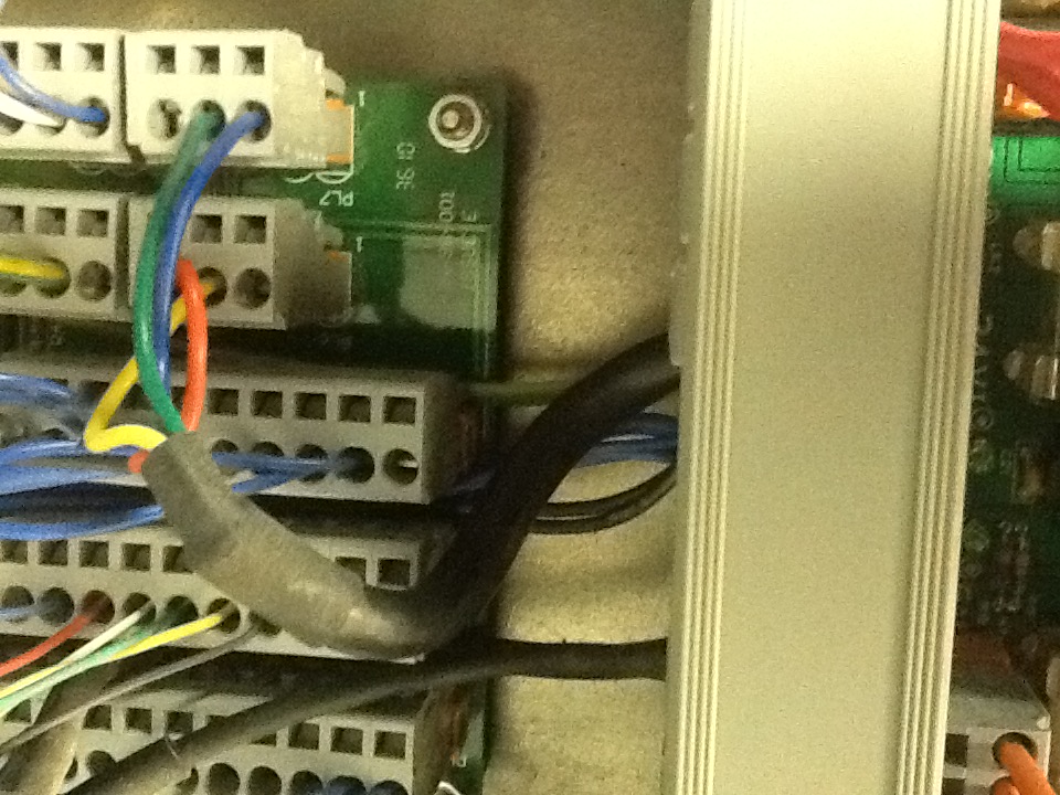

    I am looking for assistance with wiring for a 4th axis on a Boxford router, I made one and run it off a divisionmaster which has 4 wires - looked into the Boxford socket - 8 (mostly red) wires !
    tried to glean some info from Boxford . . . . . .
    Apparrently I will blow the board if I get it wrong (2k) or its 2.5k for a unit from them !
    any help or direction would be greatly appreciated

    Do you have a multi-meter? If so you can disconnect another stepper and meter out the wiring to find out which pins go to which motor wires.

    As a first step, I'd be tracing the wires to see where they go inside the control box.
    I'd guess only 4 of the wires are for the stepper, with the others being inputs for sensors/switches, and/or outputs for controlling locks/actuators.
    Hopefully by tracing where the wires go, you'll be able to work out what they do.
    I'd guess only 4 of the wires are for the stepper.
    Steppers come in 4, 6 and 8 wire flavours, not just 4, it is possible to connect a 4-wire driver to 6 and 8 wire steppers by externally connecting the circuits to a 4-wire configuration, but if you have a 6 or 8 wire driver you cannot use a 4 wire stepper
    Lives in East Lothian, United Kingdom. Last Activity: 4 Days Ago Forum Superstar, has done so much to help others, they deserve a medal. Has a total post count of 2,994. Received thanks 376 times, giving thanks to others 9 times.
    Which is why I said to physically trace the wires inside the control box. The stepper driver wires should all connect in the same area, possibly to an individual driver, which means you know exactly what wires power the stepper motor.
    Then it just leaves the other individual wires, which by tracing, will hopefully connect to a terminal with some form of name to work out what they do.
    I would very much doubt that all 8 wires are solely for powering a stepper motor, given Boxford typically only use 4 wire drivers.

    Sound advice, been into it today, 8 wires in the socket
    2 red singles 2 orange singles.
    1 multicore red blue green yellow.
    traced back to 2 boardsClick image for larger version.
ID:	18516Click image for larger version.
    Ok up til there . . . . I can meter out one of the other steppers to work out the wiring, but I haven't a clue what the red and orange ones do - they are a bigger section (18swg) than the multicores. Could they be for power ? Galloping ahead, I have never seen one of the Boxford 4th axis' in the flesh, does anyone know if they are direct drive or reduction ?
