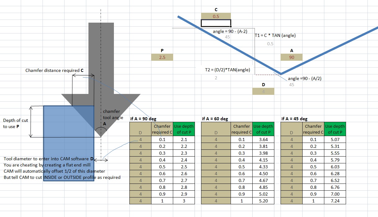

    Hi Dave,
    Just knocked this together to help work it out.
    You can use one of the 3 look up tables depending on if the chamfer tool is 90, 60, or 45 deg.
    Then assuming you use a notional tool diameter of 4mm as suggested above by needleworks in the CAM tool definition, then you just need to look up the required chamfer distance you require (C) and read off the depth of cut required (P) and enter this value into the CAM software.
    I've not tried this out but I think it is OK. Please check on a scrap piece first (!).
    Any errors spotted by anyone let me know . . .

    Hi Dave,
    Yes, that explains it a lot clearer mate I should also have said that I use cambam for my toolpaths (not mach3 as I said in my previous post) like many, I just can`t get to grips with fusion 360 cause it always seems to mess up somewhere.

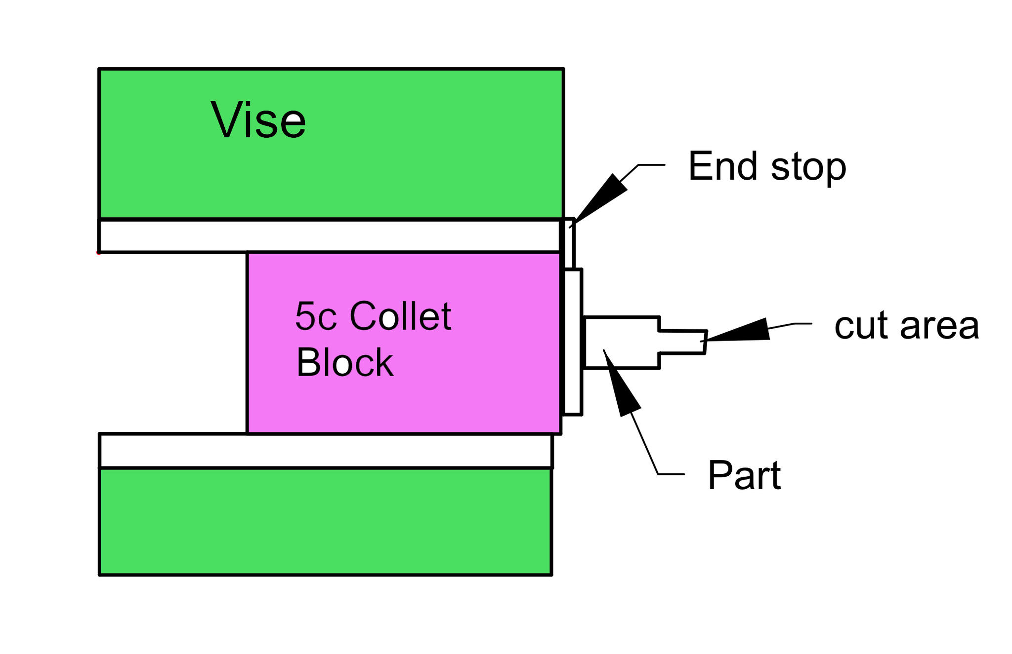

    Looking for suggestions on how to do the CAM for a part i make batches of manually at present, it's a round shaft with a square peg on the end. I have the vise mounted usually in one place for long periods so a G5x offset seems good, I can ref off the fixed jaw front and end.
    It's not shown in my sketch but the radius of the tool is used to create a radius at the point where the square peg meets the body - just run the tool in from the end.
    The part is held in a square 5C collet block at a fixed depth, the vice is fitted with an end-stop so pretty much all settings are repeatable and fixed.
    I am looking to machine two sides and the end, rotate the block 90deg and re-run.
    Just looking for ideas :)

    In all honesty, I wouldn't bother with CAM.
    I'd probably hand code using work offsets. Use a reference point (i.e. touch of end of material, then touch of the side) to zero the work piece coordinates, then hand code based of that.
    At most I'd use the Mach wizards to generate the code for each side, if multiple passes on each side is needed.
  8. #17
    Hmm, thats a leap forward, not hand-coded anything yet ;)
    Once the refs are made - end for X and centre of rod for Y, i can see saving them as offsets - they will not change unless the vise is moved which does not happen too often. So i just need to figure the path out i guess.
    The manual ones i cut in one pass, its a little heavy on the tool but works ok, with automation i would likely use two passes as the steel is harder than plain mild.
  9. #18
    Why not do them vertically then you wouldn't have to move them.
    If you want the radius use a round nose cutter.
    Peter
  10. #19
    Thats an interesting thought, thanks.
    Cutting forces would be harder to resist but not impossible, I have a 5C collet holder with vertical/horizontal bolt-down base, could use that if it grips well enough.
    Will need to test this when i get her running :)
