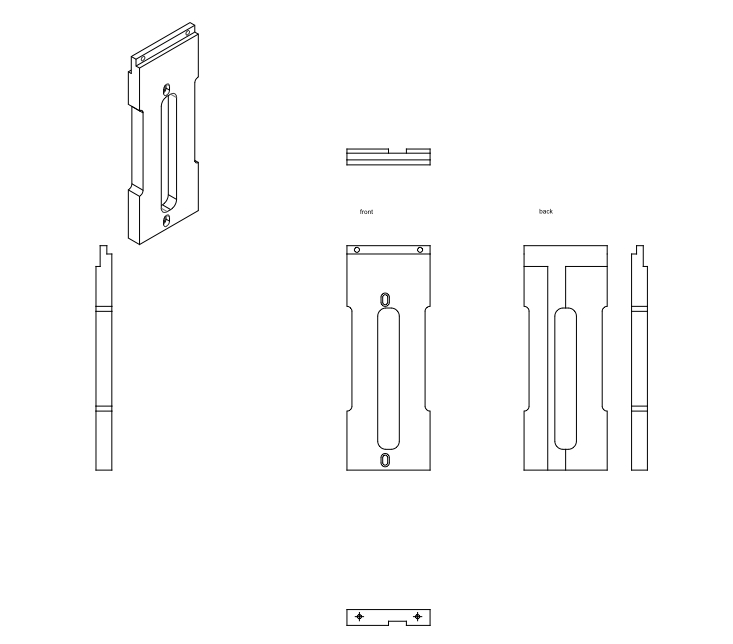

    I am now converting my Bridgeport to CNC to expand my possibilities, all 3 axes will be controlled.
    I need to make some parts for the Z axis drive and these can be done on my mini-mill which is handy as the Bridgeport is in 1000 pieces at present ;)
    However, with my limited 2D knowledge so far, it was not until started modifying the drawings which were kindly sent to me by a previous converter that i realised how little I know about making the file for a 3D part

    The picture shows various views of it, it has features on front and back, holes, a large slot etc.
    I know pocketing, contouring etc but what is the missing link here?
    My guess was to machine all the front details, holes and the outside first from a larger lump of plate, this would give me a part with the edges to size and one side finished.
    Then, flip over, pick up my X & Y datum from whatever corner I use, and machine the back face - this is where I hit the knowledge gap - do I remove the outline (it's finished) and convert the features needed (a T-shaped slot) into full outlines on their own or something else??
    I have never seen any other CAD source and my 2D stuff seems very simple compared so???
    I am as new as you at this but in fusion I would create front as required and then copy that whole object flip 180 deg and add back detail to second copy.
    Then use blocks fixed on bed to ensure accurate placement when flipping before starting to machine the reverse after contour cut before removing piece adding blocks for placement.
    2 single 2d operations on one part if that makes sense.
    Yes, but the paths for the reverse - do these have to be just the T-shape pocket required
    i.e. the front would be the whole object and the back would look just like a large T shape with no outline at all?
    Yes only cut the slot and contour once then flip to machine only what could not be machined from front, so back would just be a T shaped pocket to required depth. I would start from same corner point on second setup but on other side of material obviously. Although placement may be easier to cut slot and T Pocket and holes first and then flip to cut remaining front using holes and pockets to fix back down.

    The slot is pretty wide so i would position the material to place the eventual slot over a run of bed holes, machine the slot plus the two small ovals, then fit clamps into the slot and finish the rest of the front.
    As you said, then place blocks on bed touching the finished edge, flip over, clamp around the edge and machine the pocket T.
    Seems to make sense now, will finish the drawings and do a simulation or two :)
