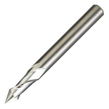

While we are here. Just in tune with your calculations /that i will have to save somewhere/ - i needed a couple of times to calculate a V cutter flute length /FL/. Reason was i have V cutters that cut deeper than their flutes, a mix between V cutter and spiral flute mill, where the flute ends at shank width. Wow, it took me some time to figure how to calc these so i could draw them properly in program. Properly means exactly without any errors.
I read here how to calculate the flute length
Link,
the formula for sides of Isosceles Triangle, so i came up with FL=((shank diam - tip diameter)/2)/cos((180-vertex angle)/2)
