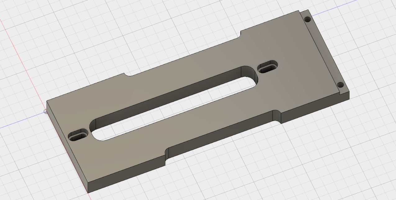

    Hmm, watched a couple of vids on the 'tube, played about a bit and managed to recreate the back plate for the Z-Axis drive on my bridgeport conversion project, previously made via 2d cad.
Name:	Z axis vertical v6.png
    With a couple of years practice, i might just get the hang of F360 after all ;)
    This took me about 2 hours.
