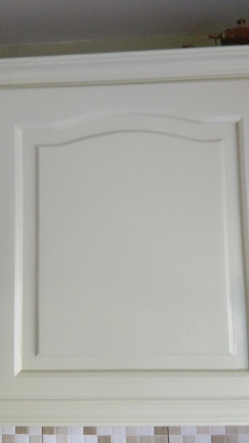

    i'm also looking for a little help in can anyone identify this router style in this image. I have to make an off standard door W595 x H500 in MDF and would like to be able to replicate the design. From edge to edge of the router cut is 48mm. The inner and outer cuts are not similar so probaly was done with two or more cutters. Anyway all help and suggestions would be more than grateful. Click image for larger version.

    The photograph is not very crisp but as far as I can see, the corners of the outer (frame) moulding are very sharp. This does not look as if it was cut as a single panel as you cannot machine sharp internal corners like this with a router. You can see this in cheap doors made from a single MDF panel - the internal corners are rounded. The frame was probably made from four components and the moulding machined before assembly. I would guess that you could probably match the moulding shape with a commercially-available router bit but it's a matter of ploughing through cutter catalogues to find a matching profile. More likely, the mouldings were cut on a spindle moulder which gives you access to many more moulding profiles, but we're moving away from the CNC area now!

    I agree would be far too much material to cut away on production runs so probably spindle moulded and applied, may have to just get the angles and use two or more cutters.
