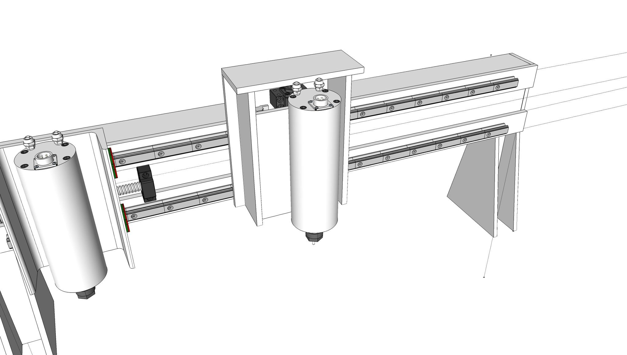

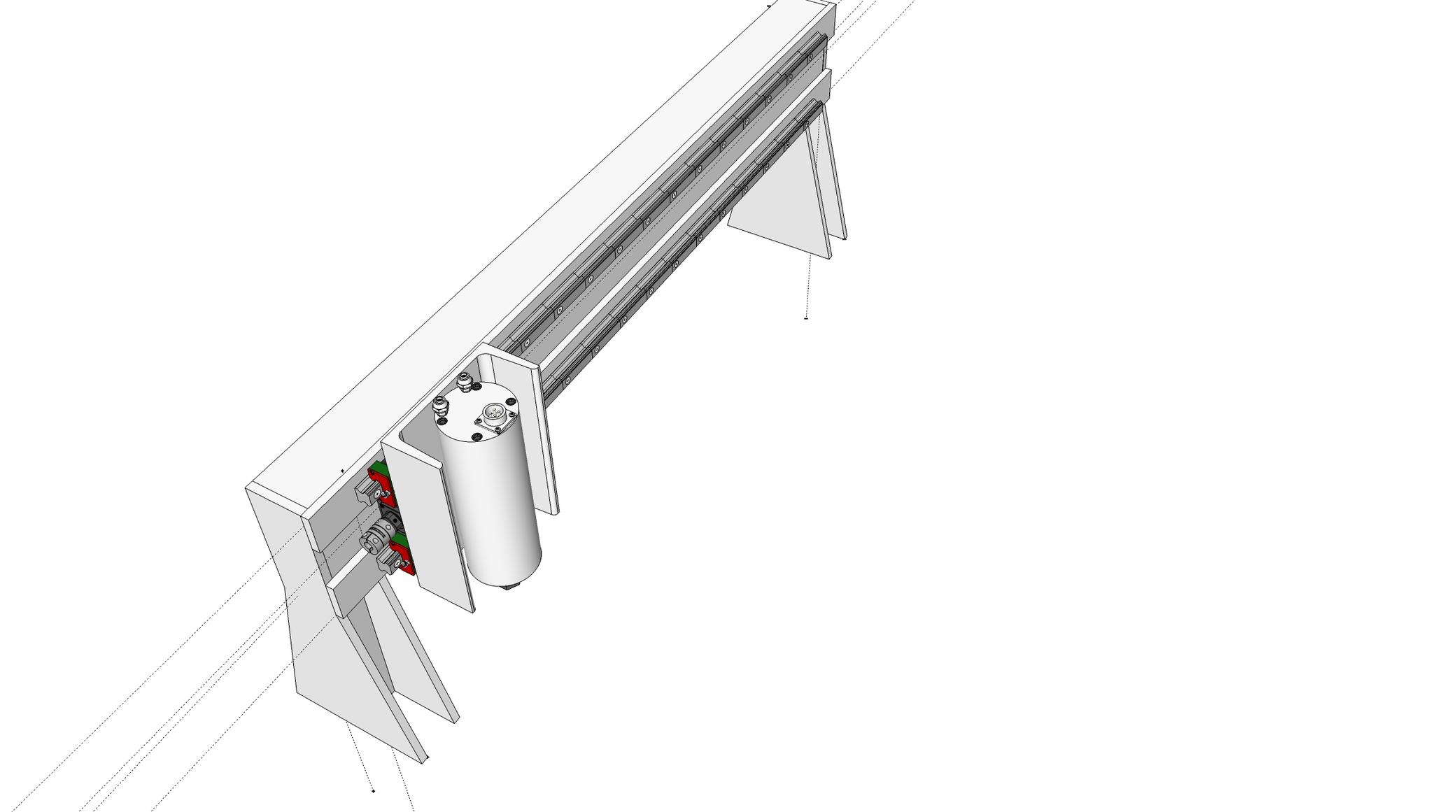

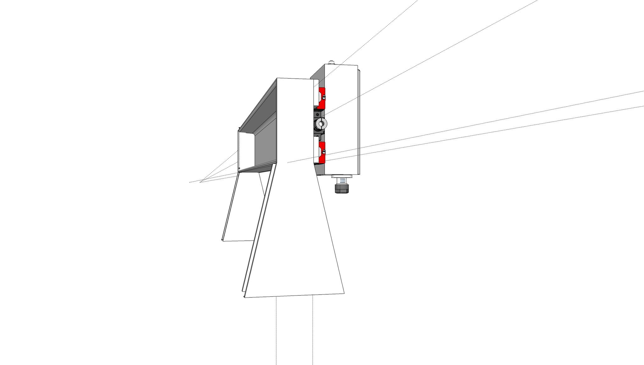

    Well my first idea was something like this for Y fixed gantry...

    i can reinforce the tower welding a plate in diagonal and can reinforce the back of the UPN too welding it too.
    if close the structure can fill with sand or similar to get more weight.
    i dont want high Z Axis, think that 70-80mm travel will be enough.
    Its my old Z Axis idea, i want to avoid welding the parts and use an UPN as show in first image

    My first observation is that you have to be able to build it and assemble the parts have you thought how you would bolt the bearing blocks to the z plate (I think the blocks are to close together). This is why you should draw it out to see these problems.
