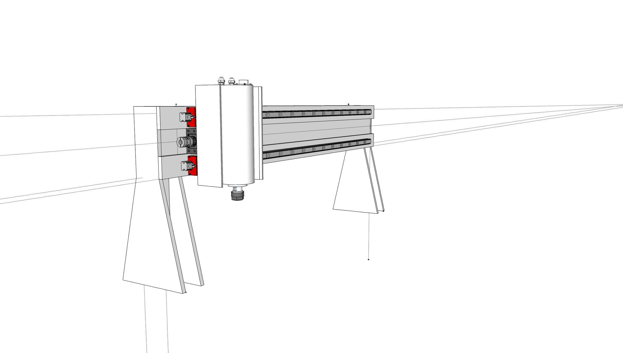

    updated Z Axis

    Can you see the red rail blocks how are you going to drill the mounting holes they appear to be in the edge of the steel
    Yes i understand you, i can move a 10mm to the center each rail and can drill it without problem. Z Axis UPN are 21cm width, so have some space to drill the holes.
