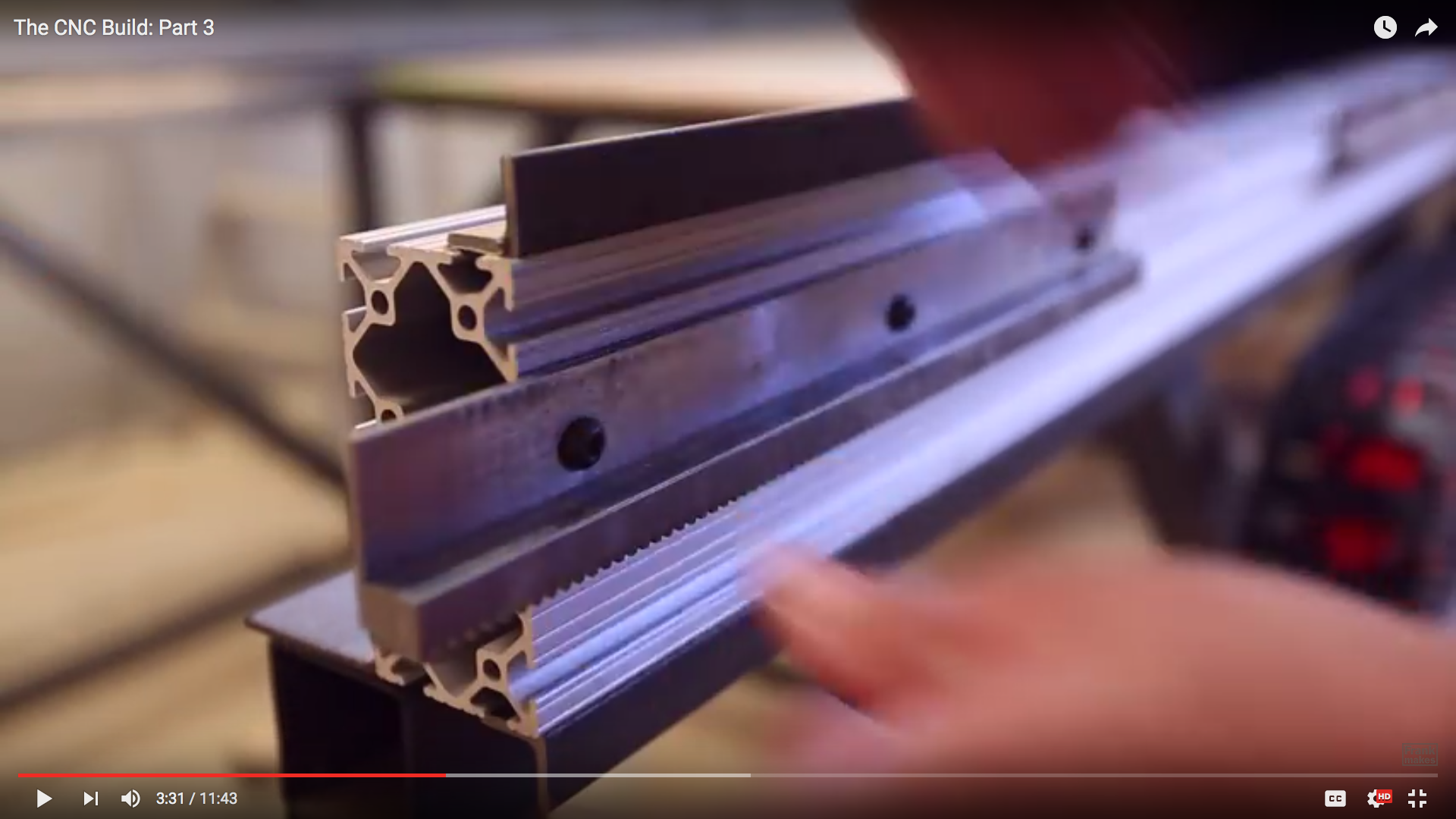

    To avoid contamination, mount the rack, with the teeth pointing down
    For a visual comparison:
    I'm planing a R&P router myself and would like to ask two things?? What do you mean by contamination? And, When you say mount the rack, do you mean something like this?
