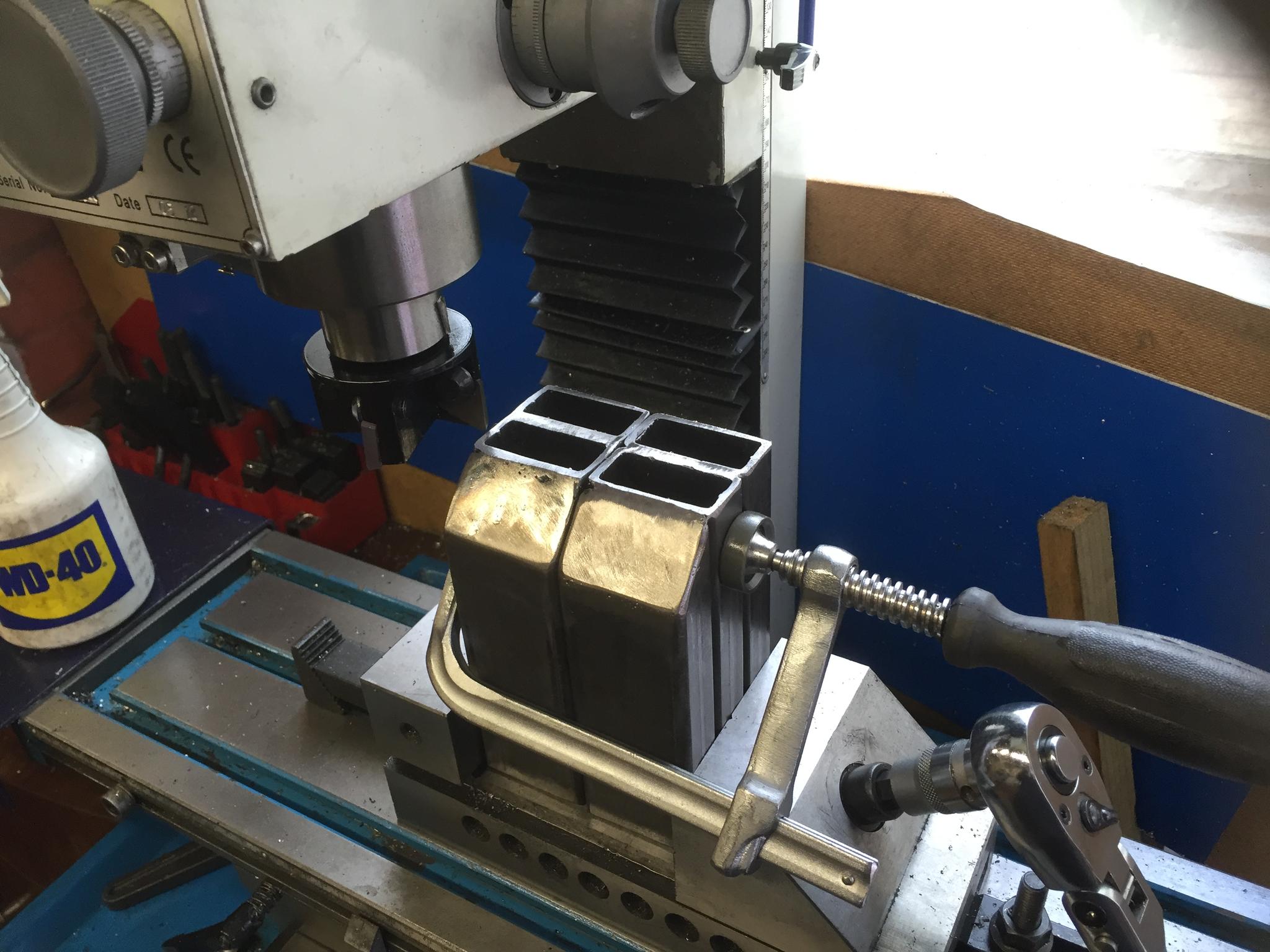

    Good job your using round rails because wouldn't get away with rough work like this if using Profiled linear rails.!!
    Tom is correct your level of accuracy will be low or will require lot of shimming and tweaking. How much will only come to light when finished and being used at which point you'll wished you'd took little more care when building.
  2. #22
    Quote Originally Posted by Slixxor View Post

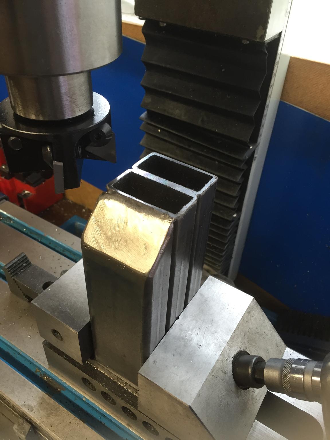

    Looking goid mate! Tack welds are the way to go. And lots of clamping. I would have got a piece of say 35x70mm box tube and clamped it in several places to the flat bar piece you were working on. Then going from the outsides in to the middle as your box frame will also slightly warp from the welds. Tack everything first then repeat the clamping process all over again with your filler welds.
    It's hard with long runs like that. Partly the reason bojan S uses C channel for his bed. Although I find welding much easier, drilling and bolting would have given a better result.
    Whats the link for your thread?
    Sent from my SM-G920I using Tapatalk
    Here is my latest build
    http://www.mycncuk.com/threads/9073-...-router-3-axis
    Small work area but was aiming for accuracy. Box 100x100 end up with ~0.07mm that is why i build again fixed gantry one, link:
    http://www.mycncuk.com/threads/10459...teel-frame-MK2
    Boyan is master in precision fallow him - he gets 0.02mm wich is more than my chinese mill

    My frame was not more than 1mm warp as I tack it everything and weld one bead at the time, cool down and opposite side and so on. I have to admit that I broke my rule and did not let to cool enough (firstly was warp corners down than after cool opposite) - £100+ waste on steel and gas, lesson learnt. I bit it with sledge hammer, driven by the car and finally filled down, so my 8mm bars became 4mm in places:)
    Now I use Tig just to see if I can do better
    Haha savage feedback. Thanks Jazzy, time will tell.

    I could blow smoke up your arse but still won't make it any better when cutting time arrives.
    I just like the way you assumed I needed to be more careful. What exactly gives you the impression I haven't been?
    Hence the reason I will see how it goes when it's done. I've endeavoured to make it as square as possible on all axes and feel comfortable that I've managed to achieve that within the best of my ability.
    I'll be sure to let you know if you're right or wrong once it's done and I tweak everything :)
