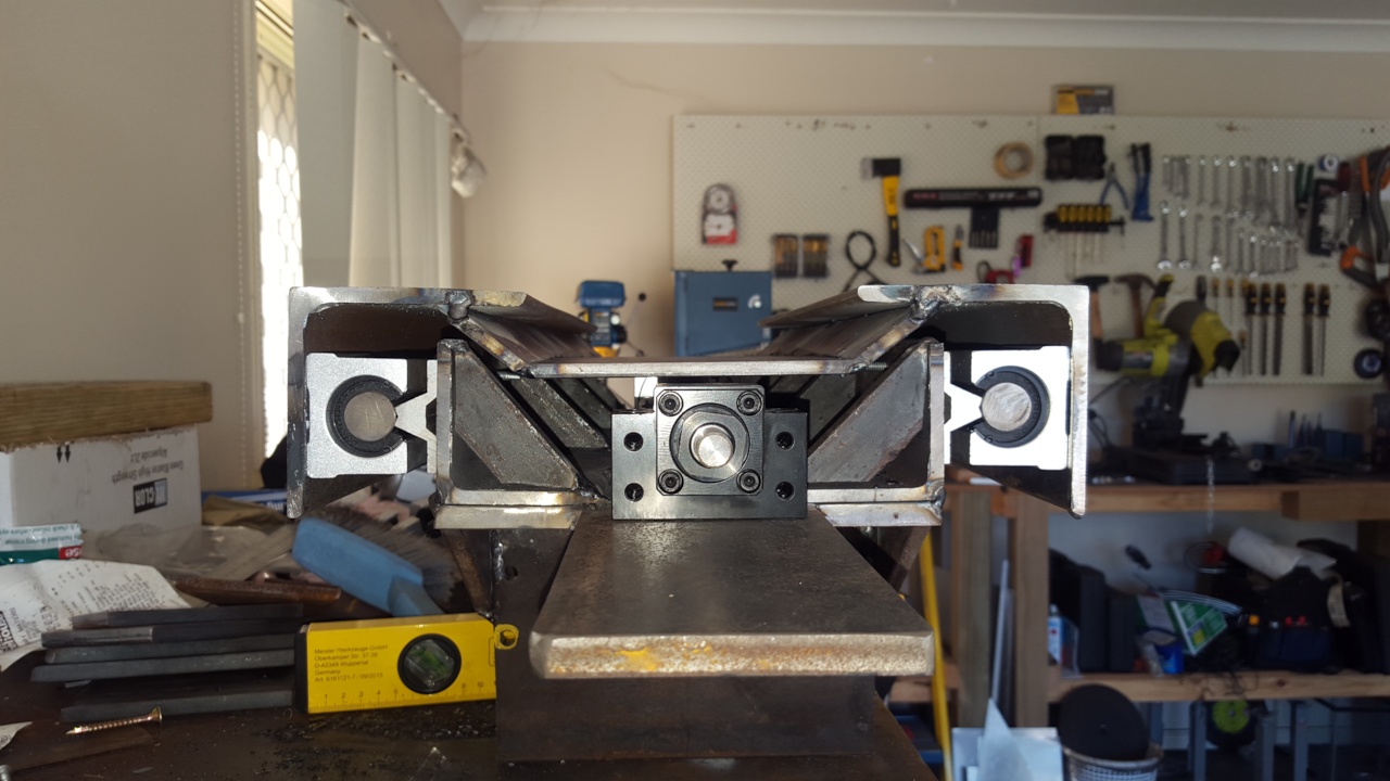

    Edit: Just to be anal and prove my point look at this picture and tell me whats wrong.?
    You are referring to me shaping it? I don't see the problem? what are you suggesting? (genuinely asking)

  8. #38
    In post #32 the Z bearings are trapped between the fixed distance between the angle iron sections. This means they cannot sit naturally, or have any pre-load control, and you can't adjust it either.
    I'm guessing you welded it together with the angle iron bolted to the bearings? If you release the bolts into the Z bearings do they slide out easily from under the Z axis (which is what you want), or does the Z axis 'spring away' or 'close up'? Ideally this should be a nice gentle fit onto the bearings , or possibly have a slight bit of pre-load.
  9. #39
    When welded they werent bolted on. Just the outer frame clamped onto both sides with pressure applied. When loosened there is slight rubbing on the bearing blocks but minimal force is required to remove them. If on an angle they scrape and fall straight out. The bearing holes were drilled afterwards with bearing blocks on the rails with no tension. The rear of the bearings were coated with steel blue and the top casing was slid over the bearing blocks creating the guide for my bearing block drilling die I'd made.
    Sent from my SM-G920I using Tapatalk

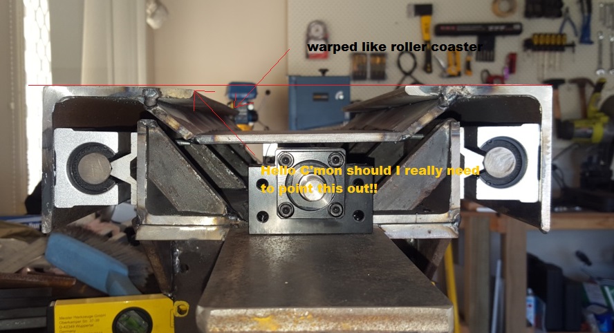

  10. #40
    Quote Originally Posted by Slixxor View Post
    You sir have a much better personality. I think JAZZCNC needs a holiday by the sounds.. Clive, legend as always ;)
    Oh so your YES man well tough luck because if it's shit you'll get told it's shit by me.! . . . . Like wise if it's good I'll say so as well but I see nothing here that's good.!
    To be fair I've been very kind on what I've commented so far, mainly because not got full week spare to list all that's bad.!
    Nothing to do with shaping and every thing to do with being warped and surfaces not on same plane. Then generally just weak poor rough arsed engineering which for CNC won't cut it.
    Just because your using steel doesn't mean it's stronger. If the design is weak and poorly built which this is then doesn't matter if built from 2" steel material or 0.1" aluminum (note Ref in American just to so can understand . .lol) you'll never succeed in achieving accuracy or reliabilty.
    Look again at this Pic for just few bits of whats wrong.!
