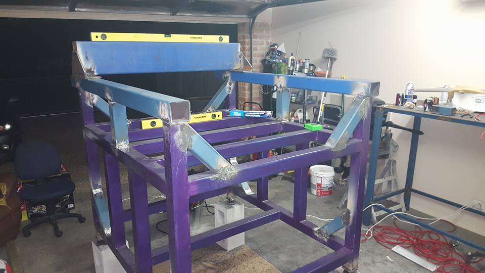

    Dave here. I'm designing a new machine for the office in the hopes of carving precision rifle stocks (4 axis) and whatever else is required from hardwood and aluminium. :)
    The build is already underway and frame currently ready to be painted.
    Details of the build
    Linear bearings: SBR20 fully supported rails - X:1300mm - Y:1000mm - Z:450mm
    Ball screws: RM2005 Chinese - X:1350mm - Y:1050mm - Z:500mm
    Steppers: Nema23 - 23HS45-4204S
    Drivers: M542H
    PSU: 48V 600w DC
    Frame/Chassis: 65x65x3mm box steel
    X axis chassis: 75x75x4mm box steel
    Gantry cross beam: 200x100x5mm box steel
    Gantry supports: 300x125x10mm steel angle
    Z axis supports: 200x480x10mm steel plate

    Here's some pics of the current build:
    original design

    Front on view - all level within ~1mm
    Side view
Name:	frame with gantry.jpg

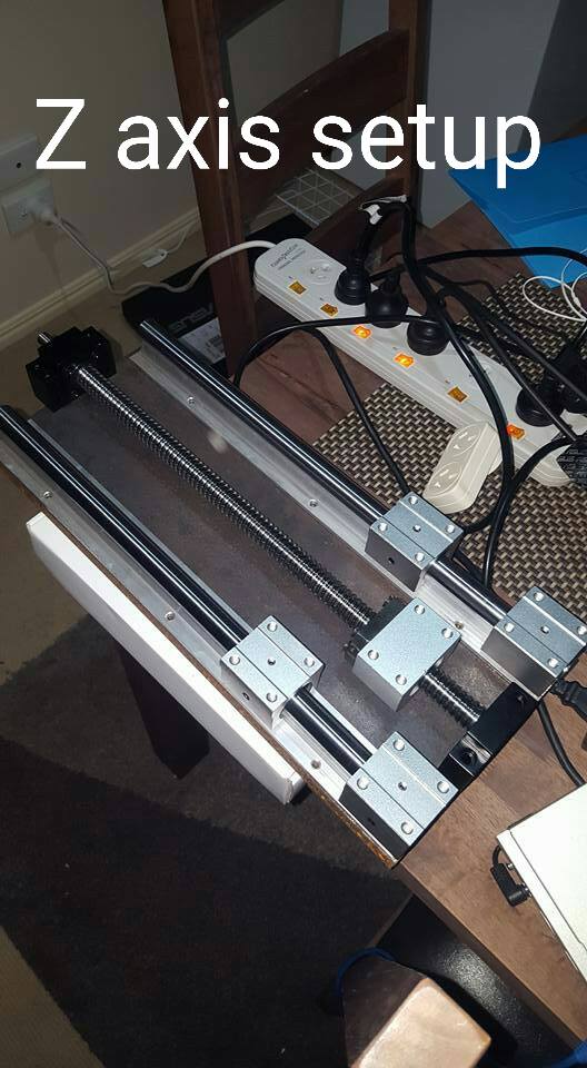

    Z axis setup.

    Anyway, thought i'd share guys. let me know what you think. :)
    - Dave.
