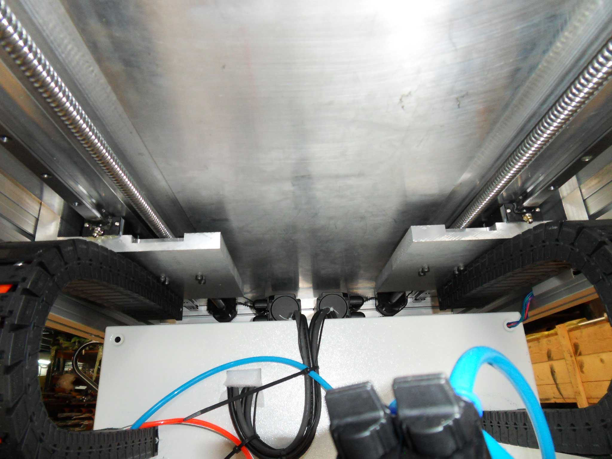

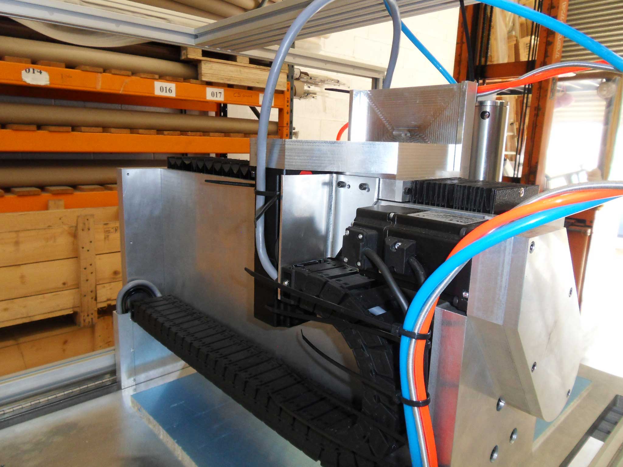

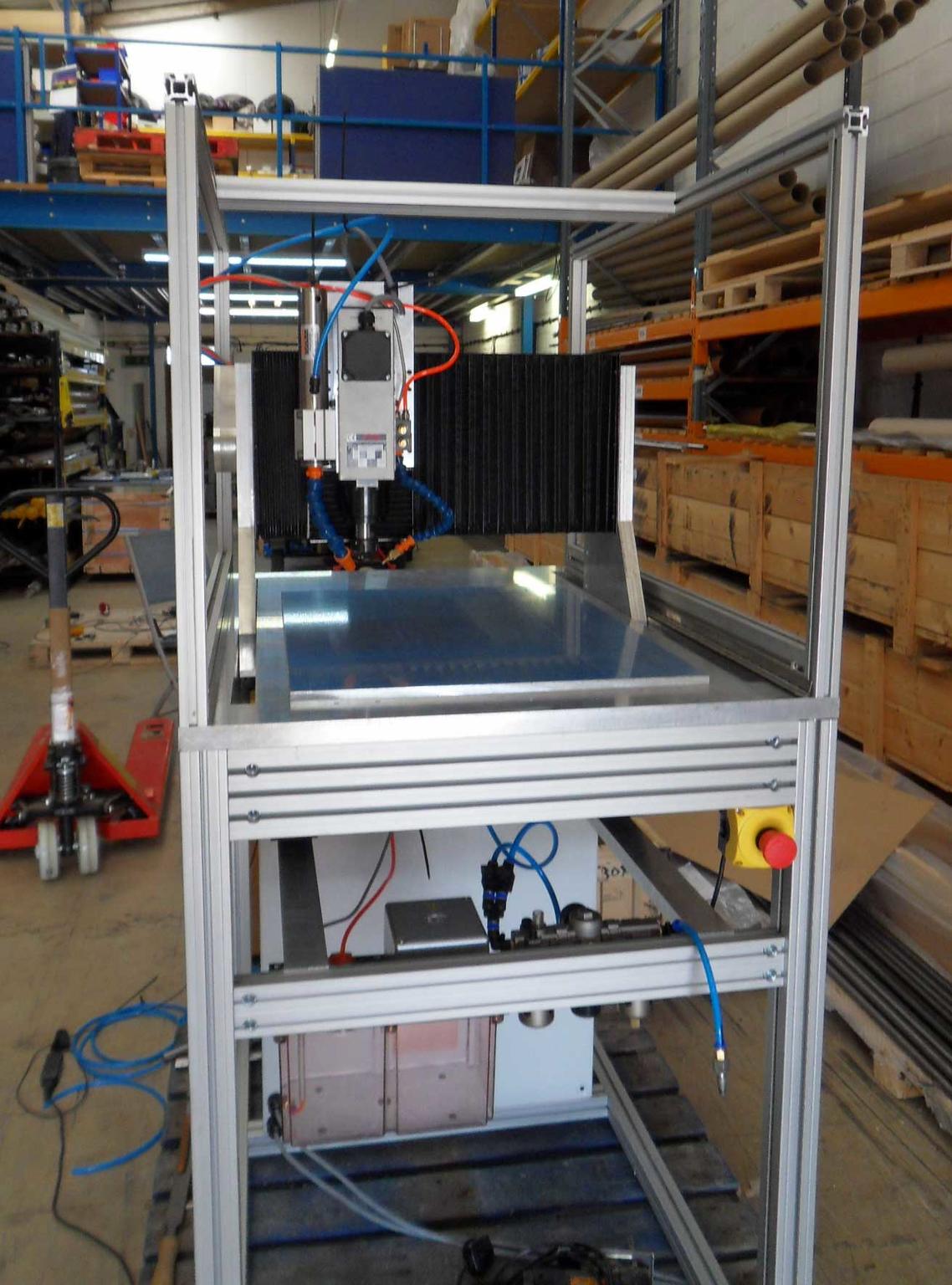

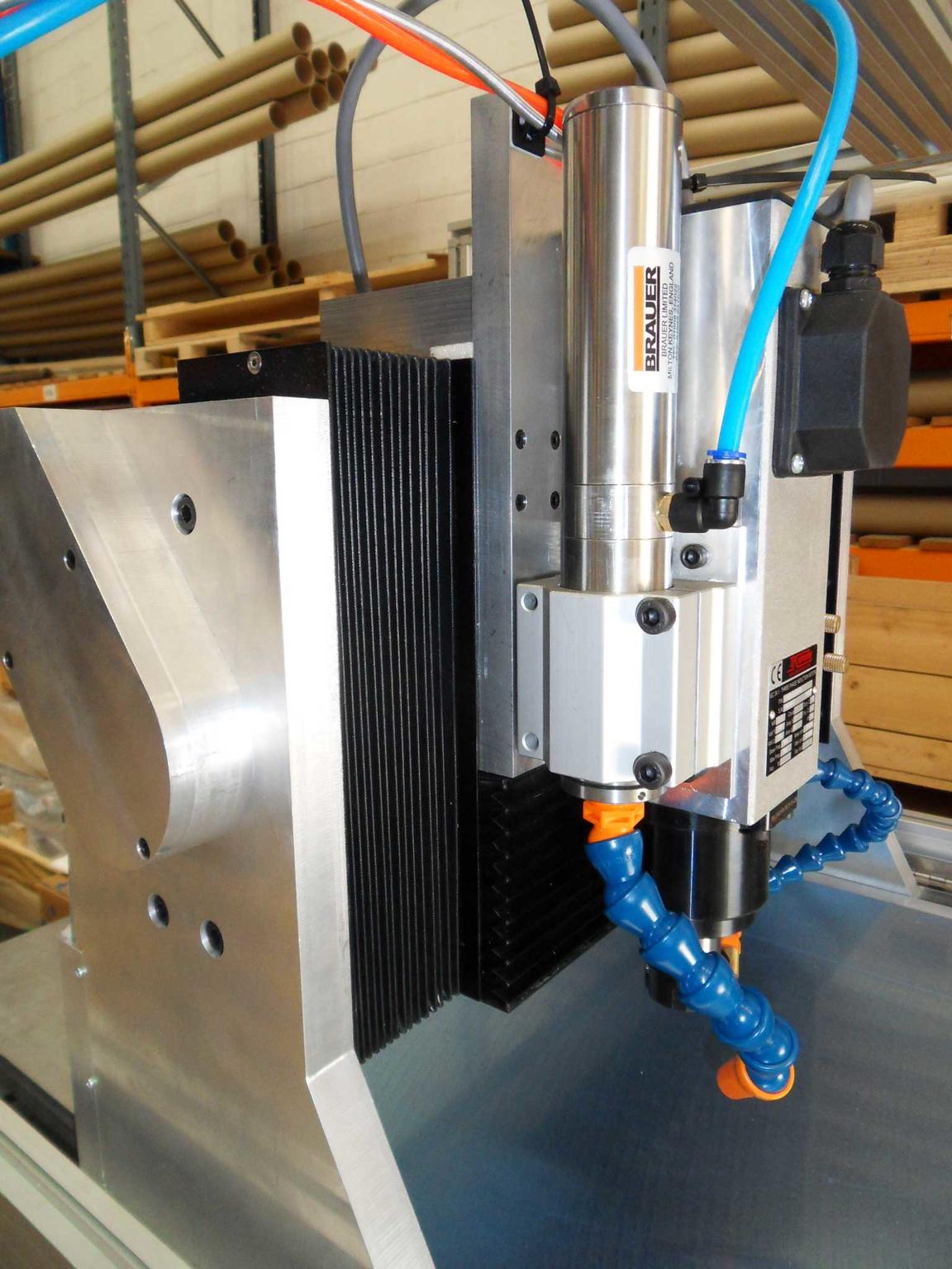

  1. As you know we have not sold machines or machine kits, because we felt what was available on the market was not to a standard that we could offer to our customers and because of this we have decided to make our own machines here in Poole, using the parts we sell and a lot of you are familiar with.
    We have started with one machine, but made it quite modular so to let us expand the range as an when we can and this machine should site in a size bracket that should appeal to most people looking for what we woudl call a desktop sized machine.
    The first machine we have called the 10060, i know its not a catchy name, but to be honest with you the name was not our biggest concern and may change when something more catchy comes to mind.
    I have seen a number of companies put details of there machines up on this forum and watched as they were ripped to shreds by some of the more knowledgeable people on here, so if you have any suggestion, please feel free to post them and i will consider them.
    This is an image of the machine as we are offering it at the moment, but this is the bare-bones option with a lot of other options available, like axis covers, hood, mist, cold-air cooling, flood, atc and so on.

    What is different to other companies is we will be offering a number of option, so if you want you can buy the complete kit or just an axis, and wen you can afford another axis you can buy that. or you can buy all of the parts individually.
    Initially you will only see the mechanical parts available (Plus the motors and limit/home sensors), but as we progress we will also offer the electrical control cabinets as well.
    We have been using the first prototype for a few months now finding all the issues and fixing them and we now use the latest version to make most of the parts.

    I know a lot of people like a long Z axis but we have decided to go for something that gives you about 115mm to keep the rigidity to the best we can, and i would also point out that over the months that we have used it, we have never needed anything more.
    The X axis has two ballscrews (R1610) and 20mm profiled rails, the Y axis has a single ballscrew and 15mm profiled rails and the Z axis has R1404 ballscrew and 15mm profiled rails.
    all of the ballscrews are C5 and the profiled rails are precision class. We also have concertina bellow covers for the Y and Z axis and are working on a cover system for X axis, but this axis is already quite protected because all of the linear motion parts are under the machine.
