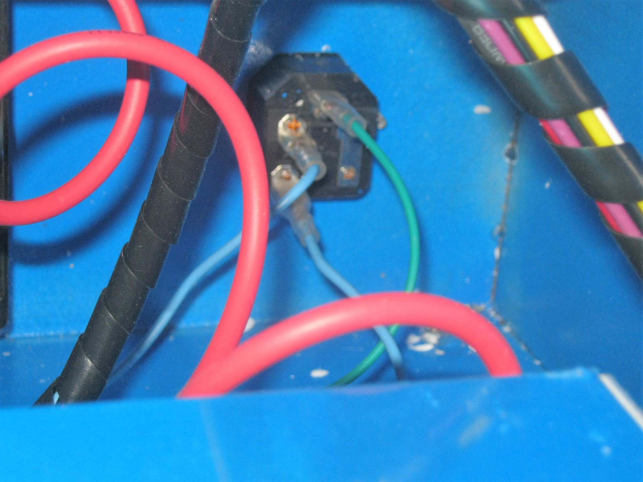

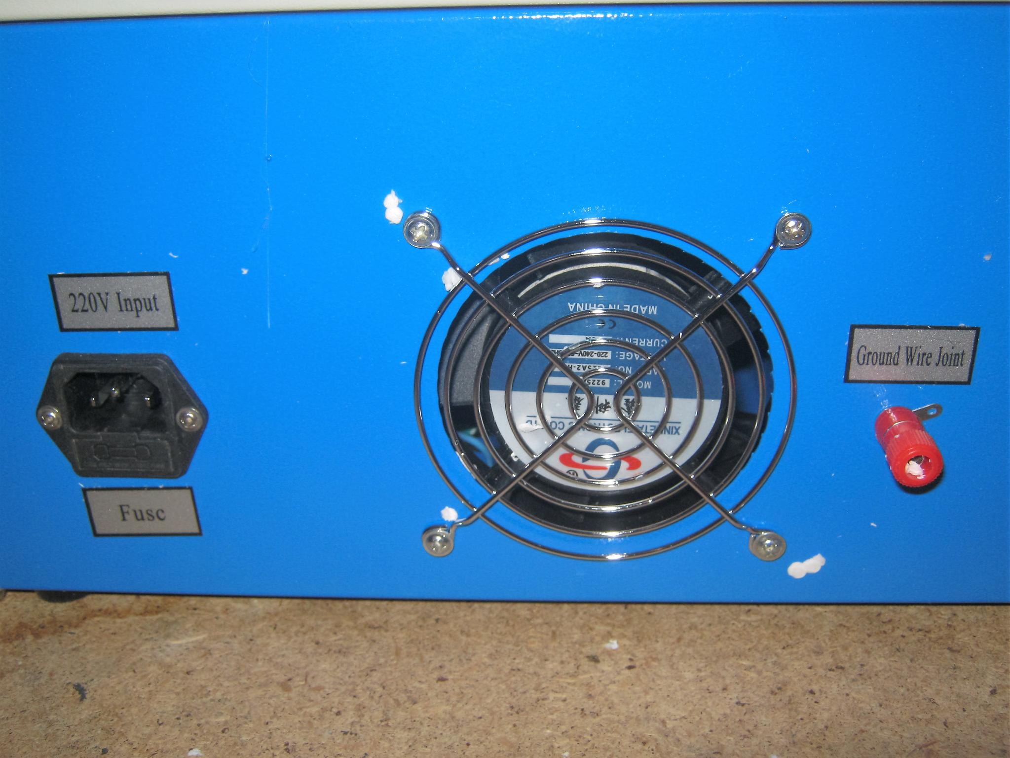

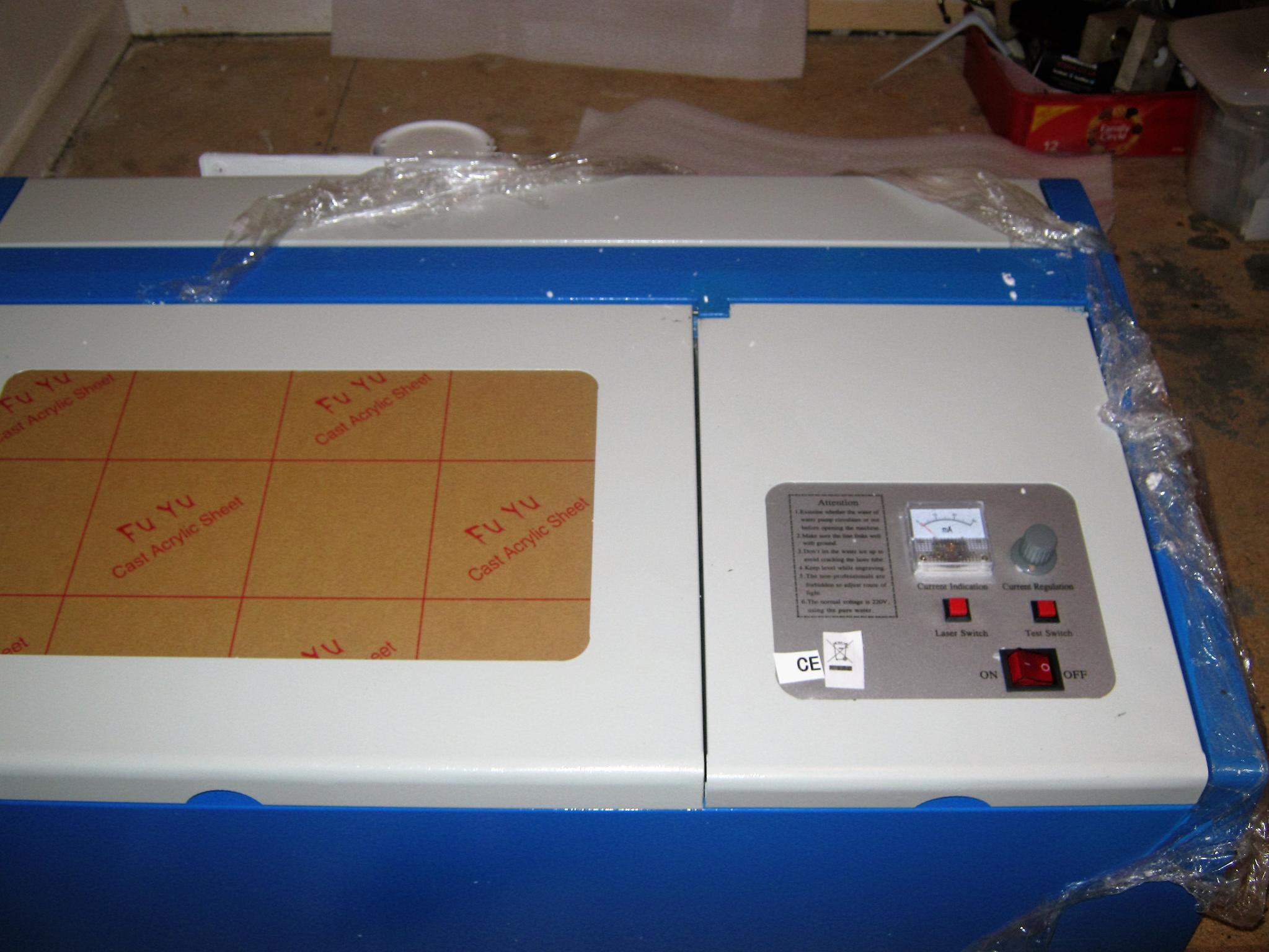

    Hi , anyone from Ireland or in the uk using one of these machines.
    Iv got a 220v machine , the lead has a IEC connector and US style plug with a European adaptor.
    I don't want to use these adaptors.
    Did you change this power lead to a standard uk IEC lead?
    thanks Pete

    Ill make sure i have good look over the machine the best i can. I still haven't removed all the packaging, I thought it best get this power lead problem cleared up first in case i have to return it.
    Did you use the ground connection on the back of the machine or does a proper uk IEC lead do the job?
    Doddy's Avatar

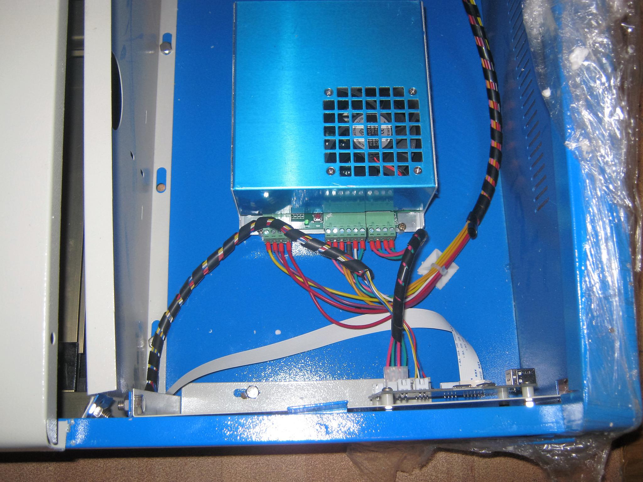

    Check that the earth on the IEC connector is exported correctly to all parts (okay, be honest, add more bonding straps as you see fit), then ignore the earth connection on the back.
    As I've mentioned elsewhere recently... check the inlet/outlet for cooling are the correct way around (inlet to the lowest point on the tube, outlet on the upper point).
    Thanks Doddy, I got few of these IEC leads about. Would I use one with a 13 amp fuse or lower? Are bonding straps easy to attatch or is there some skill involved.
  7. #6
    Doddy's Avatar
    Standard "C13" IEC sockets are rated to 10A, only (the kettle-type are a different variant - "C15", by memory, though I might be wrong - and have mechanical interlocks to avoid the wrong plug/socket combos); So, standard PC-type leads should be protected at no more than 10A. In reality, I can't imagine the wiring inside the unit to be rated at that level - a visual should confirm. I'd be tempted to replace the fuse with a 3A.
    Bonding straps?, just crimp a couple of eyelets onto the ends of some 2.5mm stranded copper wire with yellow/green insulation and bolt from a single star-point bolt fixed through the steel chassis (look to see if the ground stud provides a suitable earth), the other end onto each hinged/bolted panel (so, main lid, the removable control panel lid, and maybe the rear laser enclosure lid), having cleaned the paint off the steelwork on each panel (don't rely on the bolt to provide low-resistance path to the panel), tighten, then if you fancy, a dab of hammerite over the top to stop corrosion.
    Of course, you're reverse engineering safety into the machine - for all my ramblings about these, if I'm honest, I normally live with the flaws.

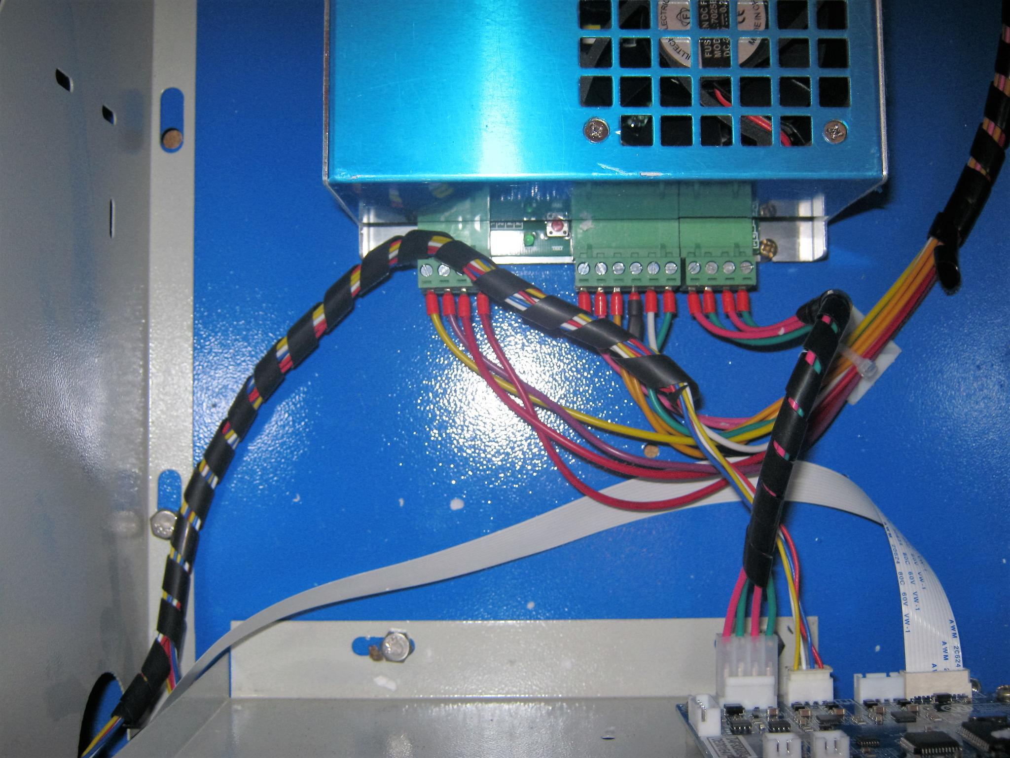

    Thanks doddy,very helpfulClick image for larger version.

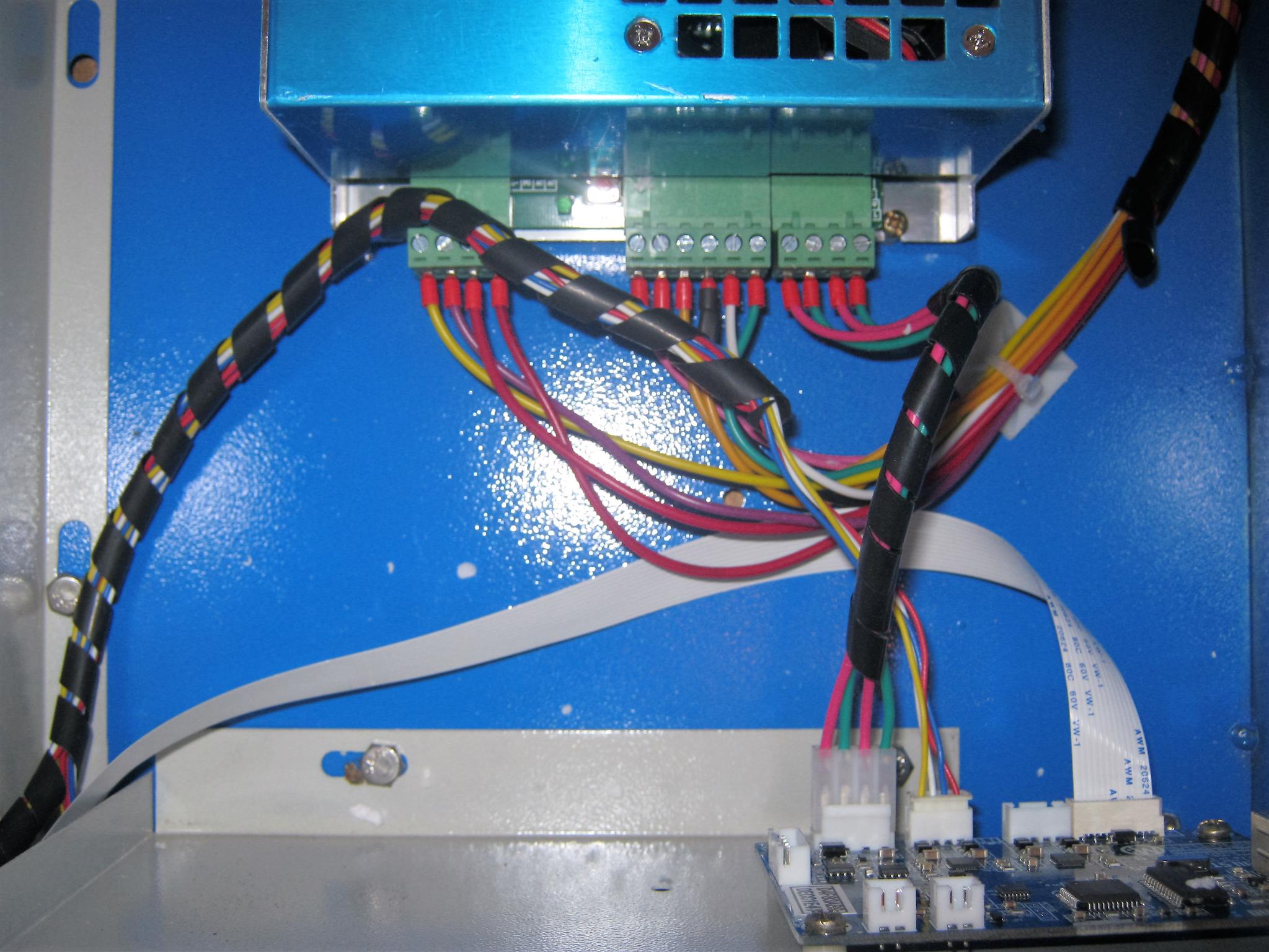

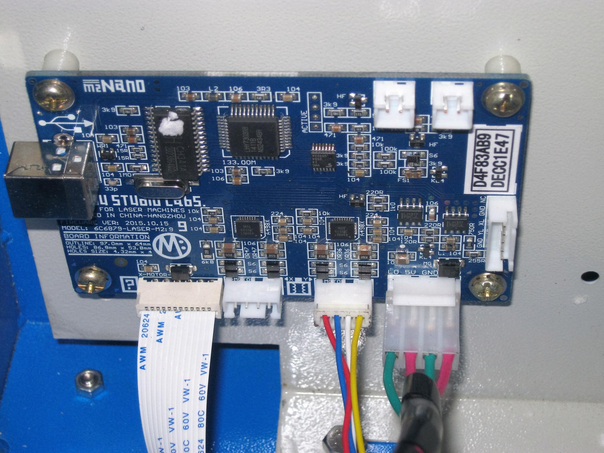

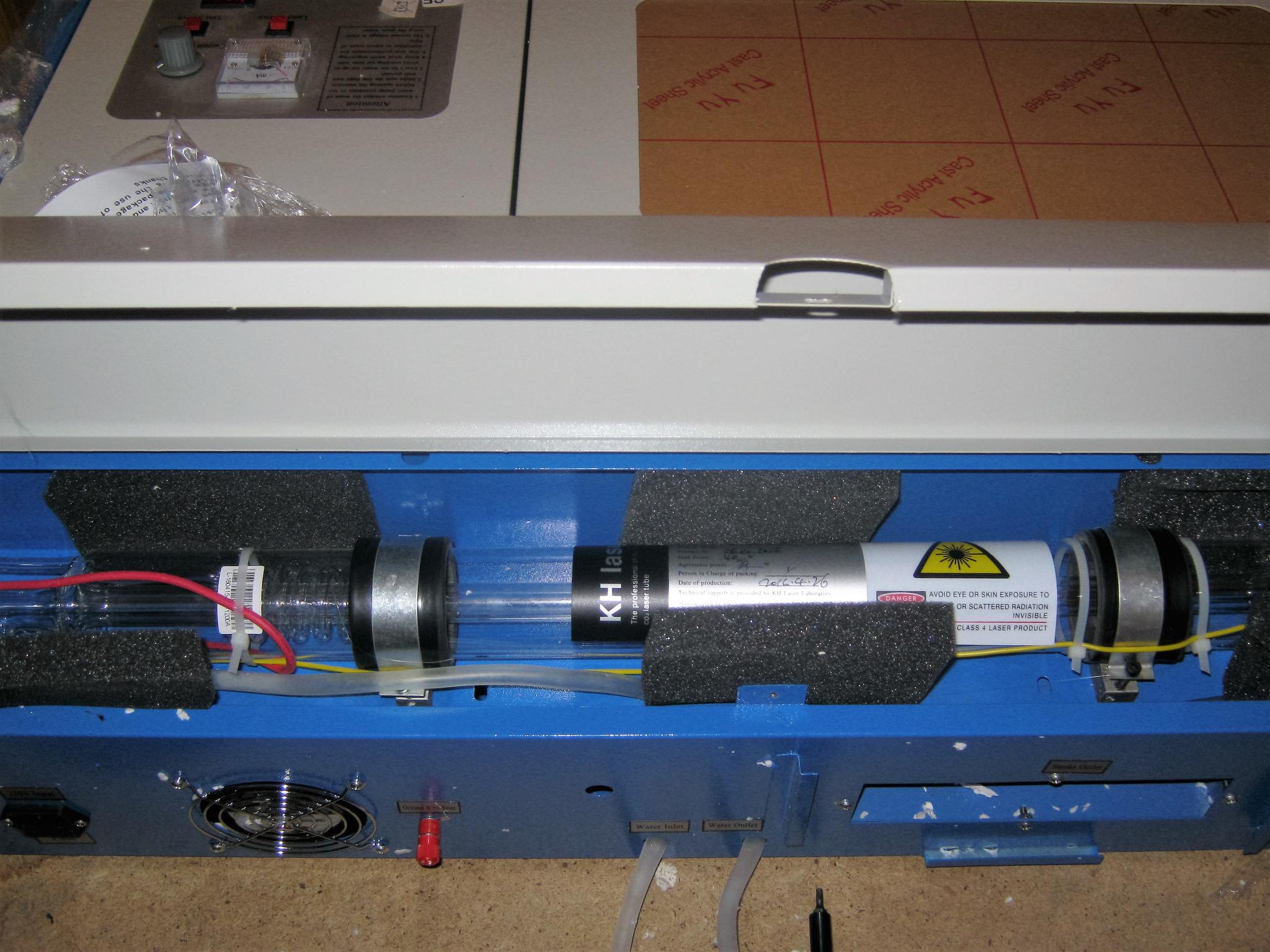

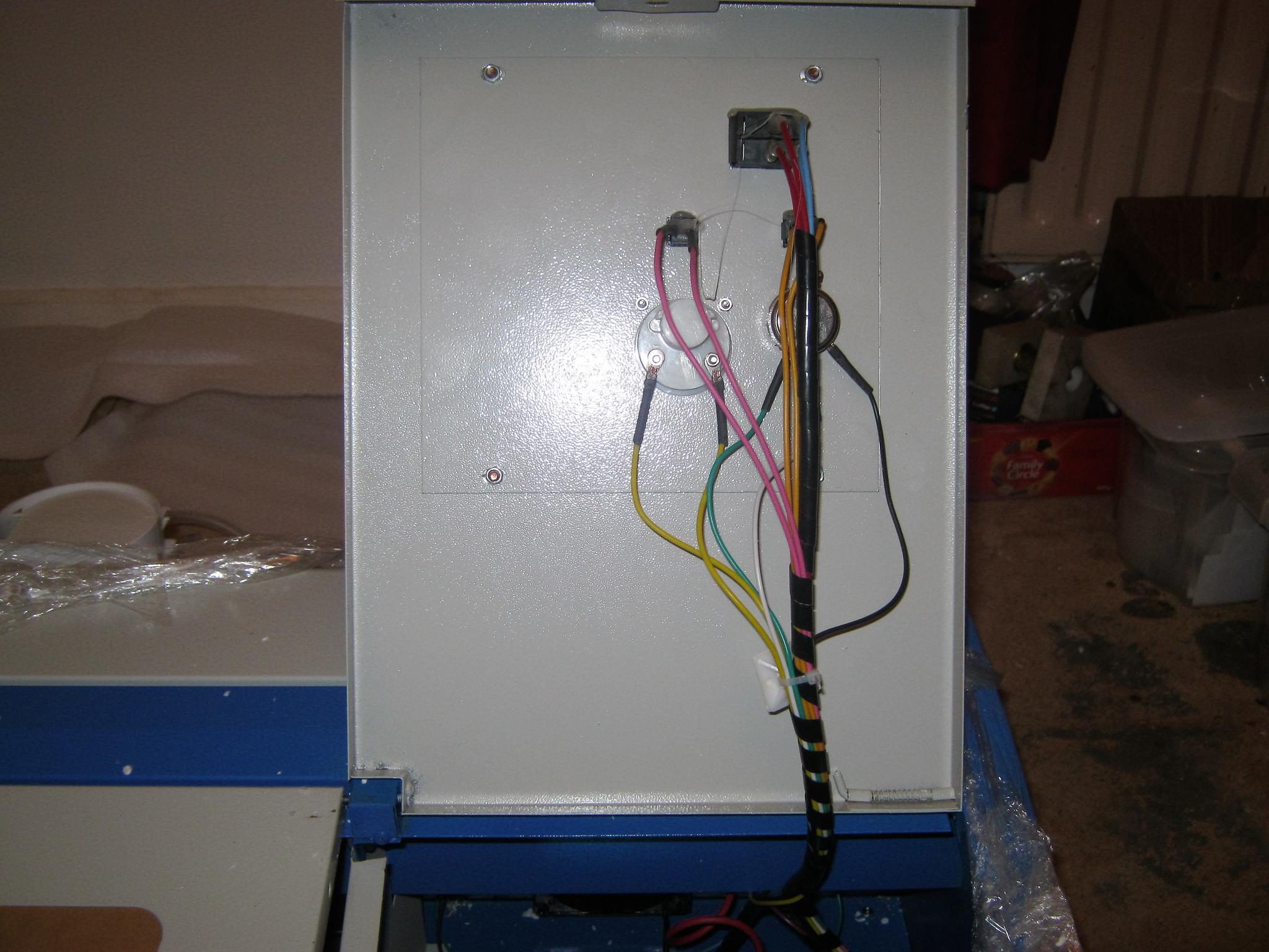

    Some pics of inside to see if things look ok. Still some bits of foam and other packing i still have to remove
    Doddy would this be done by plugging the machine in and then using a multimeter and checking different parts of the machine for continuity? I got a multimeter or have i got it all wrong.lol. thanks
