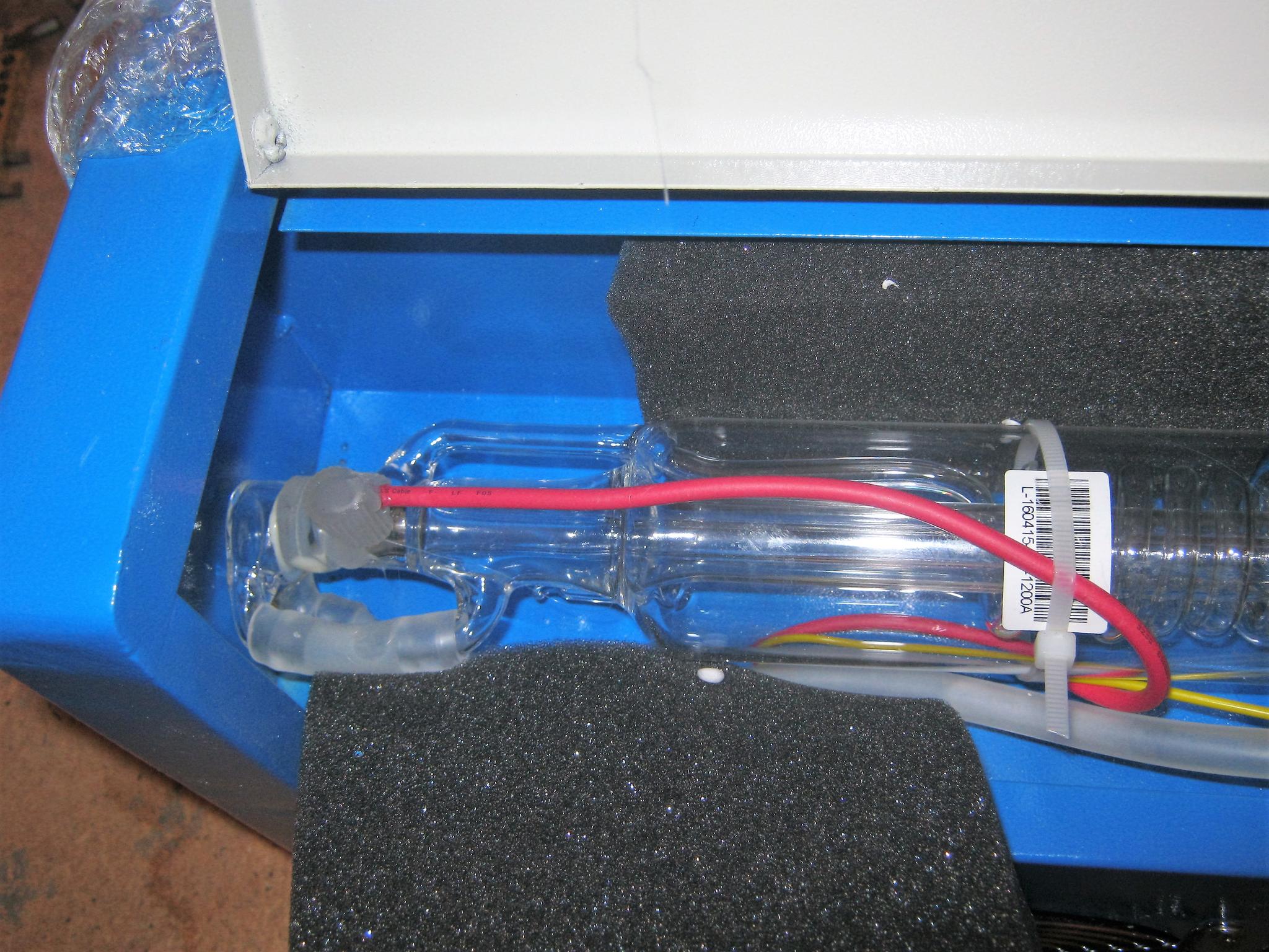

    As I've mentioned elsewhere recently... check the inlet/outlet for cooling are the correct way around (inlet to the lowest point on the tube, outlet on the upper point).

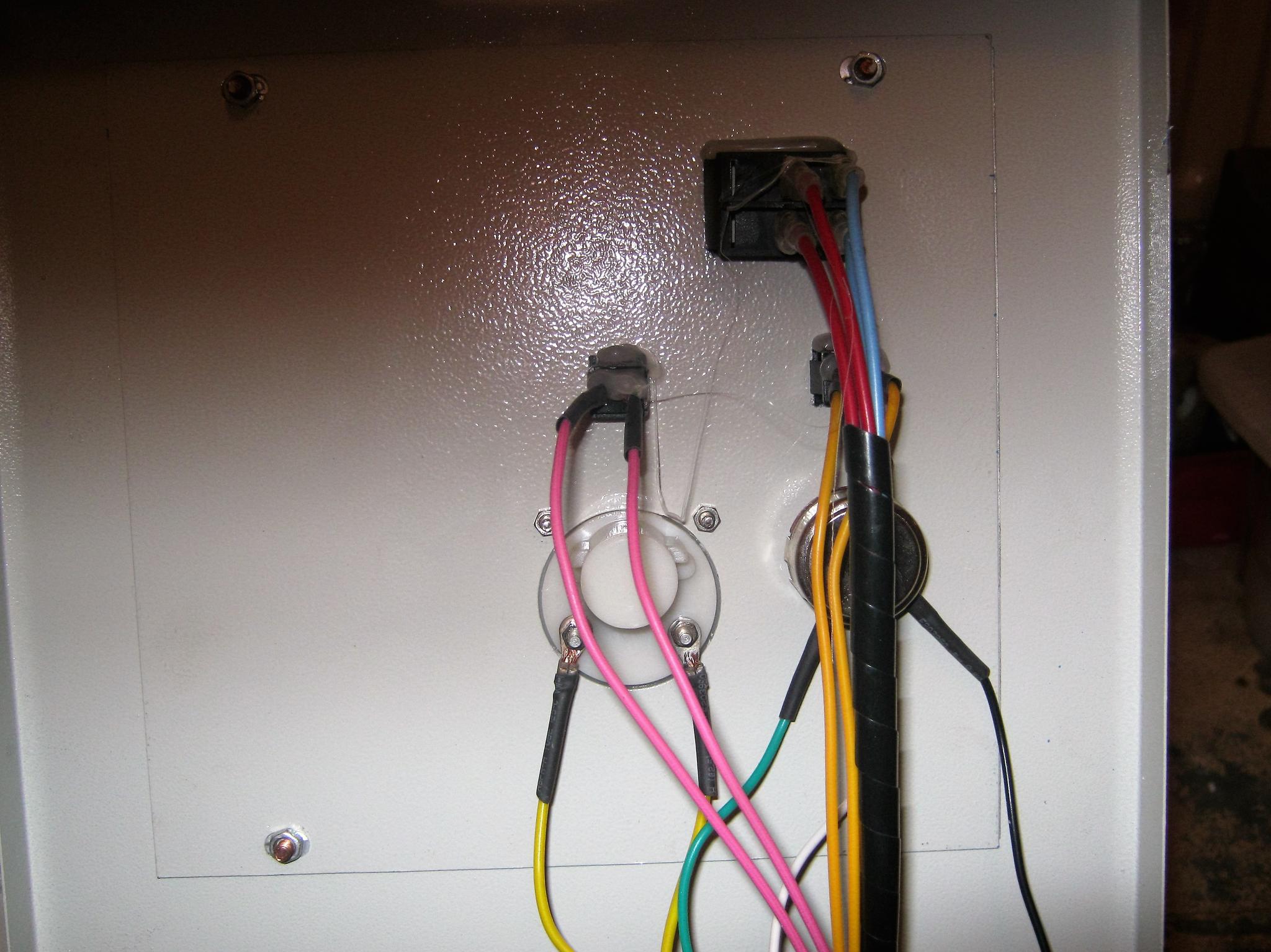

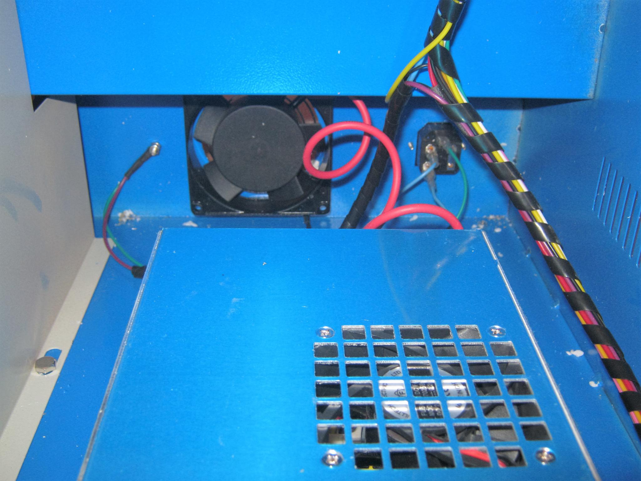

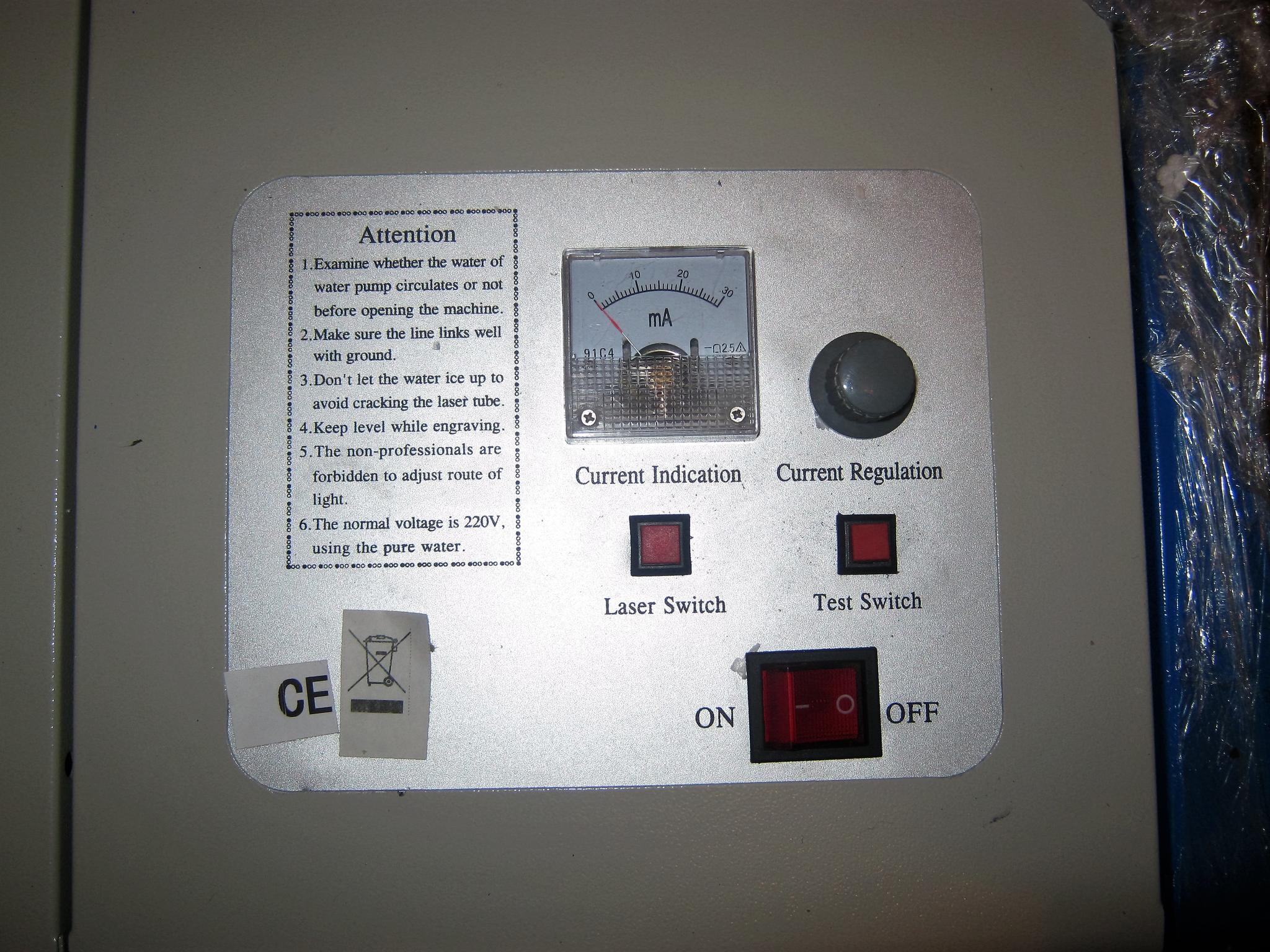

    Some pics of inside to see if things look ok. Still some bits of foam and other packing i still have to remove

    Check that the earth on the IEC connector is exported correctly to all parts
    Doddy would this be done by plugging the machine in and then using a multimeter and checking different parts of the machine for continuity? I got a multimeter or have i got it all wrong.lol. thanks
  11. #9
    Ignore this - next one includes quote for context
  12. #10
    Quote Originally Posted by CNCPete View Post
    Nope, that the earth is physically bonded (earth straps) to each panel. Relying on hinges and the like is... erm... frowned upon.
