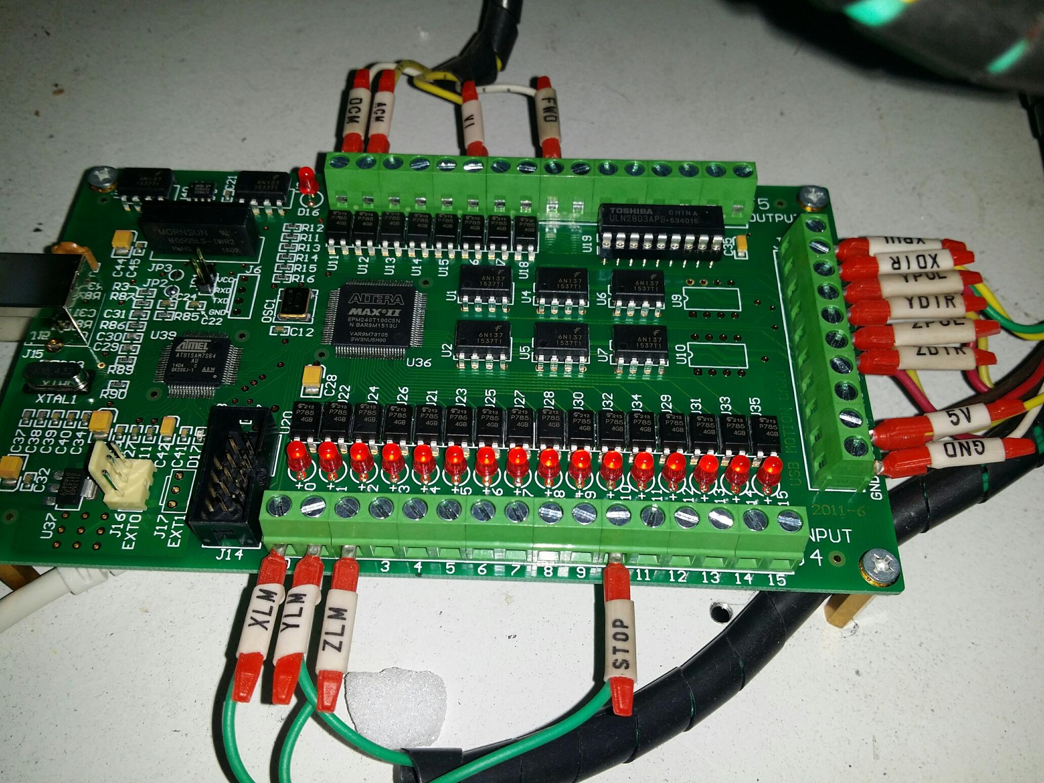

    Hi There Jazz,
    I had to take yesterday off but managed to take some better quality pictures today.
    I have attached some and hope they are useful but if you need any specific pictures including screenshots from Mach3 please let me know as it seems will have to sort the problem our self's. All the Chinese support does is trying to push us to install nc studio instead of mach3 saying that the guy who built our machine and had mach3 experience has left their workplace.

    Thanks Jazz,
    That means we are one step closer to resolving this issue.
    From the uploaded pictures would you be able to point out the wires I have to check the voltage on?

    Ok the wires you want to measure are ACM and V1. I suggest you try this at the board with wires removed. Then at the VFD end to verify getting same voltage.
    To test Put meter black Probe to ACM and Red to V1 then command a speed of half your MAX spindle speed. It should read 5v or very close.
    The spindle is using pulley #4 in Mach which is to 12000rpm this means mach will scale the output 0-10 voltage from this. IE: if you command 6000rpm it outptus 5v and if 12000rpm then 10v but commanding 18000rpm will just get you pulley ratio warning.
    So if your spindle MAX rpm is 18000 then setting pulley ratio #4 to 18000 means mach will scale the output so 10v is given at 18000rpm.
    I've looked at the spindle setup in Ports&pins and it's turned on but without more details of the Spindle board then can't say if correct or not. Looking at the Spindle Output in Motor tuning I would say it doesn't look like it's setup correctly but like say need to know more about spindle board to be sure.
    Testing the 0-10v voltage will give you best clue if it is or not.
