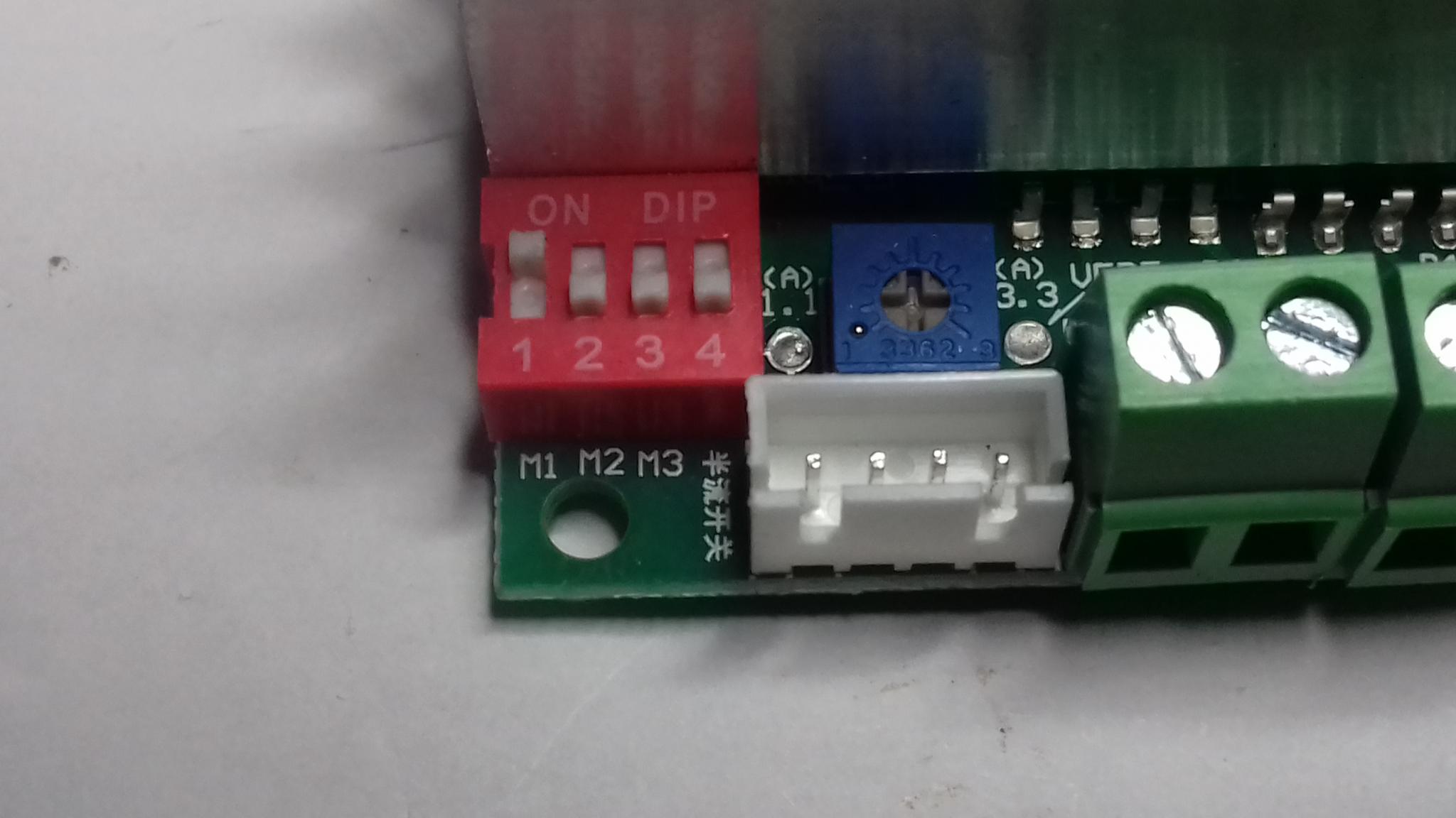

    Hi Thank you for your help I now have all Axis working! well I have power to them. Only one will run continuously, the others judder. I have attached a pic how do I set up the red box I only have 123?Click image for larger version.
    Thanks again
    Mike

    Why'd you get the P, O, S, TB6600?.
    https://m.aliexpress.com/wholesale/T...tml?osf=direct
    Hope you didn't pay too much.
    Should've saved yourself aggro and just gone with 542 or 556.
    You get what you pay for.

    Hi Thanks again for your help. I now have power to stepper motors but they will not run, they sound stalled or trying to run to fast so do not rotate
    Do you have any idea ??
    Mike

    Double check you have A+A-B+B- motor connections in the correct order on the driver. If incorrect you can get this happen due to dir conflict.
    Which model numbers are the motors specifically.?.
    What is actual machine?.

    Hi Thanks for that, My steppers are 60BYG301B
    Mike

    Hi It is a home built and was working great until my Geko 540 gave up. Do I use all six wires fro the motor and Bipolar series??
    Mike

    Ah!!!!.
    I see 8 wires.
    Best balance for both speed/torque is parallel. Also lowers your inductance. Twist pairs together and connect as folliws:
    A+ RED & BLU
    A- YEL & BLK
    B+. WHT & BRN
    B- ORG & GRN
    Then 10-45v power supply in the other 2 terminals (marked 32v & GND I think).
    Try that.
    I see your motors are 3.2mh inductance in parallel (it's lowest level avail). Not great for trying to get fast rapids on only 36v or less. Fine for general cutting speeds.

    Most likely happening because your motor tuning in mach3 is set for the Gecko drives and these cheaper TB-based drives cannot handle the same tuning setup. Try backing off the velocity and Acceleration by 50% and try again. When you have it working stable then slowly increase them one at a time until they start to stall again then back off again by 10%.
