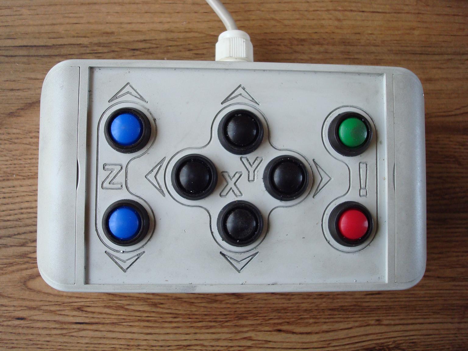

Hi all,
I finally got around making an enclosure for my Mach3 USB keypad.
See pictures attached.
Attachment 5947
All parts are from RS electronic, if anyone would like to make one let me know... I'll post the necessary info...
RNR

Hi again Laurent, I should like details of this - I have cnced a Seig SX3 and am frustrated with jogging from keyboard this seems to fit the bill.
Many thanks
John

Hi John,
I don't have any PCBs done as it is too expenssive... I was hoping to get a bit more interrest from members of this forum so we could group a PCB order to get the price down. But it did not happen so....
I can provide you a schematic and an image to program in the PIC microcontroller.
For the 4th axis, At the moment all buttons are used X+, X-, Y+, Y-, Z+, Z-, Sart and Stop.
But I CNC the top cover of the enclosure myself. If could be machine differently to add a 4th axis... Or even use a different enclosure bigger to do more ???
The PIC micro controller I used has plenty of I/O spare so....
Have you got a PIC programmer ?
