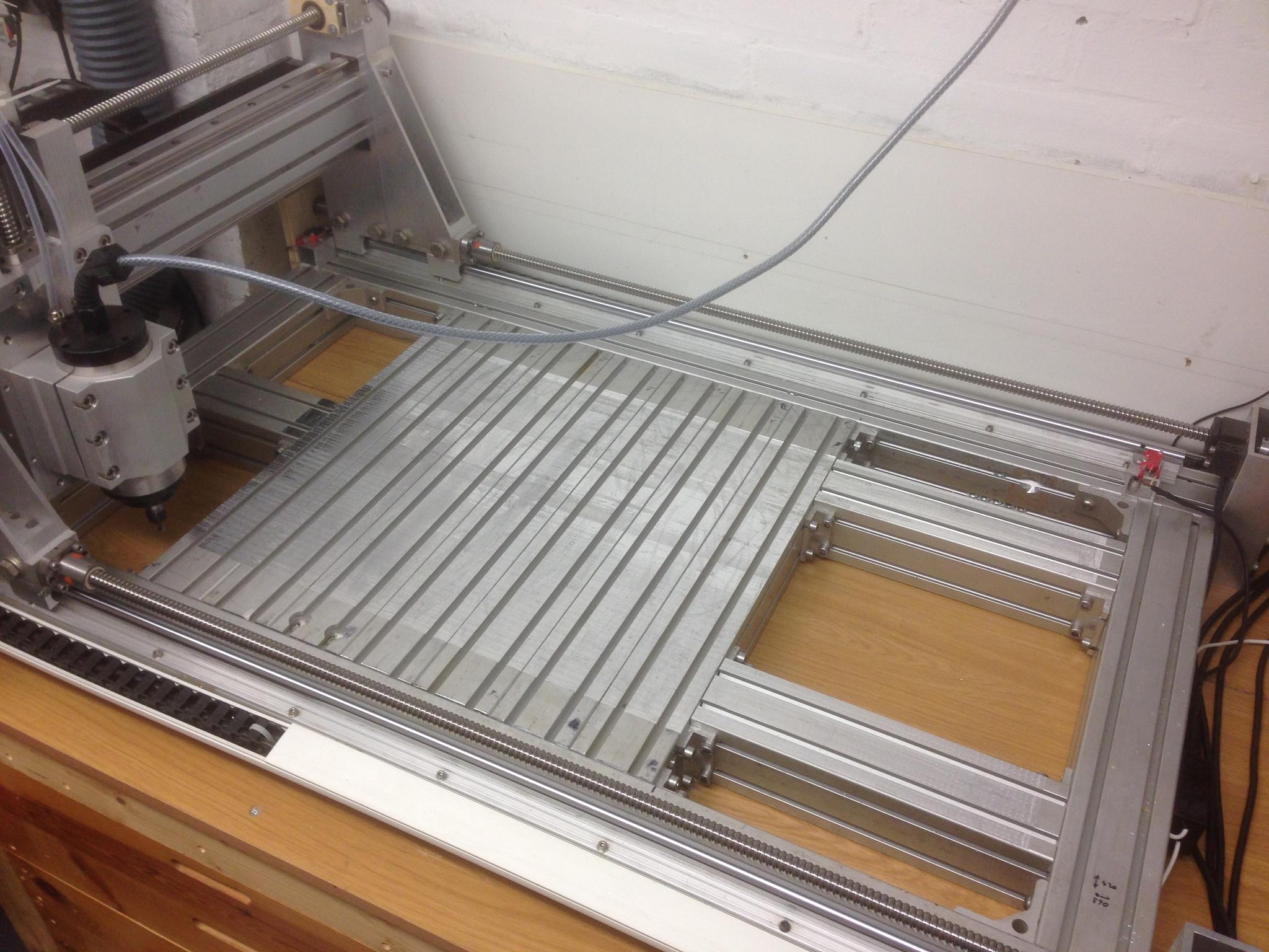

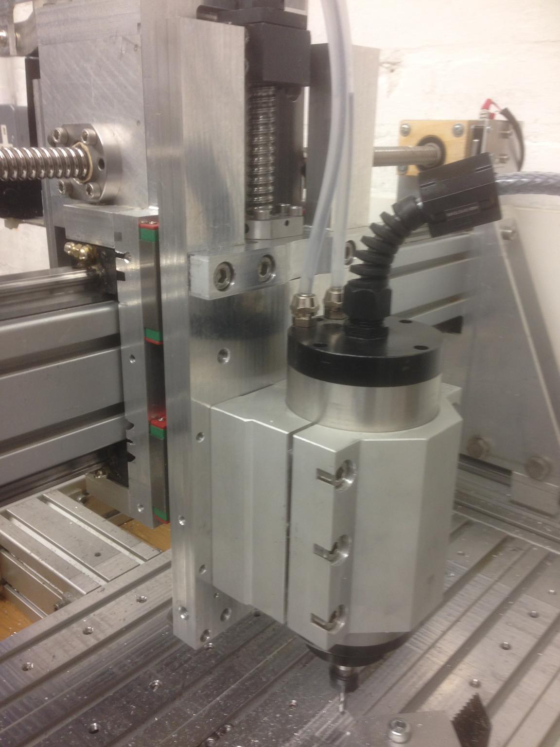

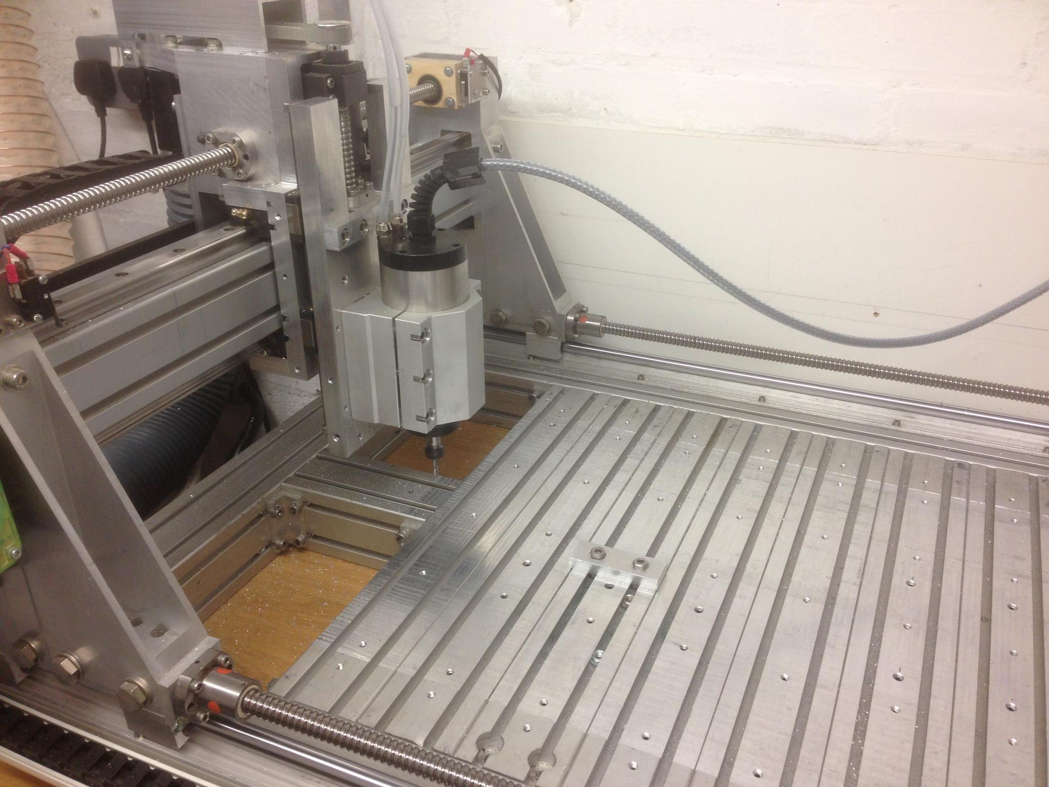

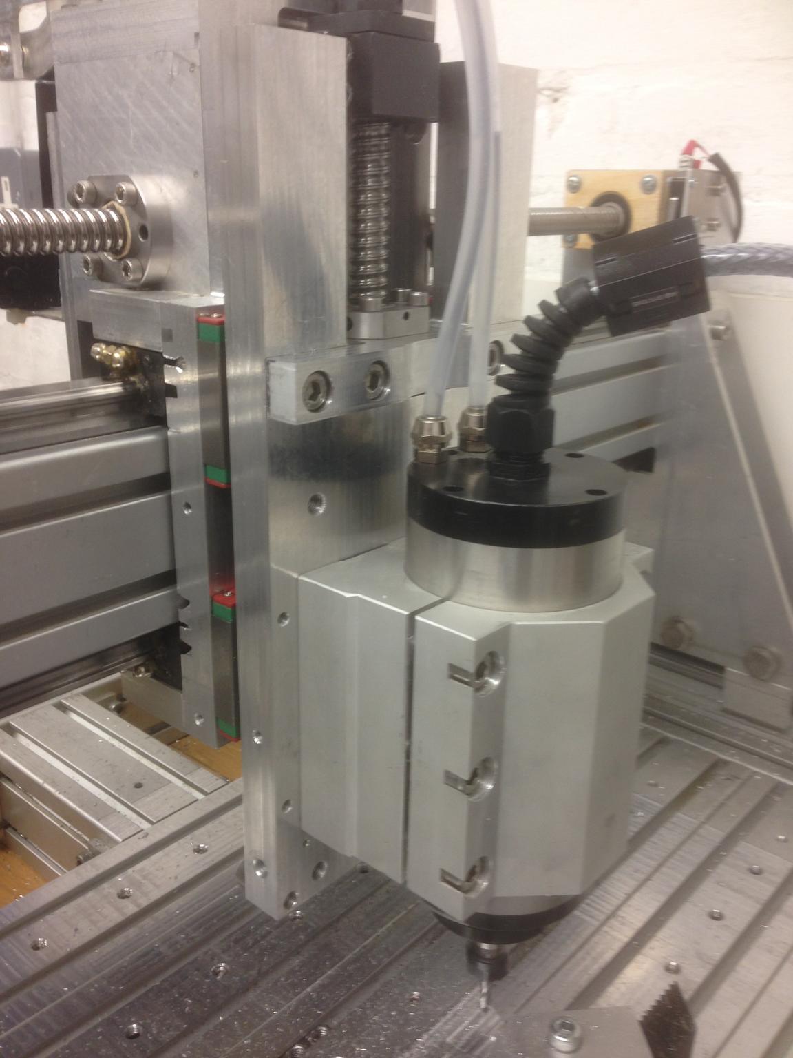

CNC router MK3:
Attachment 18968 Attachment 18984 Attachment 18985
Attachment 18986 Attachment 18988
https://www.youtube.com/watch?v=qEmj...ature=youtu.be
Footprint approx: 1200x700mm
Cutting area approx: 800x500mm
Z travel approx: 150mm
Linear movement: X=16mm supported rail, Y=Hiwin 20 square, Z=Hiwin 15 square
Transmission: 1:1 ball screws 1605

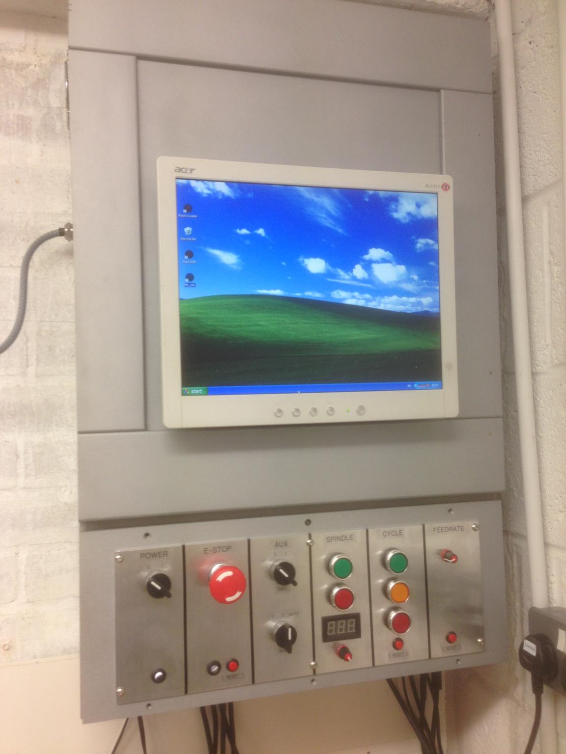

Motors: X,Y,A = Nema23 3Nm at 72V (DIY linear PSU), Z = Nema23 1.8Nm at 72V, all DQ860MA analogue drives
Breakout board: DB25 (Free simple board which came with the drives - OK so far . . .)
Spindle: 1.5 kW watercooled spindle with Huanyang vfd/inverter
Frame- 80x80 heavy gauge aluminium profile, bolted
Gantry- 80x80 heavy gauge aluminium profile, bolted, plus aluminium box section sides, bolted
Build log: http://www.mycncuk.com/threads/6988-routercnc_MK3
Machines: liteply, wood, and occasional aluminium
Notes:
1. Works very well for intended purpose (wood mostly).
2. Would go with 1610 ballscrews on X and Y next time, most likely digital drives, plus at least 2.2 kW spindle to allow tools up to 12mm.
Re: Finished builds picture menu

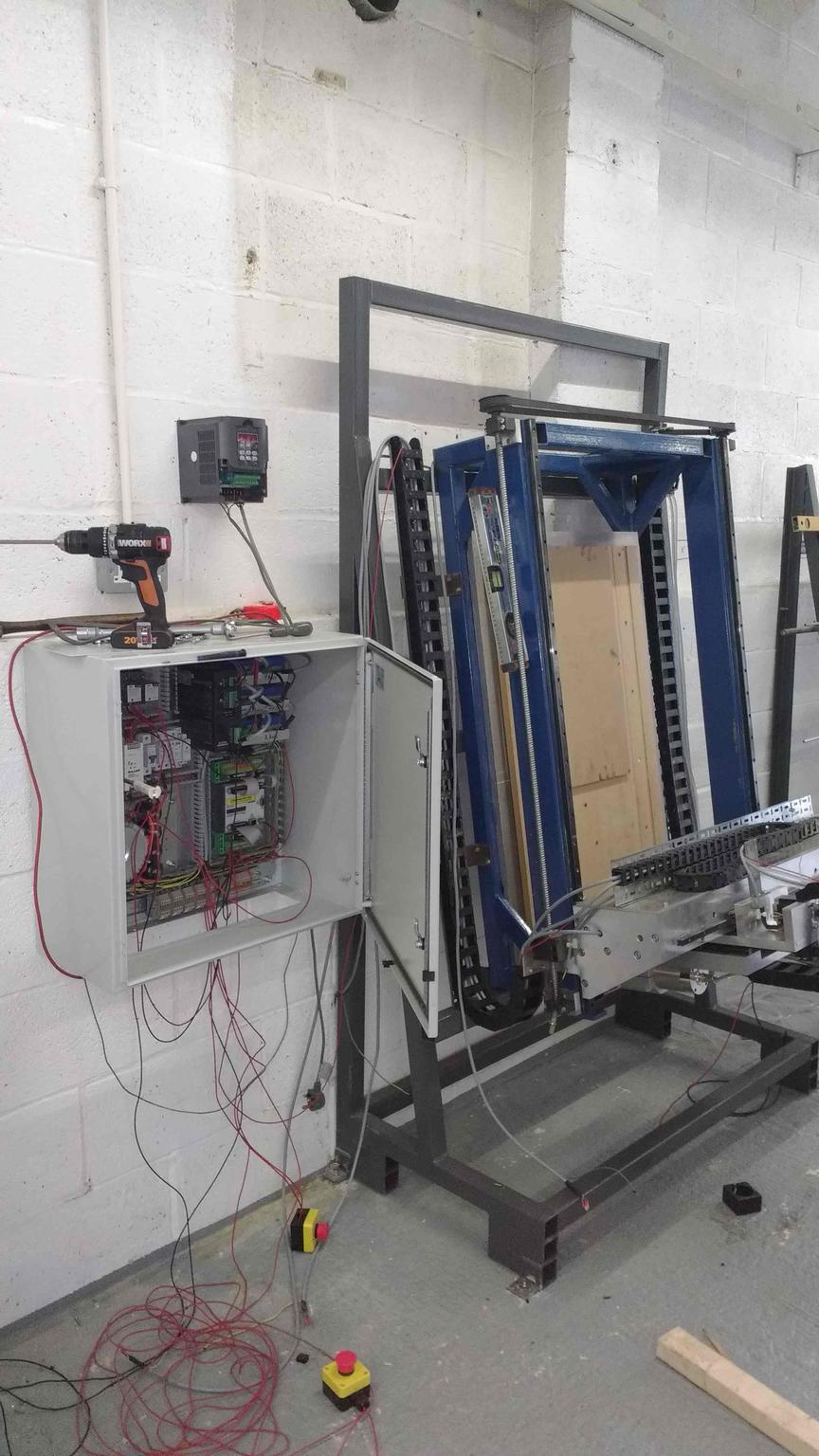

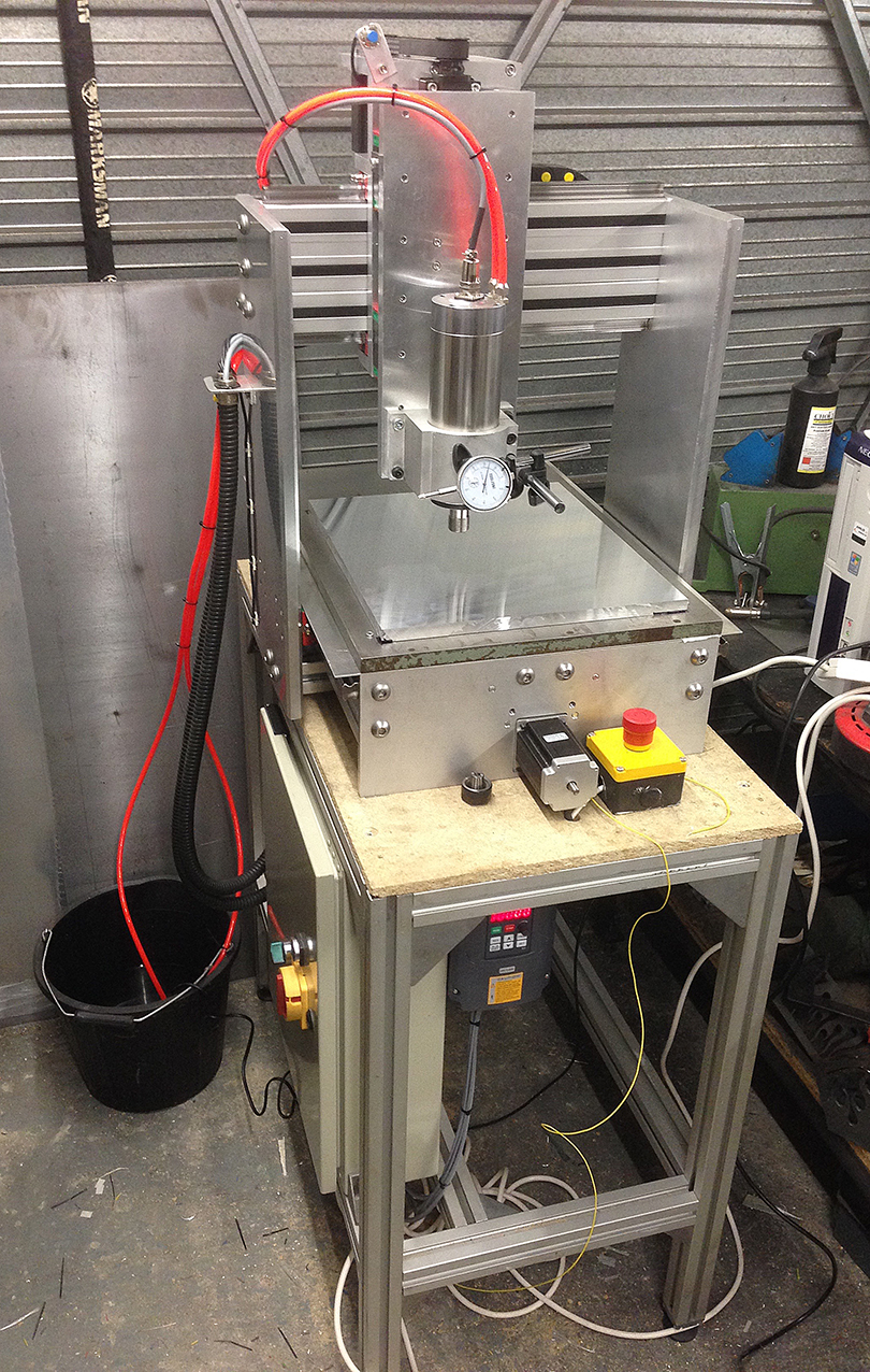

My mini-mill, designed to cut aluminium.
Attachment 18970
Footprint - 600x1000 (inc stand)
Cut area - 300x400
2.2kw water-cooled spindle
2.5kw ABB sensorless vector drive
4Nm Nema 23 motors 1:1 all round
48v psu
UCC100 USB motion controller

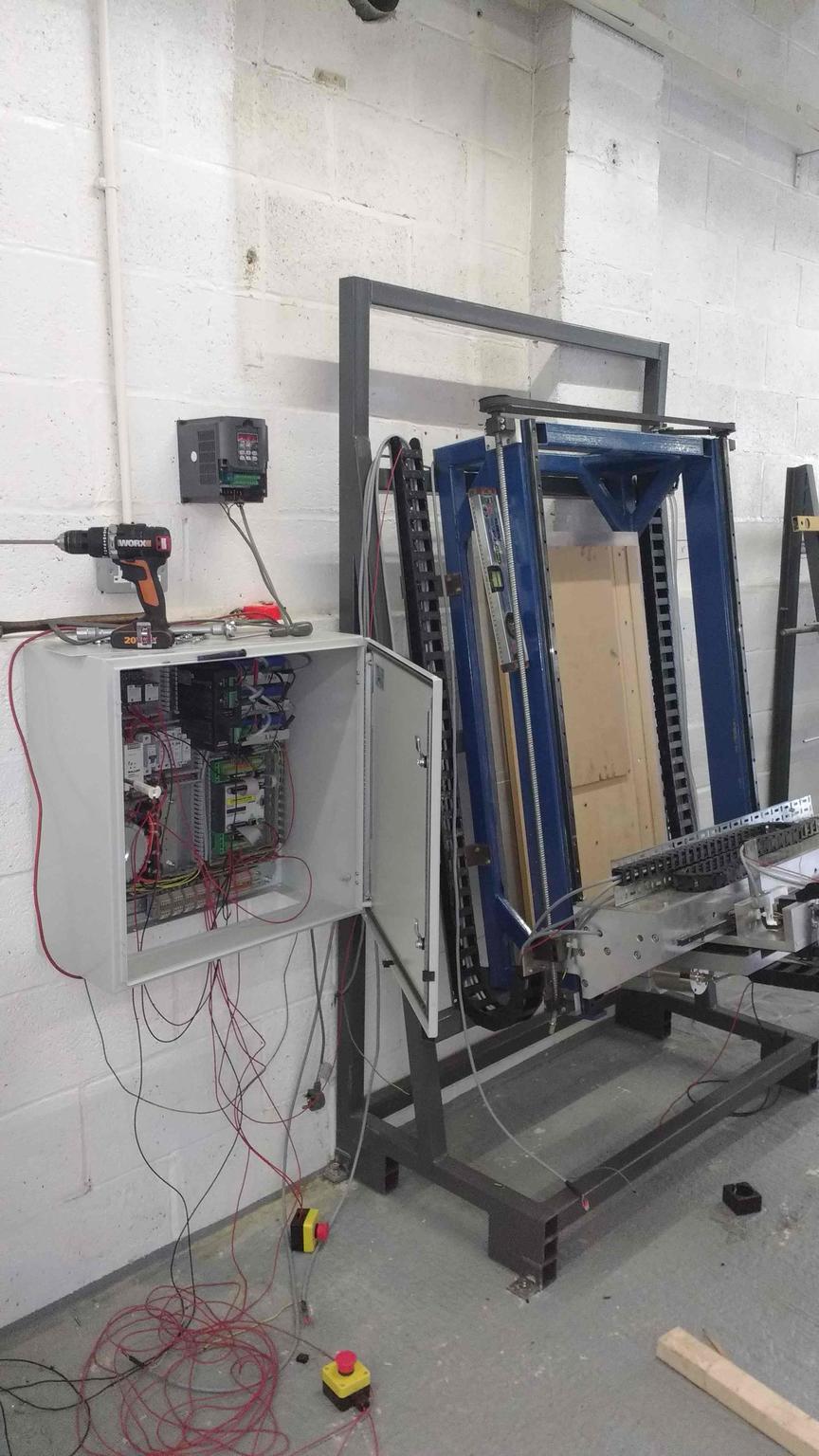

My CNC Router originally designed to cut balsa and lite ply only, now cuts wood, plastic, aluminium and even steel.
Attachment 18971
Footprint approx: 1350x950mm but now vertically mounted so physical floor space now less...
Cutting area: 970x500mm
Z travel approx: 100mm
Linear movement: X=20mm NSK profiled rail, Y= THC 15mm profiled rail, Z= THC 15mm profiled rail
Transmission: 1:1 ball screws 1610 on X & Y, 1605 on the Z all connected to the steppers with belts.
Motors: Y & Z = Nema23 3Nm at 70V via DIY PSU, Leadshine AM882 digital drives. Xaxis Nema34 8Nm @ 230V, Kinco driver
CSMIO IP-M controller
Spindle: 2.2 kW watercooled spindle with Huanyang vfd/inverter
Frame- 50x50x3mm steel with X axis rail supports 100x50x3mm steel box, frame bracing/triangulation/bed slats 50x25x3mm steel box
Gantry- 20mm Aluminium Tooling Plate, bolted - Z axis front 40mm thick Aluminium tooling plate
Build Log
You Tube channel CNC playlist...

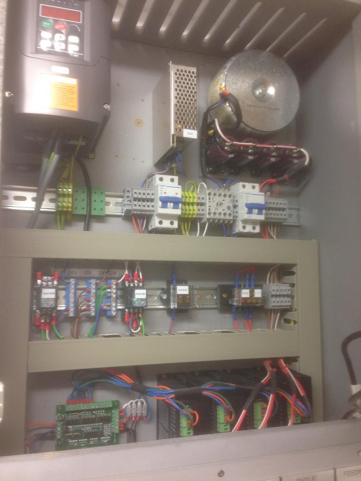

Hi Router Cnc
Have you got the specs or a part number for the rail mounted relais in your'e wiring diagram ? Thanks in advance.
Andrew
ps I sent the same question on your you tube vid
