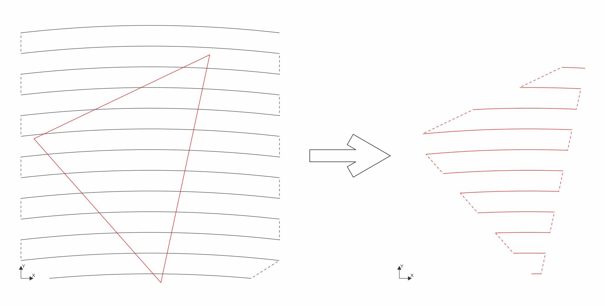

if you remember, here is why it is so time consuming... Now I have to generate separate toolpath for each triangle separately. I already have the toolpath for a surface big enough to include every shape I need, but now I need to eliminate the unnecessary movement.

I do not see where it is the complexity. My g-code is a list of points defined by XYZ. I need to look at the the XY coord. of every line and compare with my shape. If the point is inside the shape keep the line, if it is outside delete it. That simple.
To get an idea of what I'm doing, I have the shapes already cutout and I'm applying a surface texture on them. I need to eliminate the extra movement, cutting out air, around the shape.

Doesn't matter. The moves are the dotted lines in my sketch. There will be a G1 move from the last point of one texture line to the first point of the next line. It will cut through air anyway.

In geometry, the term for what you want to do is 'clipping'
Try a search for 'polygon clipping'
It seems like a simple task but is made difficult by lots of tricky edge cases.
If you can code in c++ or c# or Delphi i can recommend Angus Johnsons excellent freeware 'Clipper' http://www.angusj.com/delphi/clipper.php
