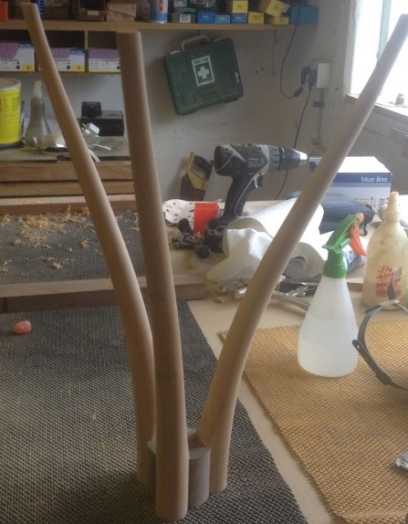

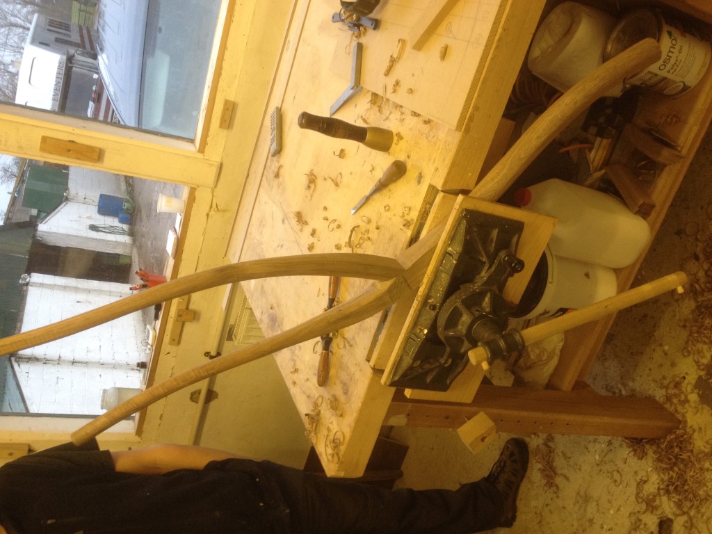

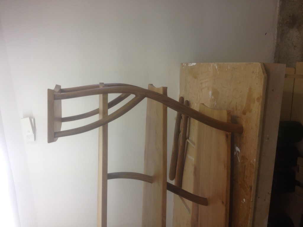

It will be used for cutting sheet materials and true 3d furniture components. (Ill post some images of the 3d stuff later)
