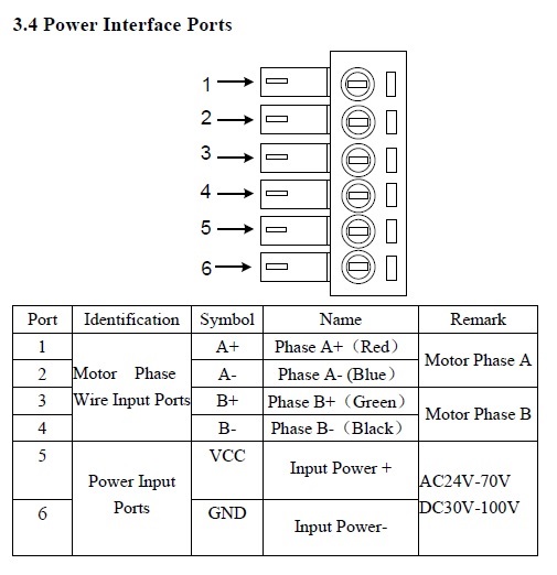

My drivers (JMC 2HSS86H) can be run with 24-70V DC or 30-100V AC.
Are you sure you have this the correct way round
Re: 2HSS86H Driver... AC or DC PSU?
This is from the manual but im still leaning towards going DC.
After all, its quite fun building the PSU... :smile:
Attachment 24825
JW1977
Attachment 24825
So yes you had it the wrong way round. I would up the toroidal transformer to 25- 0 - 25 which would give you about 70v dc when rectified . good vid here. https://www.youtube.com/watch?v=4OoQ...zD30sZjtp_VyqY

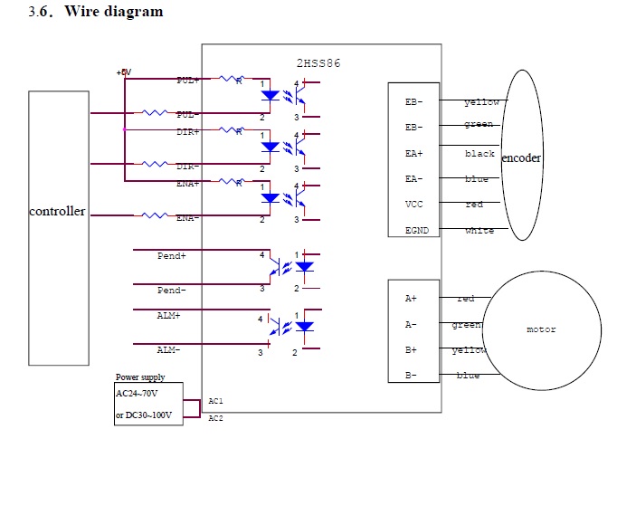

Ok, thanks but i don’t get where I’m wrong, could you please explain?
As i see it i have the choice to run them with AC and a PSU consisting of only a thoridal transformer.
The other alternative would be DC and a PSU with transformer, rectifer and caps.
The motors have 1,8 mH inductance so I figured a 48V PSU would be sufficient to get speed and reduce heat and back EMF.
Heres Another schematic where it says AC or DC as Power supply!?
Attachment 24826

Ok when I said you had it wrong I was referring to "My drivers (JMC 2HSS86H) can be run with 24-70V DC or 30-100V AC" you have the DC and AC transposed .
You indicated that you would be leaning towards DC.
You can have either a transformer with caps and a rectifier OR just a transformer.
Forget about the back EMF the caps take care of that ( there are caps in the driver as well) The heat is what you set the current to on the drive.
If you want speed for wood routing then a higher voltage PS is beneficial. I would go with 70V DC but your choice.
