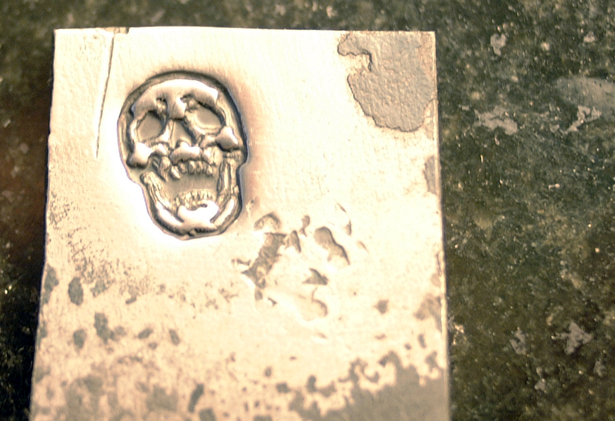

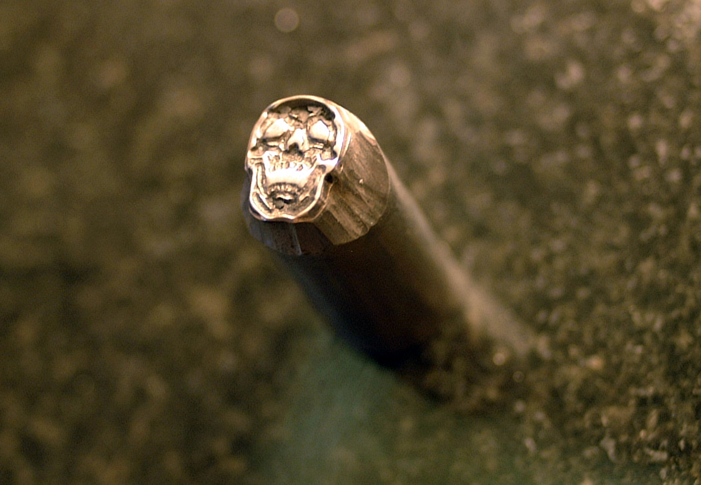

Anyone make these type of plates on the forum or have experience with fine engraving
 I've made branding irons for wood and stamps for steel, this a 10mm wide 01 Tool Steel stamp I made for a customer and the impression on steel
Attachment 25837
Attachment 25838
I did this work with a Contour Minor CNC milling machine driven by Mach3 and an old 12v Router CNC control box with no PP buffering.
I just sold the whole system for just less than the sum of it's parts cost with 5 Coventry Easy Change holders and six ER11 10mm shank collets, a 4th axis and a 30krpm high speed spindle :D
Mass and rigidity are your friends when machining fine detail

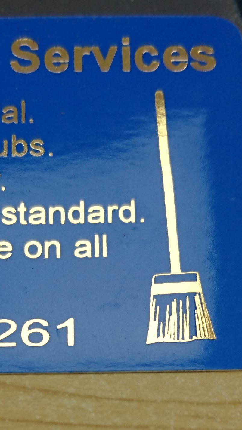

		I'm mainly speaking from my hot foiling experience, and some of the jobs I did.
The blocks/plates I used were magnesium, and used some kind of photo etching process to create them.
I've no doubt, CNC would be good for some jobs in hot foiling, but a lot of the stuff I did, I don't think so.
I have attached a scrap card, showing a broom head. I don't any other examples at hand.
As for experience, I was a CNC programmer/operater in the mid eighties, and after that, I worked for a CAD/CAM software house in tech support for 7 years. We had 2D and 3D products and an NC product, as well as surface modelling and FE products(I'm definitely no FE expert). While not recent experience, my son works in precision engineering and I have seen some of the stuff that can be produced. A model of the Jules Rime(world cup, not sure how you spell that lol) was very impressive.
