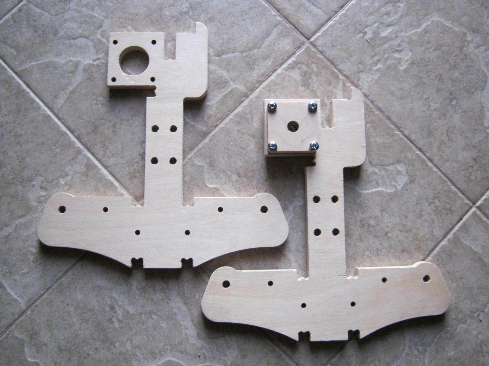

New gantry sides,made with this machine.
Attachment 5305

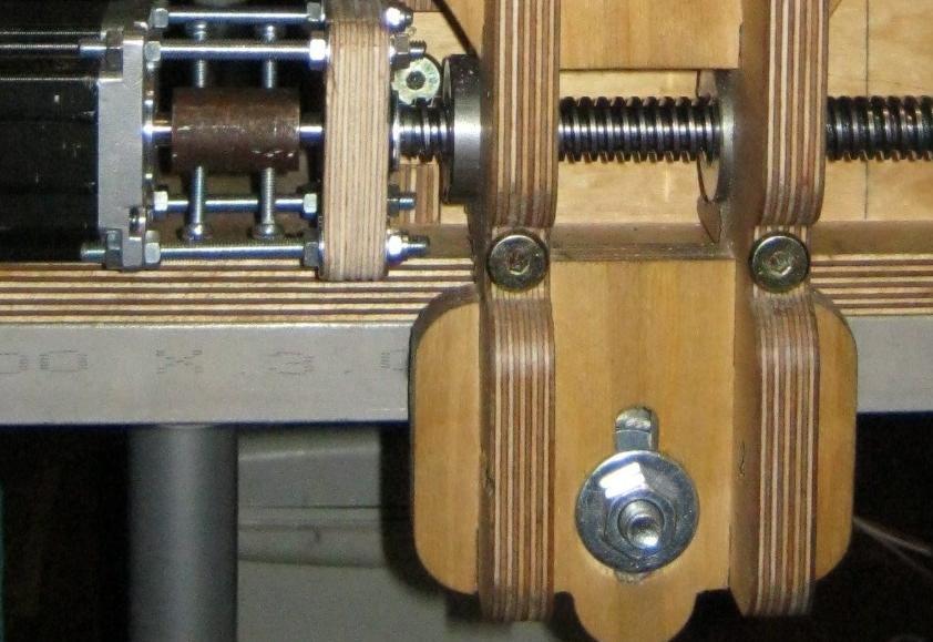

Two trapezoidal nut per screw
Attachment 5304

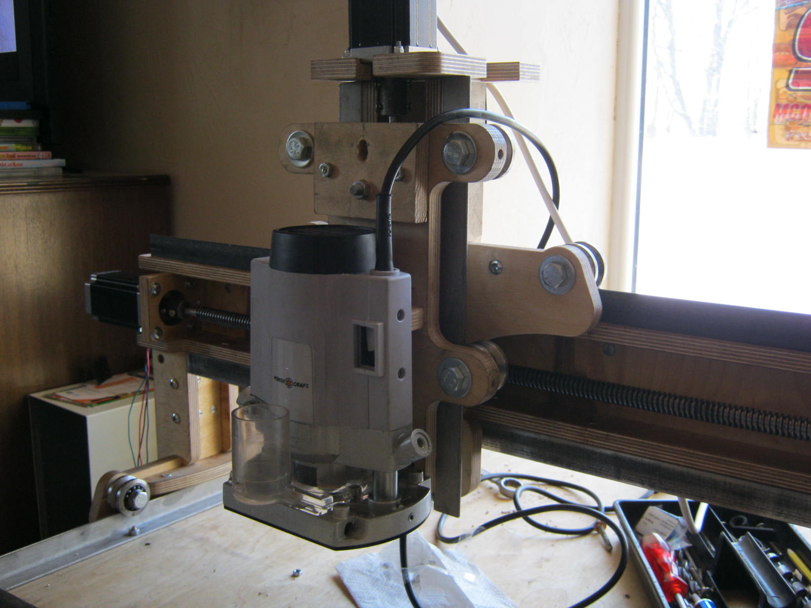

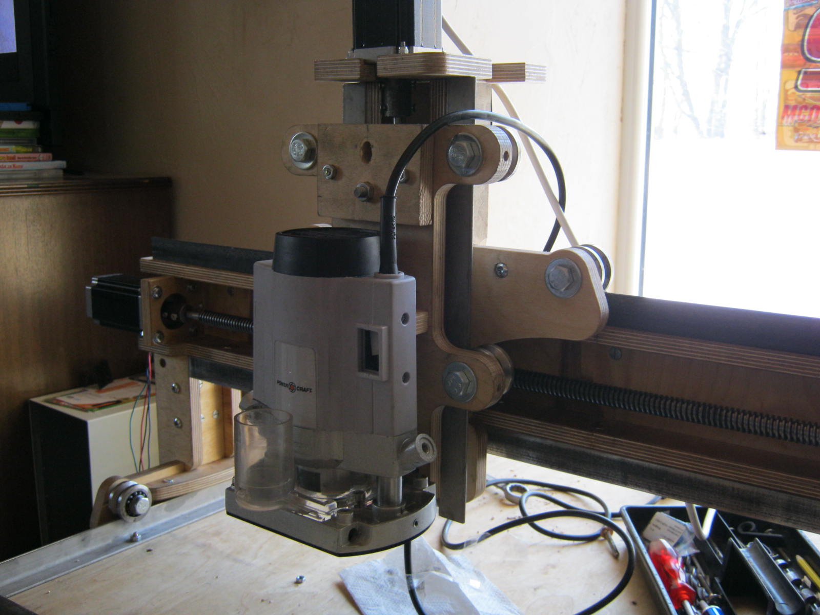

Router from hobby store
Attachment 5302

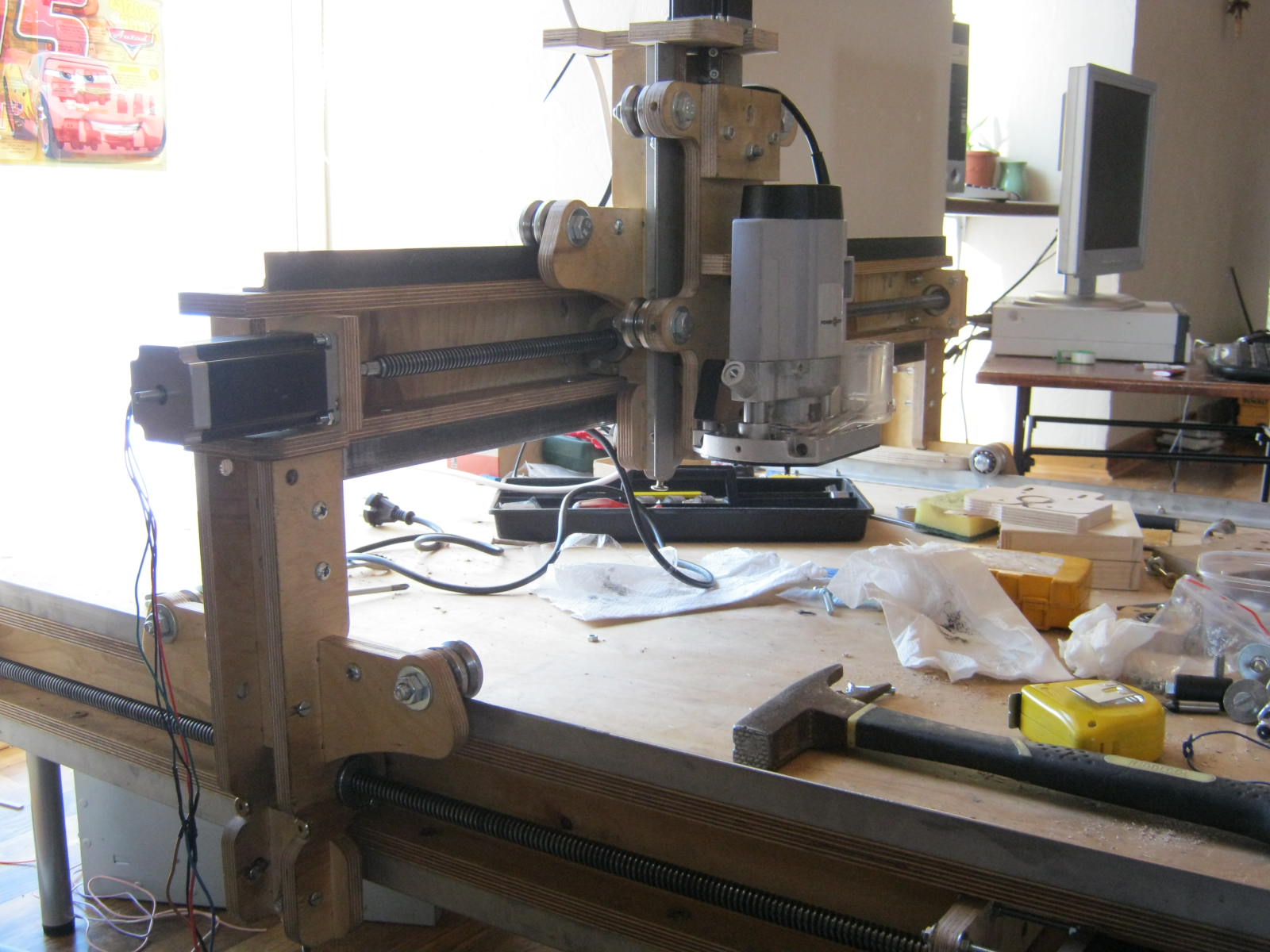

x-axis
Attachment 5303
Attachment 5306
Attachment 5307
Hammer,if something does not work :)
Attachment 5308
Trapezoidal nuts 2 per screw
Attachment 5309
