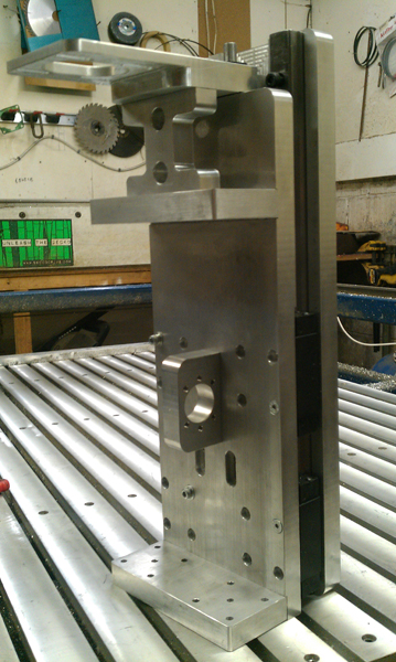

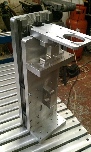

Ive just started a router build to see how much cash i can waste in the process :courage: . So I'm a CNC machinist by trade and converted my BF25 some time ago to CNC with Zap SY60STH88-3008B steppers and Gecko G540. I make airguns for fun and now want a router to make gun stocks from my 3D designs.
So Ive designed a router to fit the only space left in my garage , this is as big as i can fit ! , which has a cutting area of 830x530x90mm.

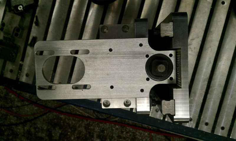

The base of the router is made out of 45x90mm extrusion with Y axis being 45x45mm bolted to the back of 20mm tool plate. Ive already machined the 20mm alloy tool plate for the sides of the gantry and the back plate for the Y axis which is wasted away to remove weight.
I'm fitting 20mm Linear guides to all axis which are being bashed and dropped to precision in the post on there way from China. The ballscrews are 1605 which have been sitting around for to long so will be put to use. The ballscrews will be fitted with Angular contact bearings on the driving end and a free floating bearing at the other.
The plan is to order the 60BYGH401-03 steppers from CNC4you which IL then fit to my mill and swap the Zap steppers over to the router which then have to be wired up with LONG cables ( about 20m needed ) to the PC on the other side of the garage. This is so i can run it from my PC , Mach 3 and G540 to keep the price down.
So this is where i need abit of help as i have little experience of machining wood. I'm running X and Y axis (maybe Z ) with pulleys and belts as i need to keep the machine within the foot print. Ive got to keep the 1605 screws and wonder which pulley setup would give me best performance for 3D milling , so i would appreciate some ideas
