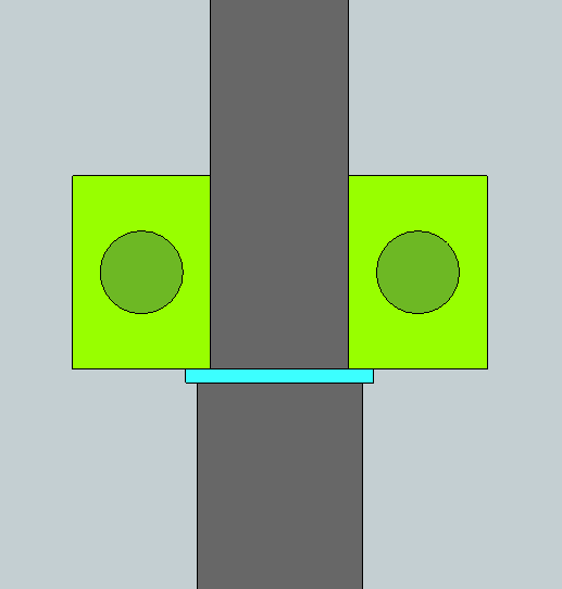

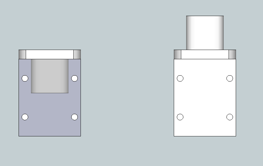

Gents,
excuse the rather massive thread attack, but I'd rather ask than be sorry later.
Any reasons why ballnuts are normally mounted inside a housing rather than bolted on top? See attached drawing.
Attachment 9220
I've got limited space between the rails, linear bearings and mounting plates and a 1204 ballnut fits nicely with it's 25mm depth. Anything over this, like a 30mm deep housing in order to fit the ballnut inside, will make things bad.
Second question is for a 10mm ID bearing on a 12mm ballscrew, doable? I know not enough material to hold the bearing in place, so I'm planning to use a circlip to rest the bearing on, again see attached drawing. Stupid?
Attachment 9221
Thanks in advance for any advice.
Regards,
dsc.

Unless I'm missing something very obvious the two drawing will take up exactly the same space.
It's the flange that controls how much room you have.

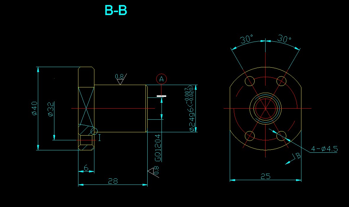

John, I should've attached a drawing showing the ballnut, this is something I got from Chai and it shows a flange which is 25mm deep. Perfect for my application, but looking closely at the drawing, you'll see that the 'barrel' of the nut is 24mm, which means there's 0.5mm radius difference between the outside of the round part of the nut and the flange. If I go with a housing that is 25mm deep and bore a 24mm hole in it to fit the ballnut inside, I'll be left with 0.5mm of aluminium on both sides, unless of course I make the housing deeper and I don't really have space for that, which is what triggered my question.

1) Hmmm, care to expand on why the bolts would be hard to get in?
Look at the drawing, and think about where the bolt head will go with the housing the wrong way around.
Re: ballnut housing and floating end ballscrew assembly
There's 28mm between the base of the rails and the base of the blocks. 1204 ballbut is 25mm deep, but 1605 is a whooping 40mm, so I'd need 12mm more clearance, it's almost like adding an additional 12mm plate just to get clearance. How do people normally get around this? is it packers / pockets and double plates to get more clearance?
The bolt head can go from the top on both versions of the housing, it's an M4 bolt and I have 8mm clearance on top for the head. Standard head on a caphead M4 is roughly 7.2mm.
Regards,
dsc.
Standard BS EN ISO 4762 spec caphead for M4 is 6.64 - 7.00mm dia.
There's 8mm to play with... seems to me there's plenty of room...
