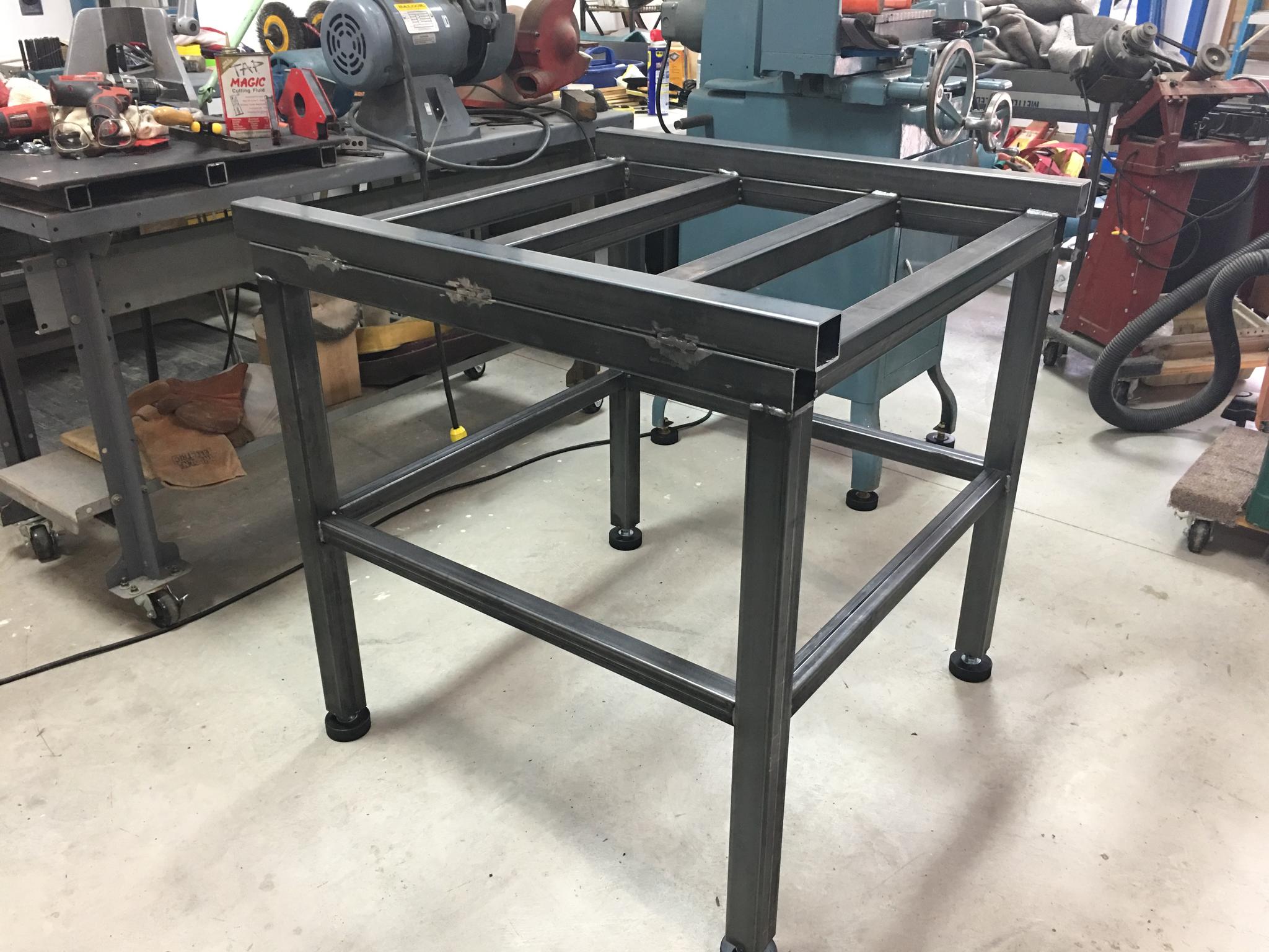

Decided I'm at the point where a build log is in order. Still looking at wood only, but would like to toss 3D carving into the mix. Table is built from 2"x2" square tube steel, 1/8" thick. I will be adding steel strips for more thread engagement where needed.
Ordered linear rails and ballscrews for Y-axis (X-axis?, still haven't figured that out) from Fred at BST. Trying the 20mm Chinese ones. Saving the 35mm NSK surplus ones I ordered before for a later project.
I know I'll get bruised up a bit for this, but I am somewhat "designing as I go". Getting handier with F360 though, so I'll finalize a gantry design before going that far. Here's what I have for now:
Attachment 22993
Ordering epoxy to provide coplanar place for mounting rails. Gantry thoughts are something similar to what Joe Harris is building. Looking at 1.5kW water-cooled spindle with ER16, 4 bearings, real HY VFD.
Questions:
1. More bracing needed? I am thinking of angled supports for top rails.
2. Any experience with the Chinese rails from BST?
3. What should I be thinking about now to avoid headaches later?
Thank!
Wallace

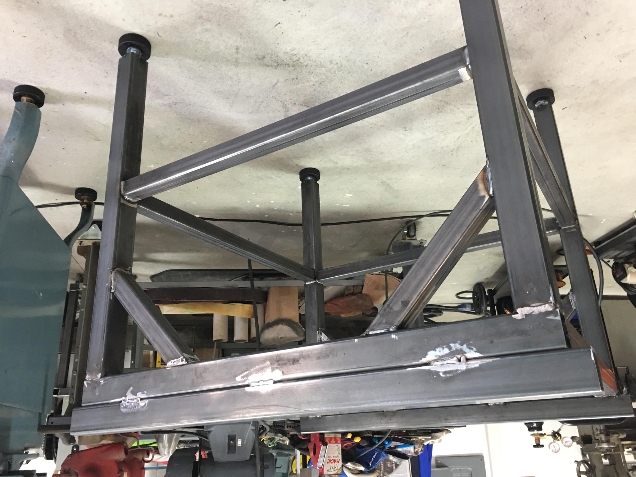

		Added these:
Attachment 23015
Epoxy should be here this week...
Re: 1st Build, Steel, Epoxy 24"x24" for Wood
		That's good in front to back direction.
Side to side could use some diagonal lovin aswell ;)
What epoxy have you ordered?
Skickat från min SM-N910C via Tapatalk
		Yeah, you're probably right. Sigh, I never thought I'd get tired of welding!

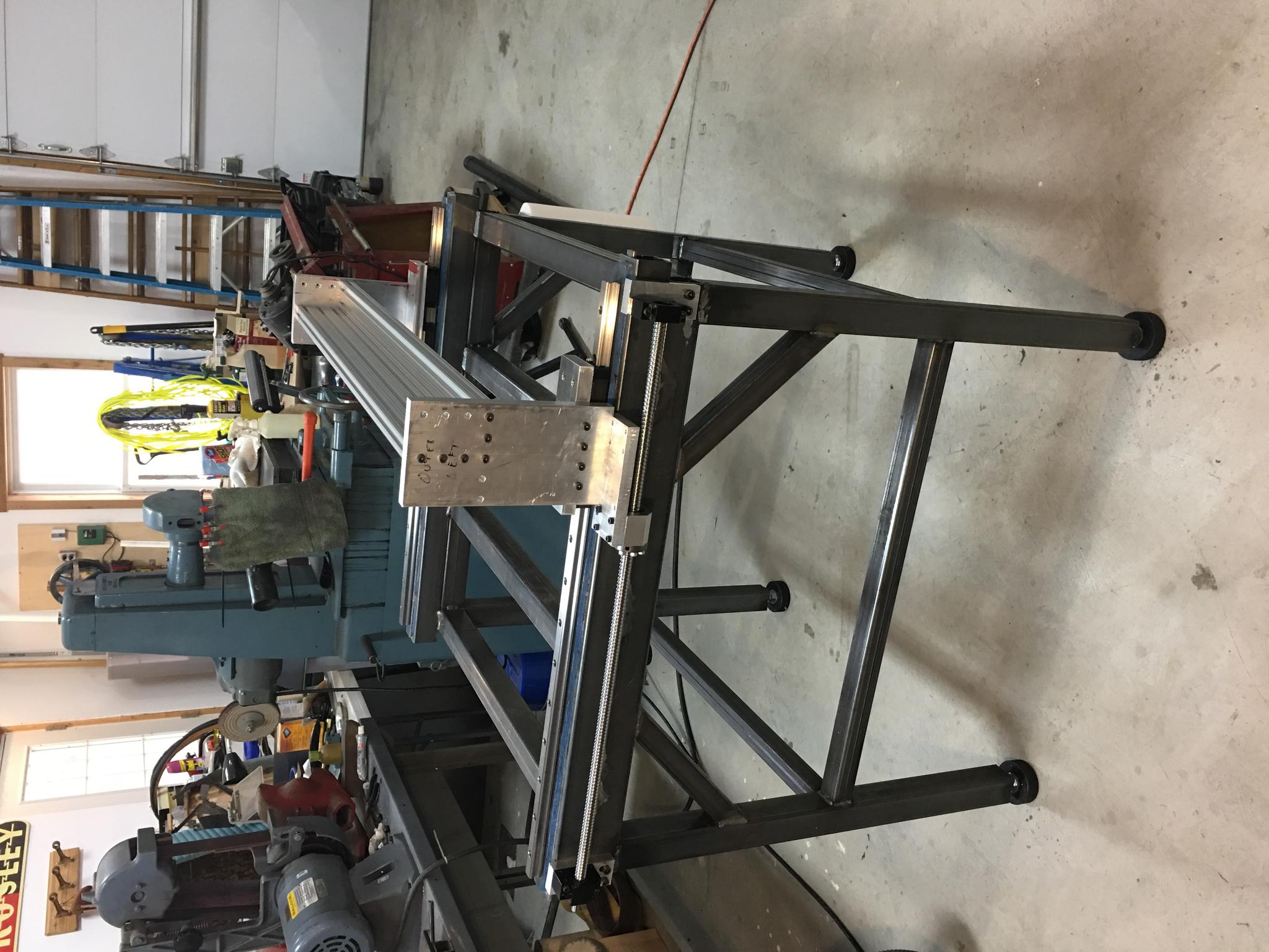

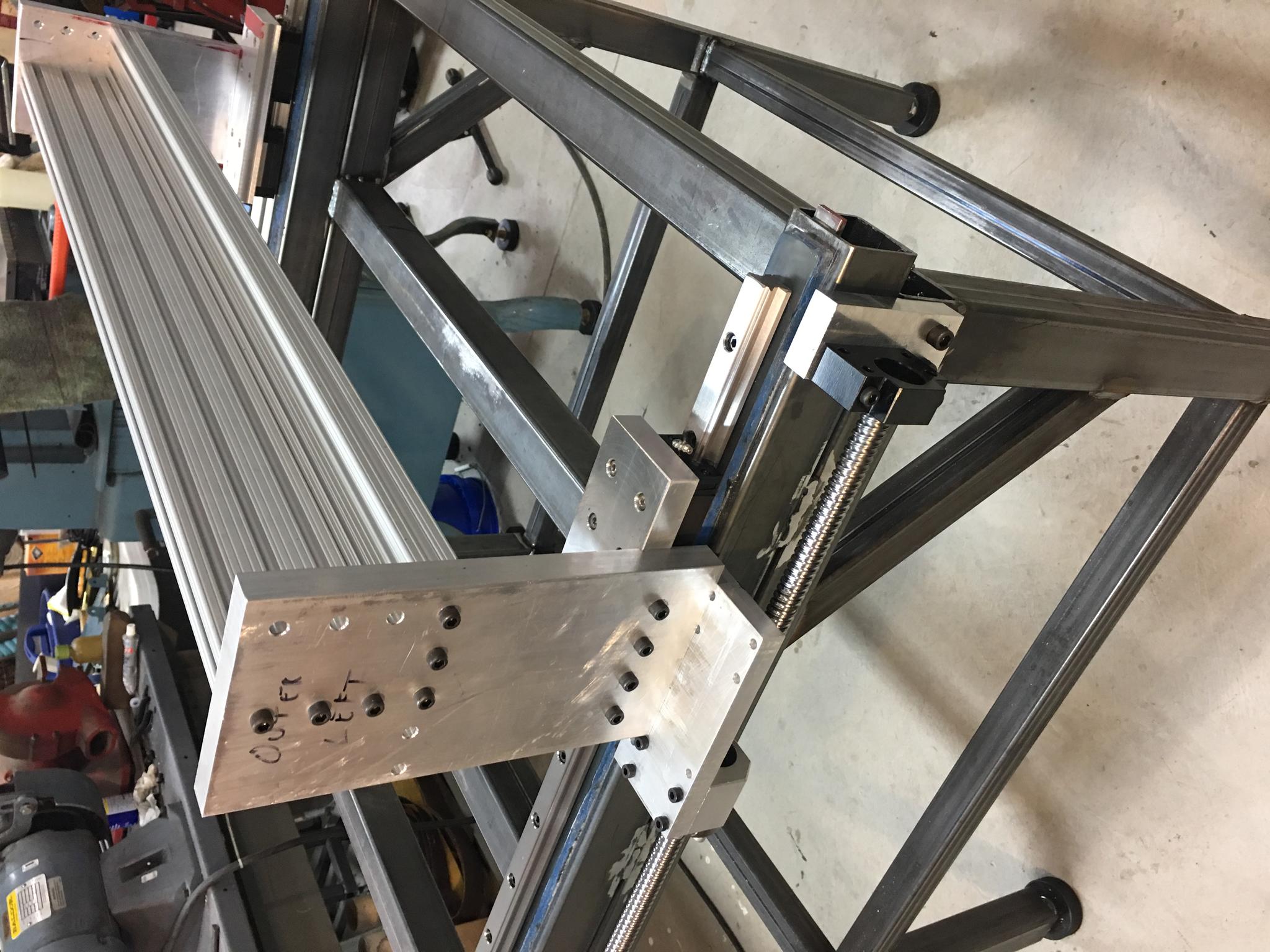

7 Attachment(s)
		Wow! I was thinking it had been over a year since I last posted - but then realized the dates are DD-MM-YYYY and not MM-DD-YYYY! Anyway, got sidetracked somewhat with a surface grinder I picked up at auction. That, along with a surface plate and measuring tools pulled me into the world of tenths. A scary, but fun place. I like This Old Tony's description of his surface plate: Where dreams go to die... Anyway, gotten back to the router recently:
Attachment 23704 Attachment 23705 Attachment 23706 Attachment 23707Attachment 23708 Attachment 23709 Attachment 23710
Now, I know it isn't pretty. Please keep in mind my goals for this are to learn and gain experience. I would like it to cut wood at a reasonable (woodworking) level of accuracy at some decent speed, but I'm mostly having fun and building skills and knowledge to make a better one after this - if I decide I want to.
I just ordered rails and ballscrews that are 50mm longer than the ones in the pics. I intend to move the existing ones to the gantry and put the new ones in their place. This should give me bit more travel and get the ends out where I can get pulleys on them. I am thinking of driving the two Y-axis screws with a single NEMA 34 and timing belt arrangement. The X- and Z-axes will be NEMA 23.
Can I get opinions on this kit: https://www.ebay.com/itm/FEEE-Ship-3....c100005.m1851
I'm leaning towards a Centroid Acorn controller.
So, given the above, I'd love some input, guidance, even criticism.
Thanks,
Wallace
