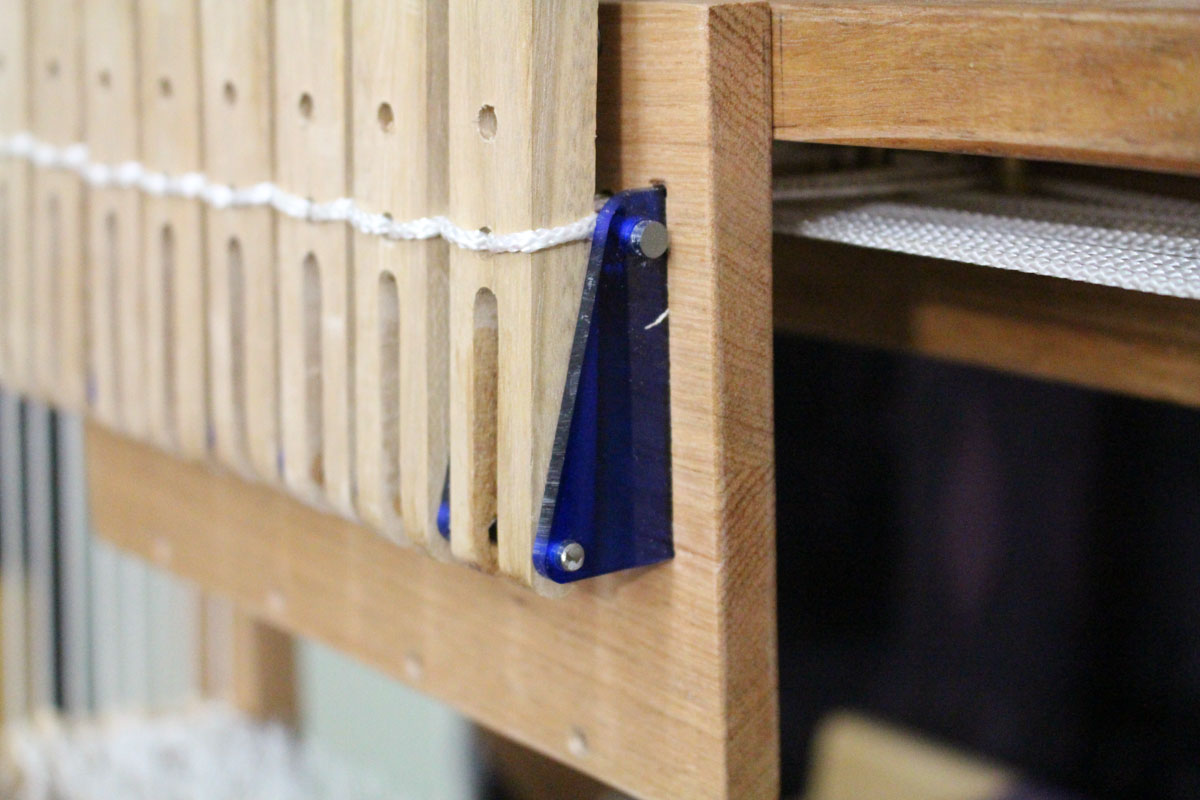

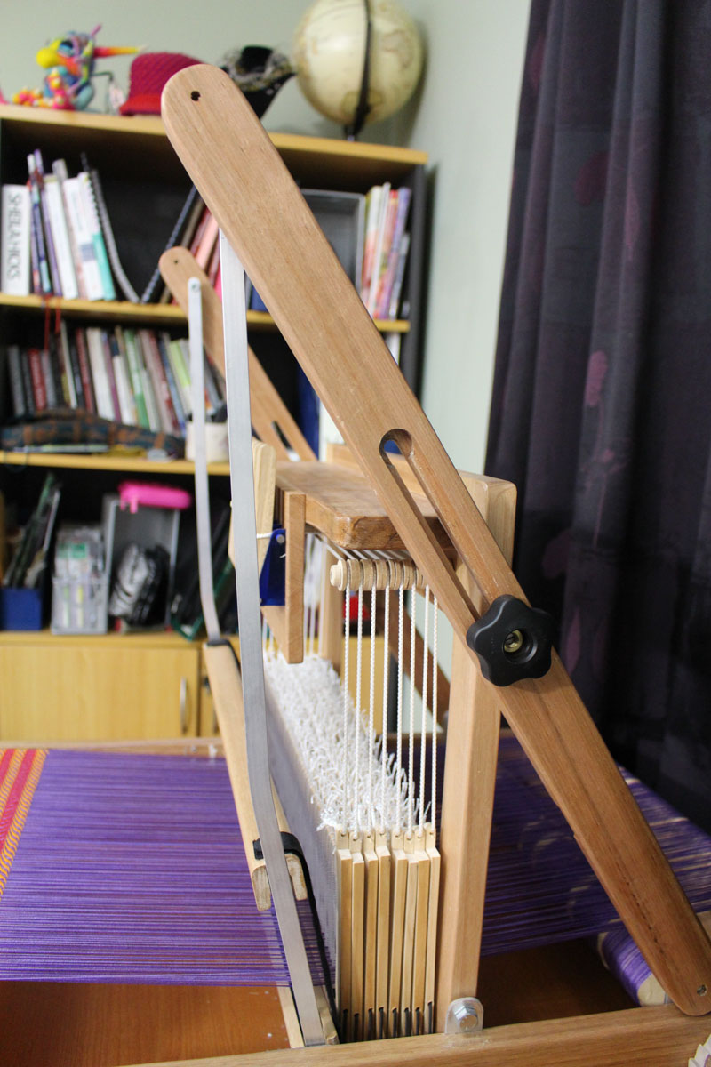

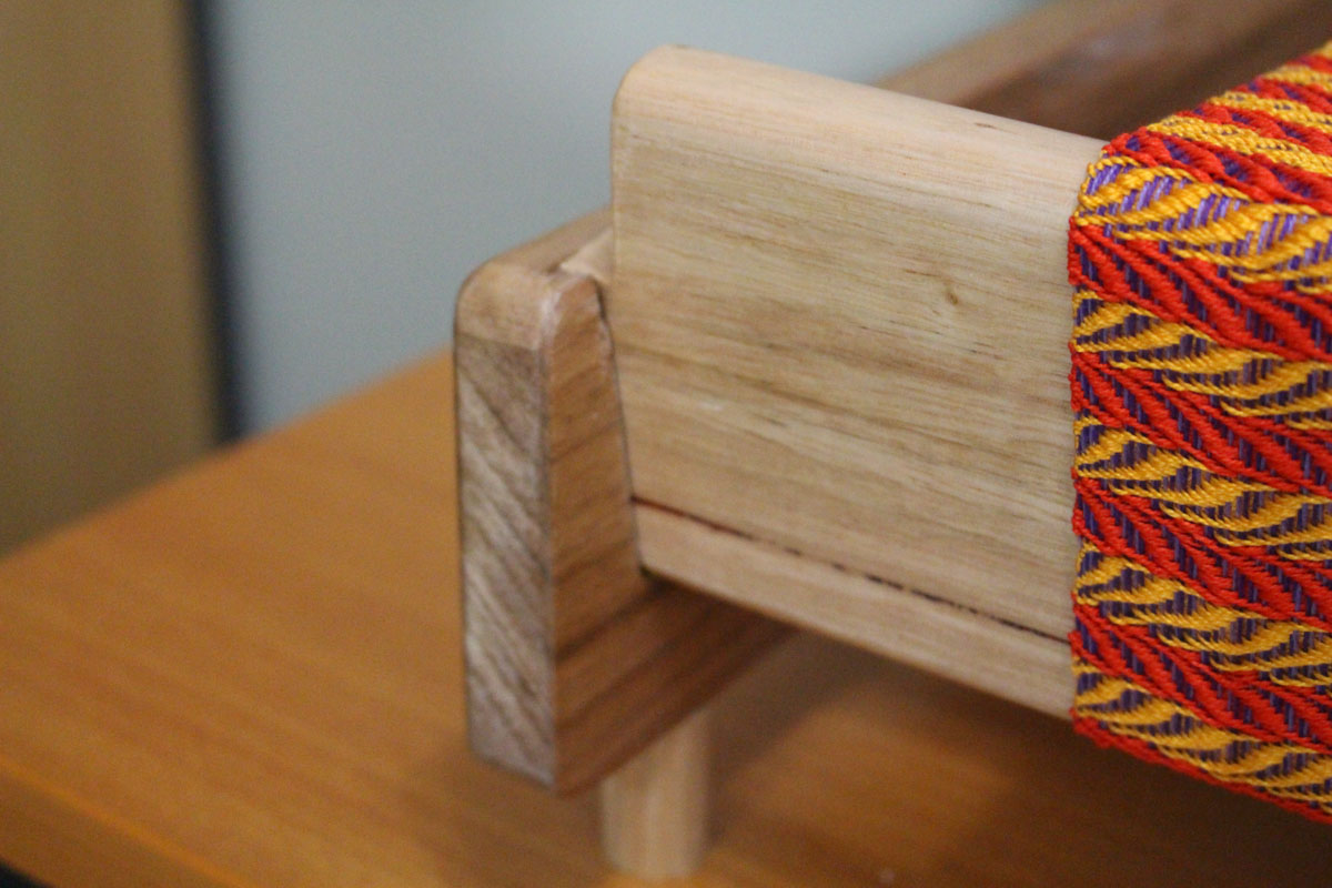

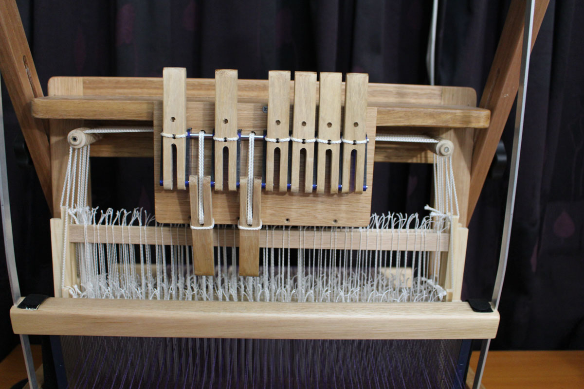

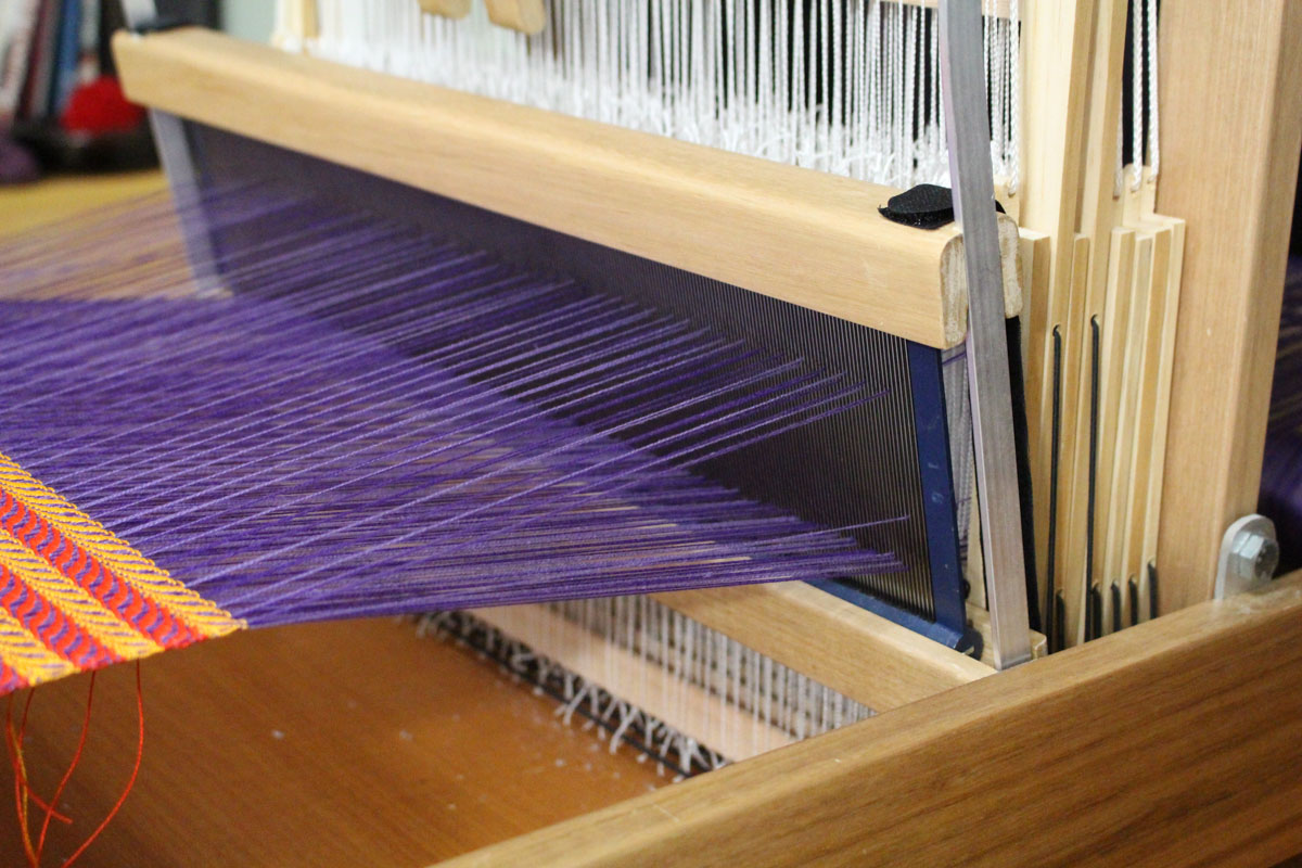

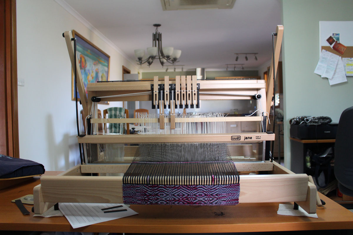

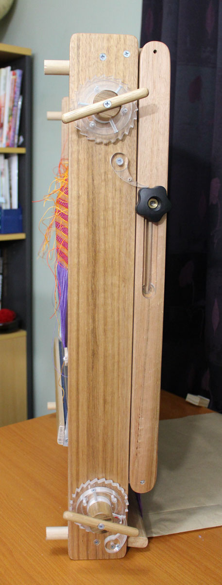

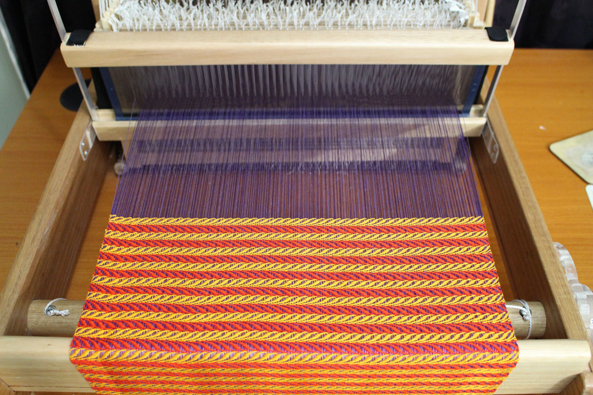

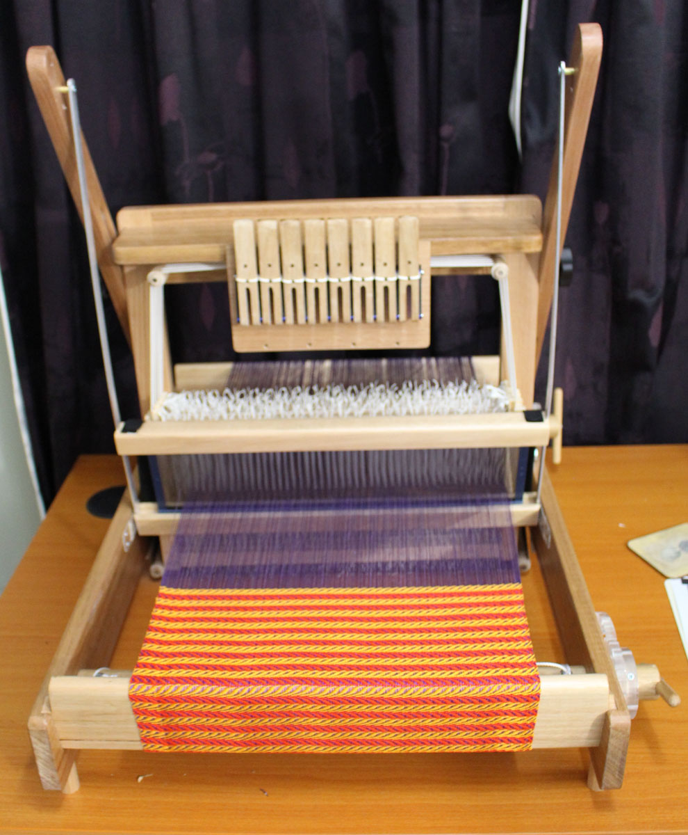

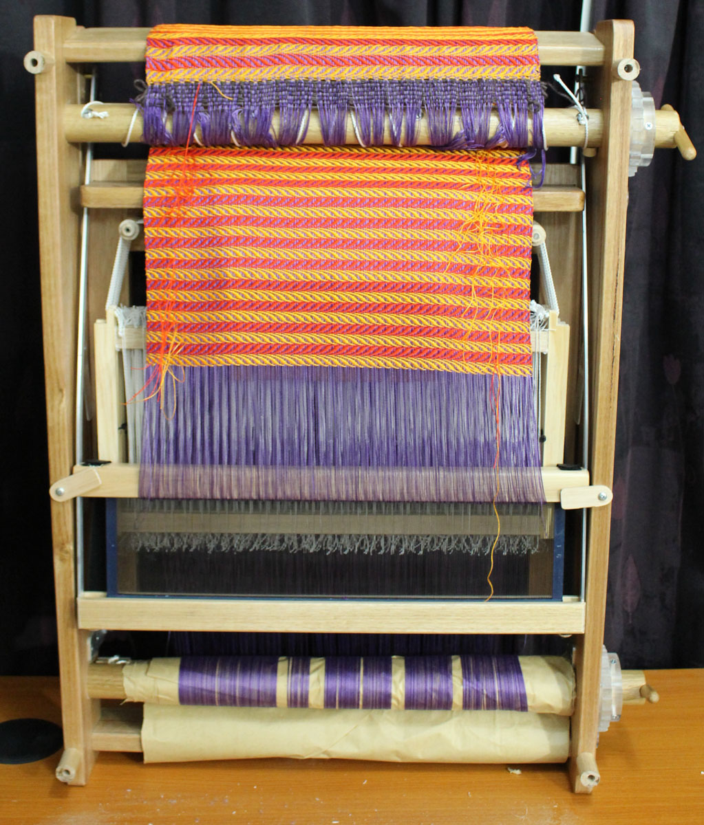

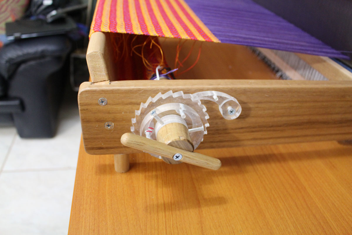

My most recent project, the reason the new clock hasn't got very far, is a table-top weaving loom for my wife. She already has a 70cm wide folding model made by Louet but wanted the 40cm version as well due an accute attack of OLAD (Obsessive Loom Aquisition Dissorder), a common afliction among dedicated weavers. Rather than force her to save up the considerable asking price I decided to build one for her as a Christmas present. It wasn't quite finished in time but is now working nicely.
The design is a blatant rip-off of the original with changes to cope with it being a one-off DIY project without the fancy moulded parts and I changed the sizes of timber used to match the range of DAR Tasmanian Oak available from Bunnings Warehouse. One of the reasons for it not being finished in time was that production could not start until after a visit to Perth in November from which I returned with the car stuffed full of a 12 inch bandsaw and and a surprising amount of timber which left no room for passengers. The wife and her mother flew there and back anyway so I was safe!

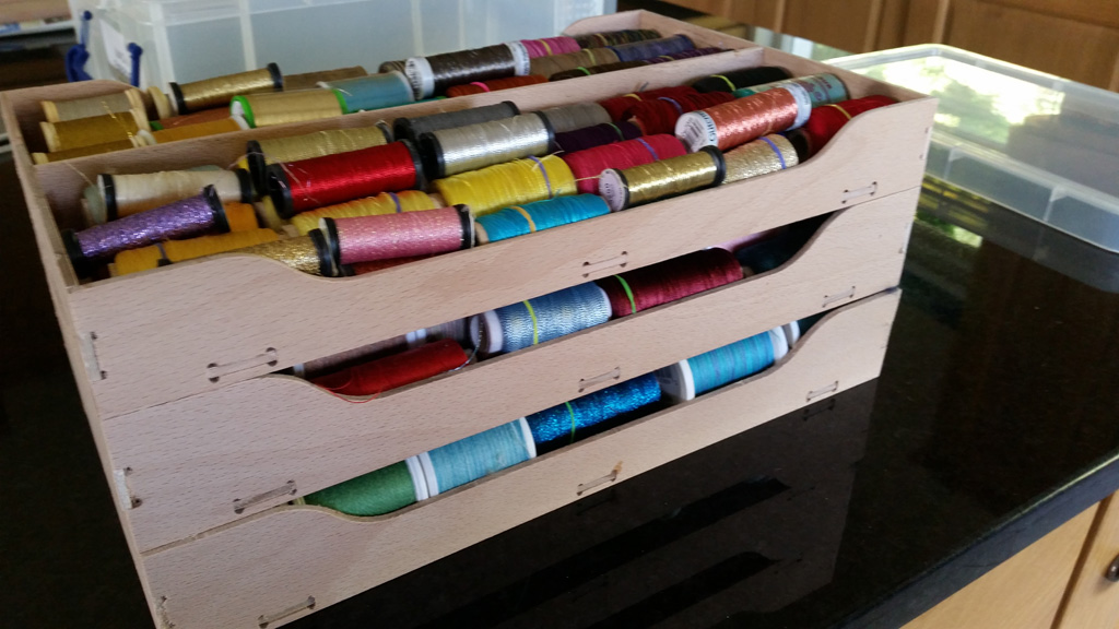

My wife is an embroiderer/felt maker. I also earn brownie points by making odds and sods for her use. These are typical of a set of trays that I made to fit in the widely-available range of "Really Useful Boxes", of which she has quite a lot.One of these boxes full of reels of thread wastes a lot of time whenever you are looking for one in particular so I designed and made the stacking trays. I like using the tab-and-slot method of construction, and I try to ensure that all loads are taken mechanically by the tab design. These ones use small dabs of superglue just to stop them falling apart although there is little load taken by the glue. Each tray has a slot in the base plus matching cutout in the central divider so that the handle on the one below has somewhere to go. This is also helps when you just have them stacked on the table as they don't slide off each other. Top tray in each box doesn't have the projecting handle just so it fits in the plastic boxes. I designed them in Fusion 360 using parameters for key dimensions so that it is relatively easy to create the different sizes. I worried a lot about corner clearance in the slots - can't make square corners with a round tool - and eventually settled for the fillets as seen here. Other projects have used a smaller cutter and so the corner fillets are a little less obtrusive. However, these weren't designed with aesthetics high on the agenda - more "what can I knock up quickly!"
Attachment 27353Attachment 27354Attachment 27355
Really, this kind of thing just emphasises my point about how useful a CNC router is for fairly ordinary projects - would have taken ages to do something like by hand.

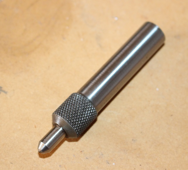

I like the engraver holder, very neat. For the benefit of other readers, I bought an engraver tool which already includes the springloaded holder and fits into a 12mm collet. Just remember NOT to start the spindle when using it.

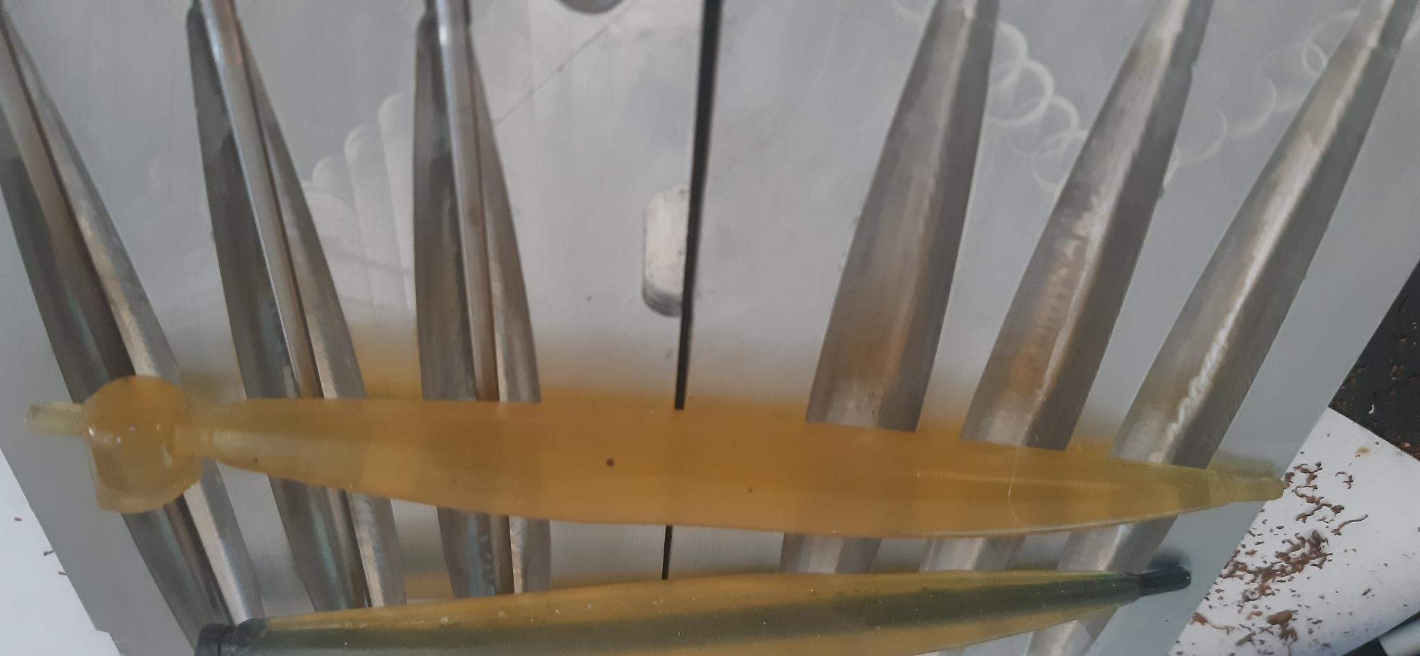

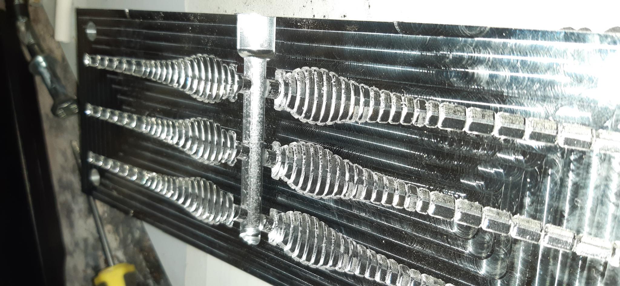

I have been machining moulds for making fishing lures. I am well impressed with the improvement after fitting digital stepper drivers and moving to UCCNC.
These tools still scare me though.
You are going a bit too slow and the tool stick out is way too far. You'll get an even better finish if you lower the stickout and up the feed.

The cutter is a 2mm extended neck ball nose and the 4mm shank is flush with the collet. I have to use a 20mm long tool as the next size down (10mm) is too short. As for the feed rate I run them at the recommended 210mm/min but in this case as the slot is only 2.059 wide I prefer to reduce the feed

OK I understand with the shank but if all it's doing is the finish pass like what your showing then you could easily go well past the recommended feed rate as the WOC/DOC is so tiny. There is hardly any tool pressure on it so it's not likely to break.!
Regards the Slot then I'd Cam that up as a separate feature because what's the point of slowing the whole job just for that one area where you need to be careful.?
Recommendations are ok but you have to assess to each job and I can see that your slowing the job down and probably getting a worse finish because of it due to running too slow. Will be worth you experimenting with Feeds and slightly different strategies for areas like slots etc.

The video is actually the roughing cut and at the speeds and feeds I am using I get a good enough finish that I don't bother with a finishing cut.
The reason I am machining the slot and the blend radius is in places the radius is too deep to cut with a standard cutter. What I do is cut as close to the slot as I can with a standard cutter then finish the blend radius while I am cutting the slot.
I have been quite suprised how much these extended cutters will bend before they snap.
