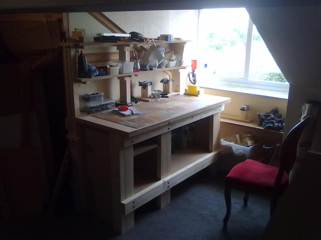

		@Irving: The best way I can answer that is "no idea". I'm in the end-terrace for a row that go back about 100-odd years. I suspect they were built with the attics as habitable by design. Ours has actual stairs that look like they were meant to be there, and I note that all the other houses left from this row also have dormer windows - though ours were replaced with a bigger dormer at some point.
Attachment 6682
I've stuck my reloading/"clean" bench there for the moment. Well, I say "for the moment", there's no flippin' way I'm moving it. All the benches are designed with no removal strategy other than 30 minutes with a chainsaw :whistle:
@Jonathan: Oh if I could get away with it I would be entirely up for it :D
@Michael: I've identified which ring it is on and what sort of loads I expect on it, so I am quitely confident. Quite quietly. Whisper-like, perhaps. In fact you might need a medium with a ouija board to hear my confidence, but it's there.
Re: Mains, PSUs and other goodies.
		On a sidenote, I was rather surprised with the workbench in that photo. I put a PC on it to test something and the whole thing vibrated like a drum. I didn't really worry about sound when I built it because it's not for "noisey" stuff, but I didn't expect it to amplify the vibration and it felt like it transmitted it straight into the structure.
Lots of experimenting to be done with isolating and dampening, I think.

 Nice bench and a period chair too ;)
You should lift a floorboard or two and check the joist dimensions before you load the floor too much.  A typical 100y old house would use 4x2 joists in the attic (my son's from 1903 does), they were never designed as habitable space but for light storage, tho it could be used for 'servants quarters' in larger houses, but the loading assumed very light (no heavy wardrobes etc.).  Building regs differentiate between ceiling joists and floor joists.  A 4 x 2 ceiling joist at 16" centres spanning a maximum of 8' (the width of a small room below) will support a dead load of no more than 500N/sq metre, an imposed (i.e variable) load not exceeding 250N/sq m and a concentrated temporary load not exceeding 900N.  I'd hazard that you sitting at your substantial workbench is close to exceeding that.
Building regs do not allow for more than 1250N/sq m loading, above this they need structural design/calculations agreed by building control - this is why you need building control approval for loft conversions, especially where there is a wet room or bath installation (a full bath of water with a typical male in it is close to 2500N/sq m loading).
Again, don't want to be a spoilsport... but you don't know how the timber has faired over the years and it would be unfortunate for your new CNC build to end up in a crumpled heap on the floor below!

irving2008
 If by period you mean "absolute pain in the neck for most uses" then yes. There's a stool around there somewhere that I use, but occasionally the lower seat lets me get adopt a more stable position leaning on my elbows, holding whatever I'm working on right up to the face.

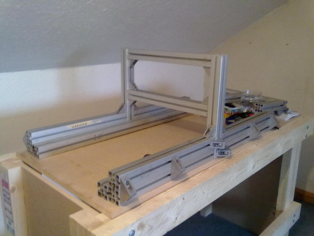

 Ahh yeah, forgot to mention. I suppose this won't be helping either?
Attachment 6683
Except now it's got a 2m long double layer of MDF (that was only a temp worktop for the picture) and a pillar drill on it...
