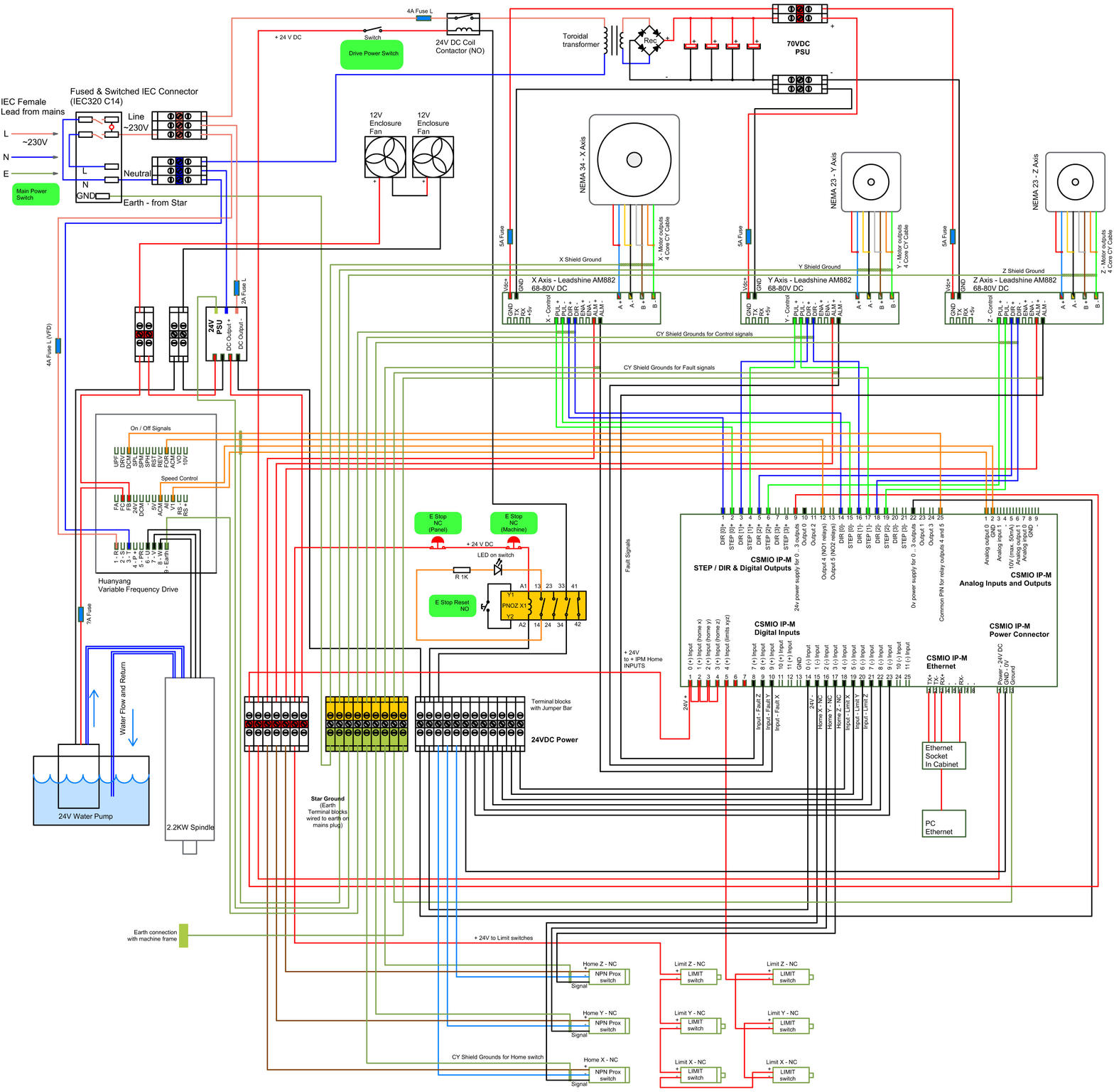

Joe... That diagram is a beauty!
Don't know if everything is right but it shure is pretty :D

I removed my 12v supply and simplified everything to run off the 24V supply. Just need to pair up 12V devices in groups of 2 in series . E.g. 2 fans or fan and motor
Less things to go wrong and less space required in the box
Also I'd add a switch to the water cooled spindle pump - looks like it will run all the time which will be annoying plus may heat the water a little
I have a 12v supply on order but it was only cheap. Clive has also suggested running all from 24v. I already have two 12v fans but could get one more and run in series with the 12v pump I guess. I was going to use a mcb instead of a fuse for the pump so I can switch it off with that?
No he's running it thru the VFD relay so will only run when the Spindle is ON.
Joe: Is this different scheme to the ones you've been sending me because don't remember seeing 12V in there.? Thou must admit was only looking at the parts you asked me about.
Anyway dump the 12V and wire the Fans in series and buy 24V pump.
I would not run a 12V fan and 12V pump in series as they would be different VA's therefor they would not give a 50:50Quote:
V divider
It's a new addition because I have a 12v pump but not a big deal - a 24v pump will be cheap enough in the scheme of things! You are right about the VFD switching the pump on so guess being able to switch manually on the mcb will not be all that useful.
How about this one: https://www.ebay.co.uk/itm/172219861161
Ah, ok thought was unusual for me to miss something obvious like that.!
Yep, that pump will be fine.
Regards the MCB then don't really need MCB but the suitable fuse is required to be safe but only in case of short it's not something you'll use has a switch.
The VFD Relay will handle this for you and because you'll only ever run the pump when the spindle is spinning you'll have no need to manual overide.
The 12V supply has gone!

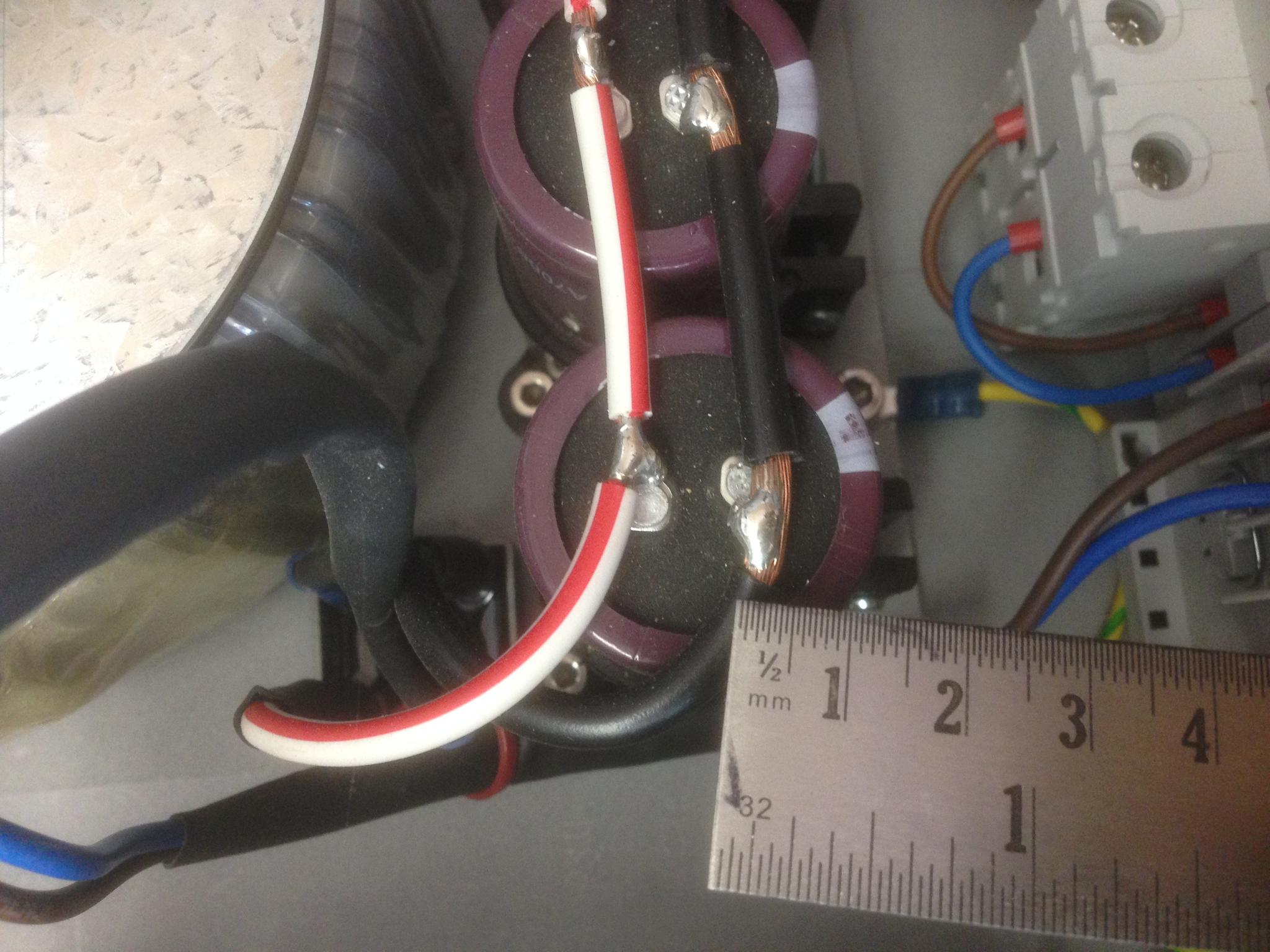

It is hard to see from the pictures, but please check soldering of the capacitors.
