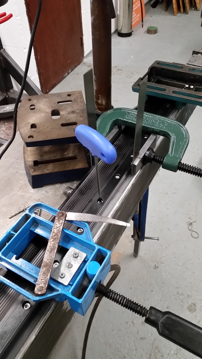

Quick vid showing the drilling with the guide in place, I've not showed setting up to drill a hole as I'm sure that's pretty self explanatory...saying that so is drilling the hole...oh well :whistle:
The pillar drill is a bit old and knackered and I think could do with a little TLC....
https://www.youtube.com/watch?v=HBGuVm6FQKs

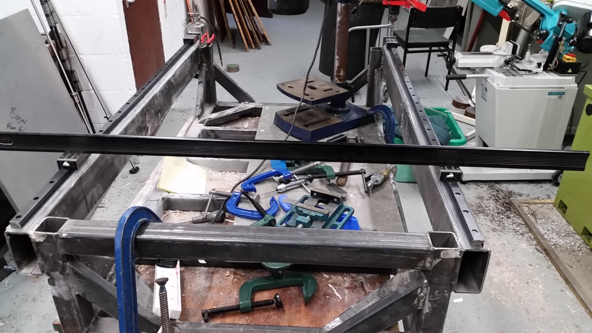

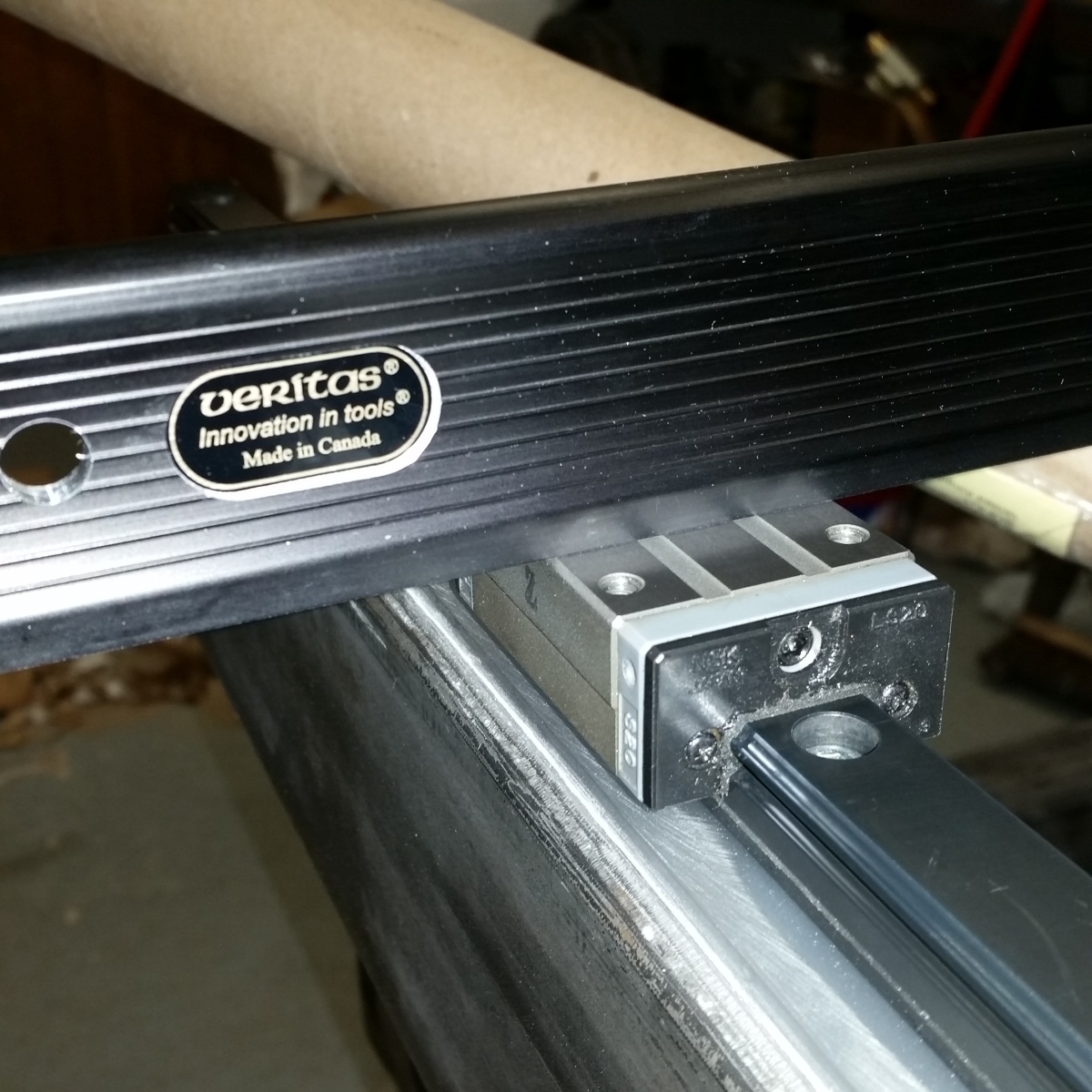

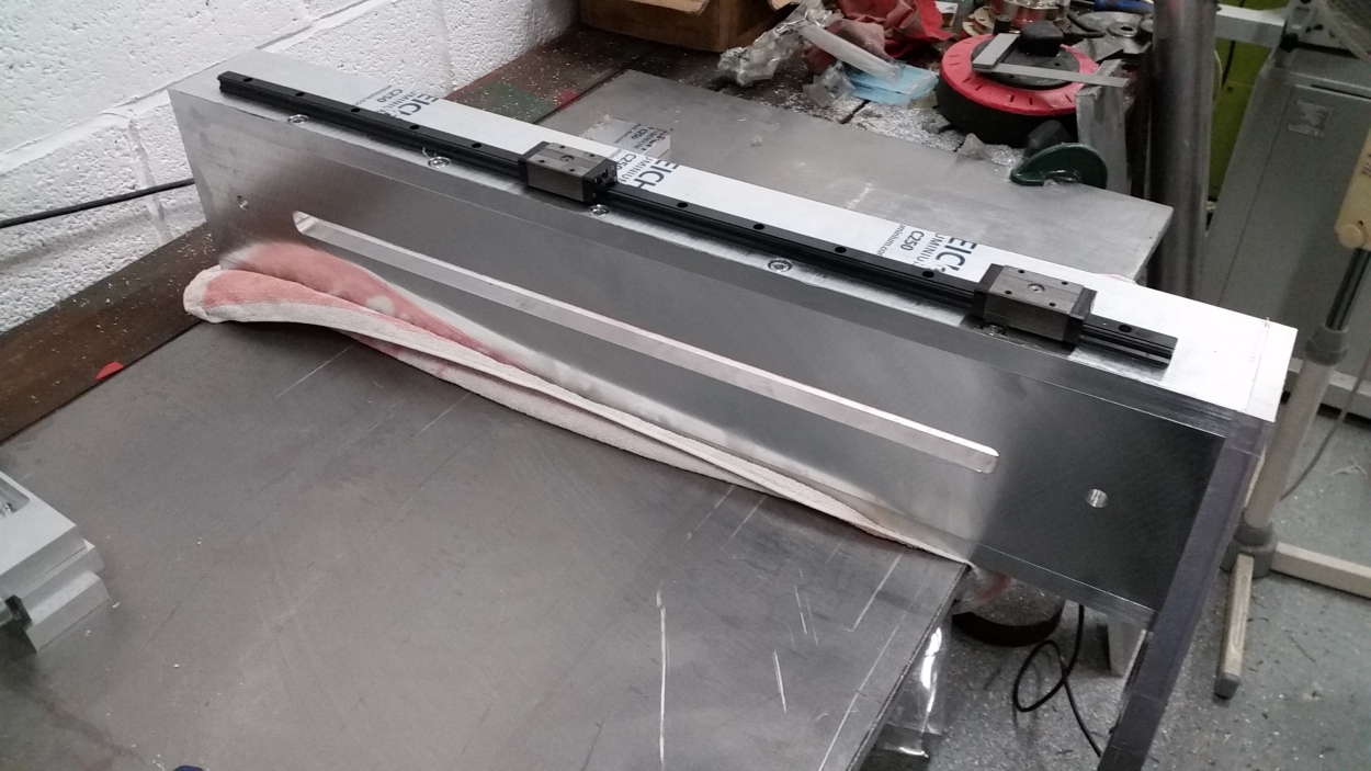

Did a bit of shopping on Friday and it turned up today :eagerness: I bought a 1200mm Veritas straight edge, a couple of 6" engineers squares and 4 100mm G cramps.
Placing the straight edge against the rail there was a bow in the middle of the rail of about 3 thou so I loosened all the master x rail bolts and clamped (lightly) the straight edge to the rail in 6 places. I then tightened the bolts checking with a feeler that there was no gap between the reference side of the rail and the straight edge. Once this was done I placed the straight edge on the reference side of the rail and tried the feeler gauge again. It was the same all the way down with no gaps so I'm happy with that. I'm going to clamp (lightly) the straight edge to the rail again and then one by one take out the M5 socket cap heads and threadlock them in. This should give me my master reference X rail to set the second X axis rail from.
Attachment 14399
I wanted to see if there was/how much twist there is in the rails. Placing the straight edge across the two rails on top of the carriages I tried to get a feeler gauge underneath the edge and couldn't. Shone a light from the other side and couldn't see a thing so it looks like the epoxy has done it's job in finding the level. Again I'm happy with that!
Attachment 14400
Attachment 14401
Waiting on my Tooling plate to come before I square the second X axis rail so I'm just making drawings so I know where I'm drilling holes, machining pockets for steppers ballscrew housings etc, what size belts and pulleys to get etc. etc.

Surely the twist will be sorted when the rail is bolted tightly down, that's assuming that the epoxy is perfectly flat of course?
Quite likely yes - but how much force will bending the bearing to 'flat' impose upon it? The answer is a lot, since the stiffness of these bearings is still very high in the rolling direction. It also depends on how stiff the gantry is and how wide it is - something has to bend. A fairly high force wont make much difference to how smoothly the bearings roll, since as I mentioned in the last post their co-efficient of friction is very low. It will still shorten the life of the bearings though.
It's different with round rail bearings - clearly they have zero stiffness in the rolling direction, so angular misalignment doesn't affect the force of the bearings (within reason).
If you look in the datasheet for the rails and bearings you'll find specifications for the maximum linear and angular misalignment. These are based on getting the rated lifetime out of the bearings, so if you exceed it by a little, the bearings just wont last as long. Though on a home machine it might still outlive you!
njhussey
That's a good indication that they're close, but since you've got the straight edge you might as well measure it carefully. The issue with what you just did is it's hard to measure very small angles and you don't get a reading for what the angle actually is. Instead you need to do something like in my build log - stick the dial indicator on one of the bearings and mount the straight edge parallel to the rail, but some distance (say 200mm) horizontally away from it. Make the indicator touch the straight edge, with it's movement perpendicular to the surface. That will convert the angular reading into a linear reading and amplify it. You don't need to worry too much about getting the straight edge level, as if you plot the readings on a graph that will just make a linear error which you can subtract.
Just out of interest, how much did the straight edge cost?
I'm not too worried about the life of the bearings, as you say I'm sure it will outlive me and for what it's being used for. I will measure it though out of interest as I have the straight edge ...
The straight edge was from Axminster http://www.axminster.co.uk/veritas-a...-straight-edge it's got a claimed accuracy of 0.075mm over the 1270mm length which although not super accurate is more than good enough I think for my purposes.

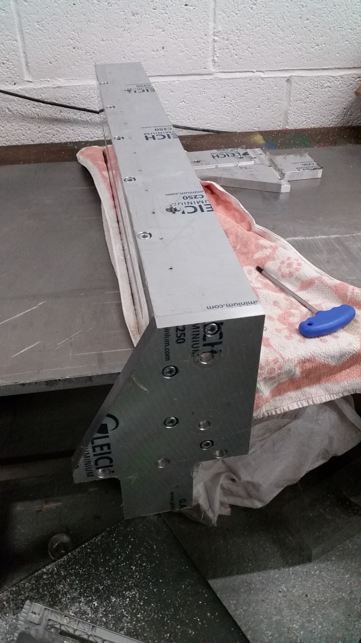

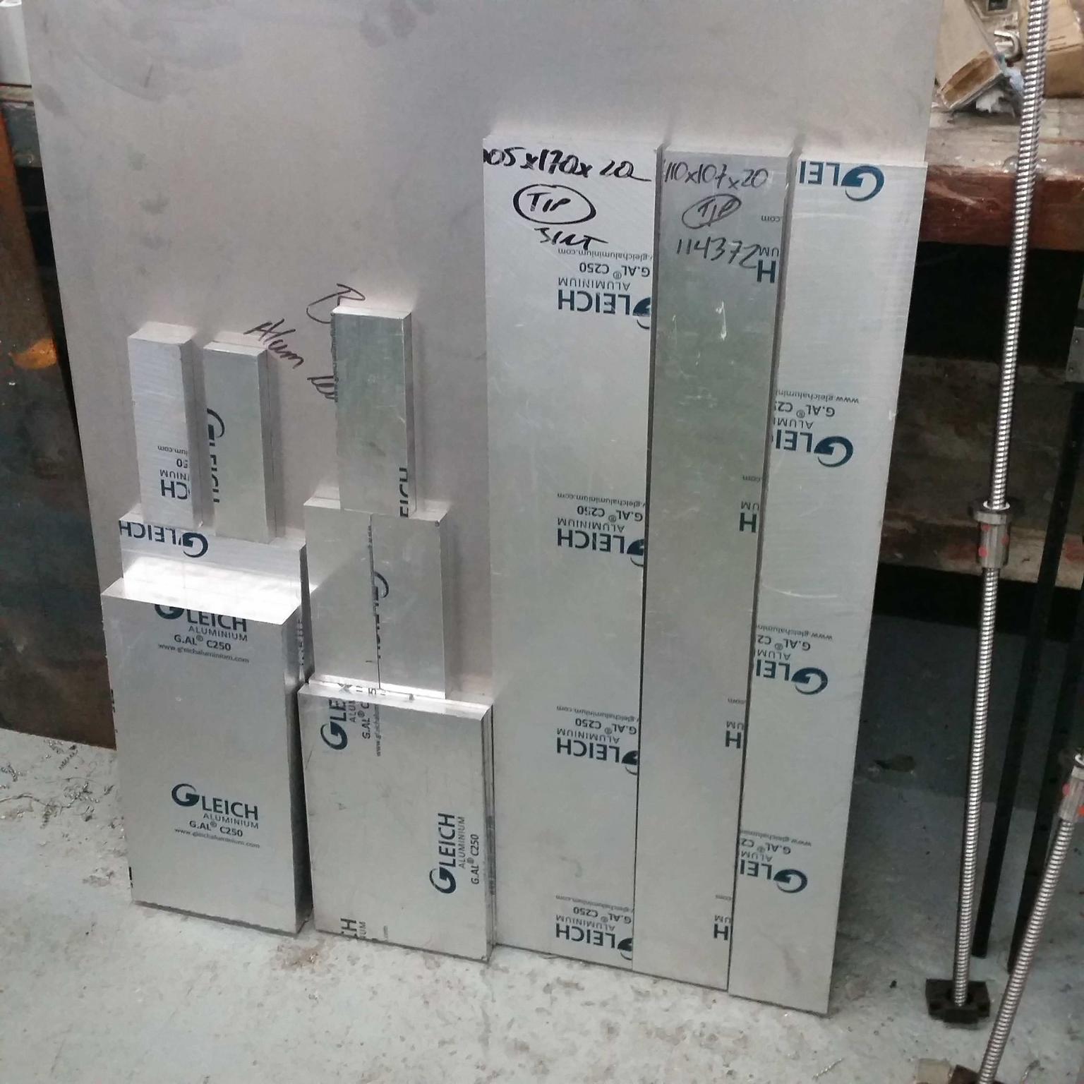

Picked up the cut tooling plate just now....gantry build can start next week though first got to design and build a pantograph arm for putting in M6 UNC bolts and grease nipples into 1000 units we're currently assembling for a contract....oh, that's after I've finished machining a custom unit that's just been ordered. Work keeps getting in the way of playing!
Attachment 14438

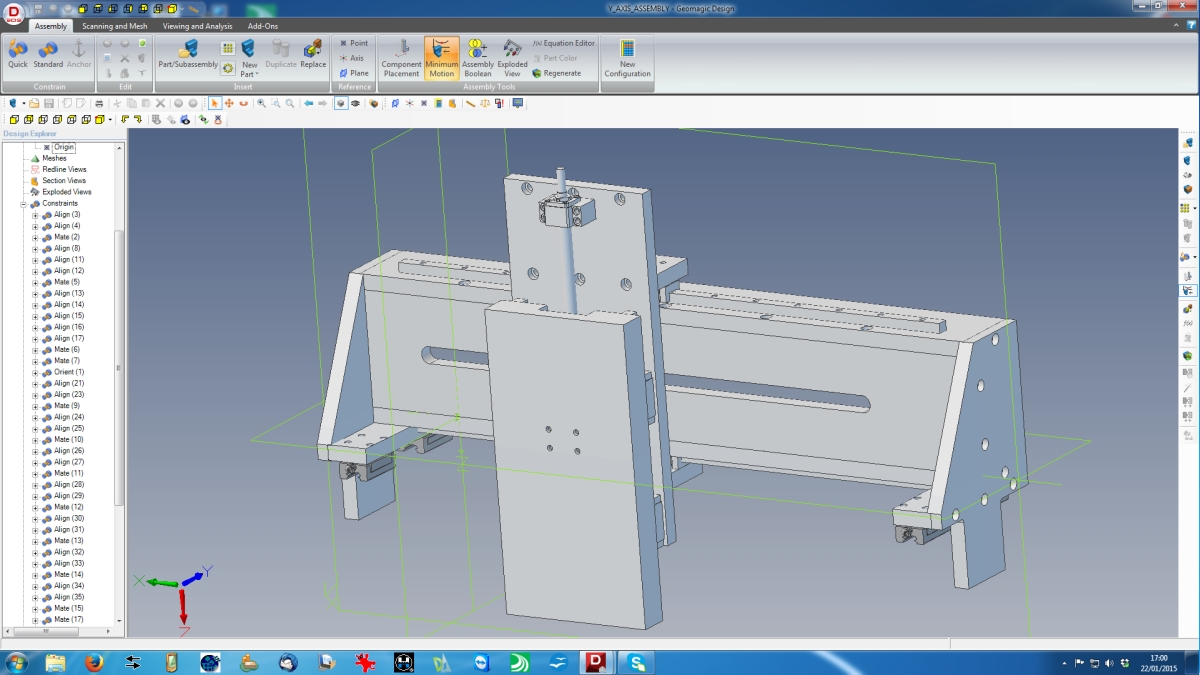

Been drawing up the gantry in Geomagic 3D program today. Getting there, so far all the holes etc. line up!

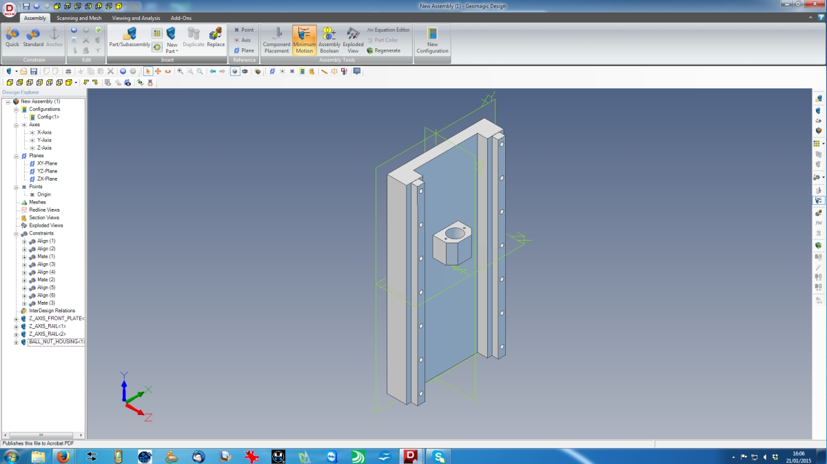

Been working on the Z axis today, not done it all by any means as work keeps flipping geting in the way...
Attachment 14480
Attachment 14481
Not drawn the plates that the Y axis Carriages attach to yet (simple so won't take long) ot the Z axis Stepper plate which is going to have a pocket for the stepper milled into it with slots so the belt can be tensioned. The Z carriages and rails are just blocks drawn to the correct dimensions but with no detail, couldn't be bothered and couldn't see the parts in the online library to download but not looked too hard!

Front plate re-drawn with smaller pocket in it...
Attachment 14484
Re: Comments sought on new build: A CNC Router for RC Gliders and Planes
Dean, you did realise that the front plate is a 40mm thick plate? The pocket is 20.6mm deep so 19.4mm still remains in the middle.
Anyhow....managed to get another few minutes on the CAD....put together the assembly and surprisingly it all fits together!
Attachment 14485

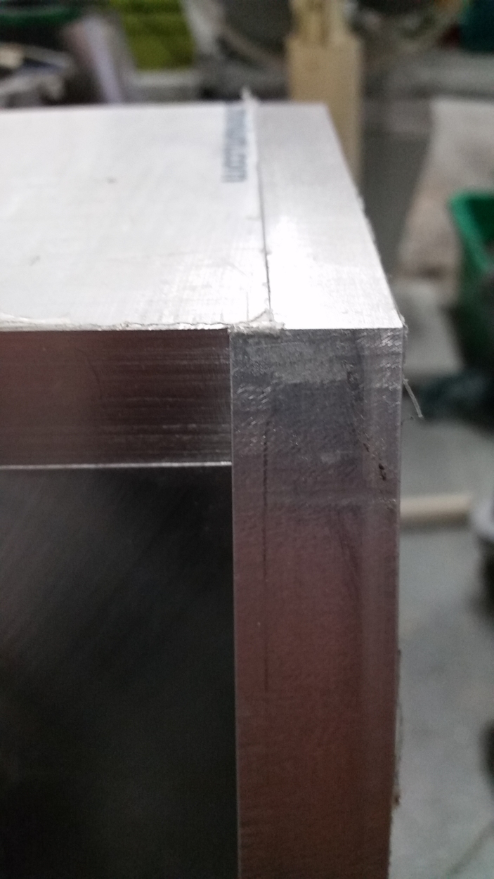

Needed some 20mm aluminium for a clamp for the pantograph arm I'm making at work so put the big plate I've got on a table and used the Evolution circular saw to cut the plate to size for the bed. The 100mm strip cut off will be used for blocks for mounting the ballscrew mounts on etc...
http://tapatalk.imageshack.com/v2/15...777a7c7978.jpg

I've been cutting 20mm Ali plate dry for years with and TCT thin kerf cross cut blade in table saw that is so knackerd it won't cut Oak without smoking the workshop but yet munches Ali no problem. Absolute must that you wear full face mask and cover arms and neck as the chips are scorching hot.!
yes tct blades cut ali with no problems as long as you take your time. Used one of these in the chop saw to ali http://www.ebay.co.uk/itm/250mm-Circ...item58b7e8d3eb at £9.50 I was a bit sceptical but it cut OK no good on wood as it burns and does not cut so well, like Dean said just fills the shop with smoke.

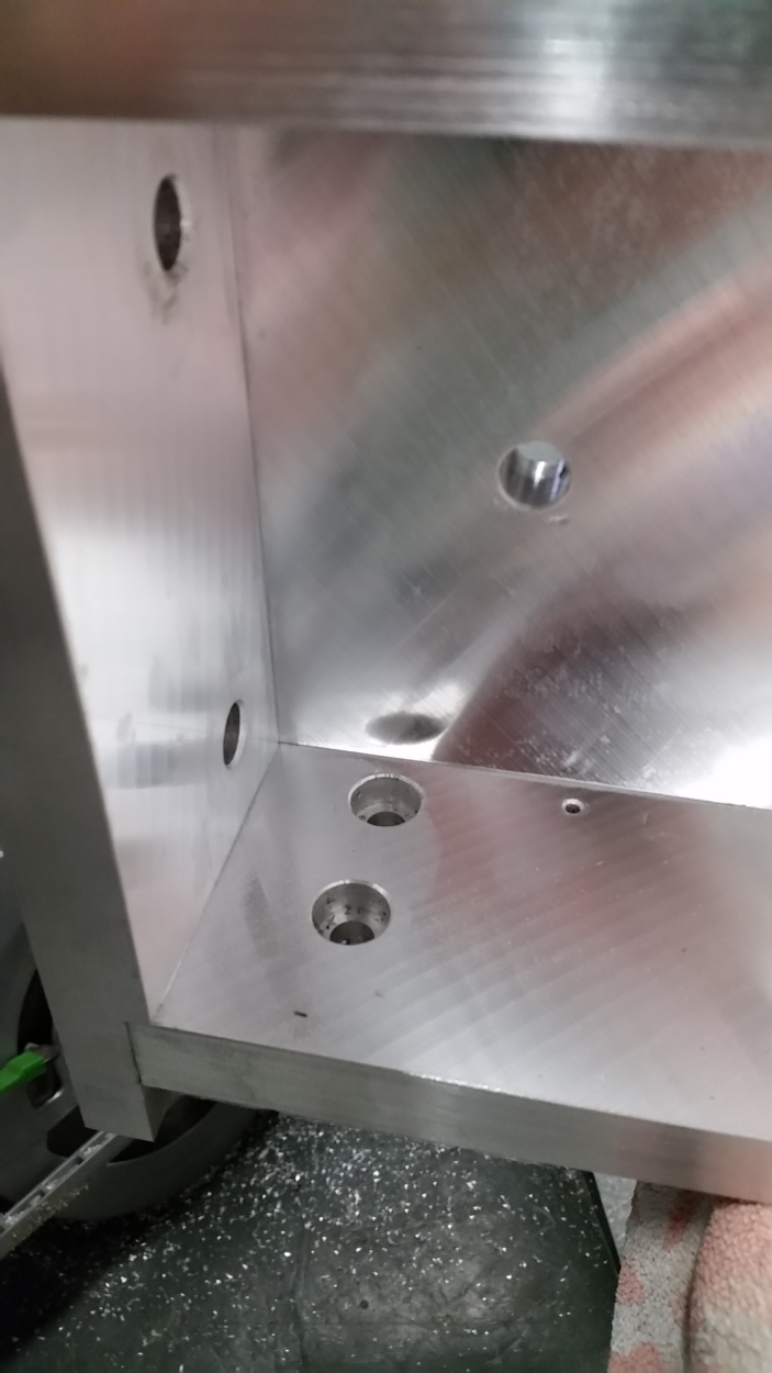

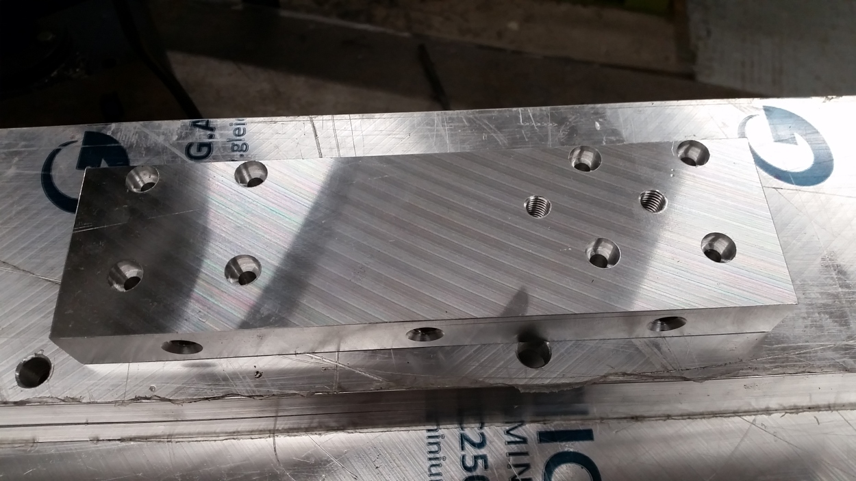

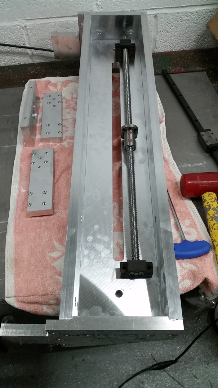

Been doing machining in between making a tapping/pantograph arm....arm's finished (minus cleaning and painting) and mounted on the wall ready for the next batch of units to come through the works.
Attachment 14639
Can't wait to get cracking on the rest of the machining and assembling the gantry.
Must start the contorl panel shortly too so will be looking through the threads and then asking lots of questions about PSU's etc......:stupid:

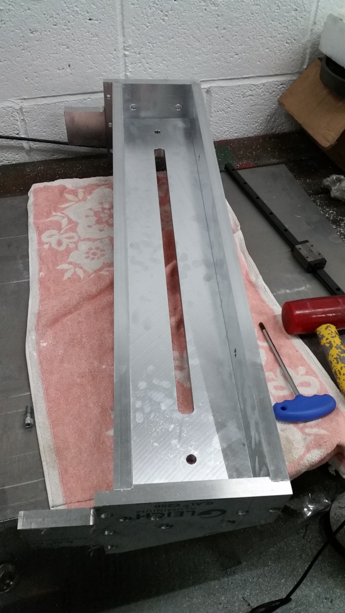

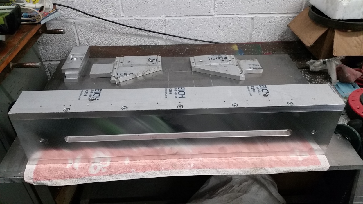

3 Attachment(s)
Got a few bits to assemble now, can't find the bolts I got for it so going to have to go out this afternoon and get some more :hopelessness:
Attachment 14642
Attachment 14643
Attachment 14641
The Z Axis plates are still to be done as are the Y carriage mounts.
Should be able to get the second X Axis rail aligned using the gantry soon :beer:

Just going to do the same for the bottom rail....
Edit: The DTI is running along the front if the aluminum plate not the rail itself...
Painting the frame tomorrow...
