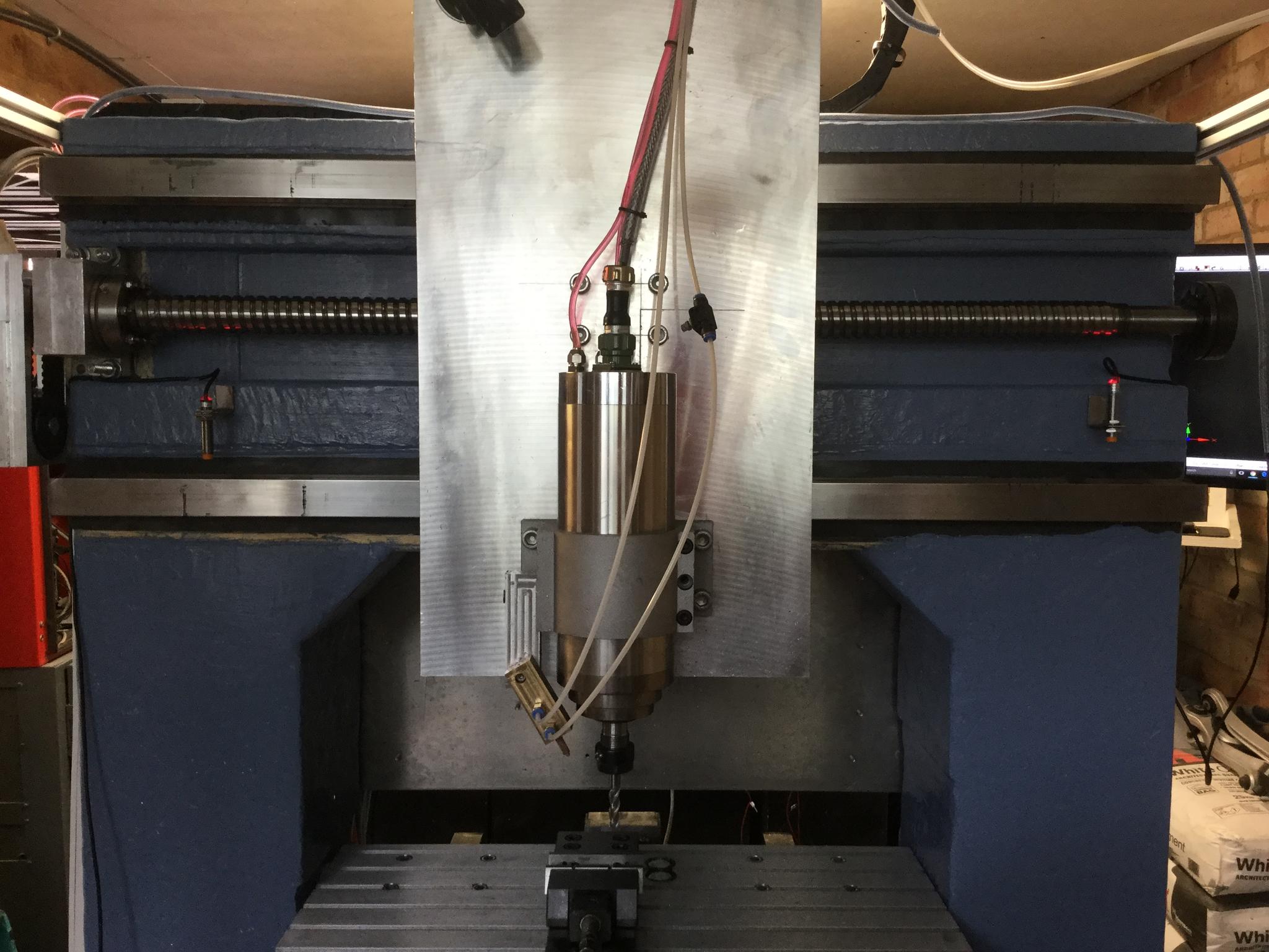

My spindle rusting from the inside out doesn't sound good :(
Why they didn't add £30 to spindle cost and use a stainless steel tank you have to wonder at least the option would be nice.
I have a Reverse Osmosis filter which essentially produces the same as distilled water so I will use this for my system with some blue antifreeze as I have a 200l barrel at work lol.

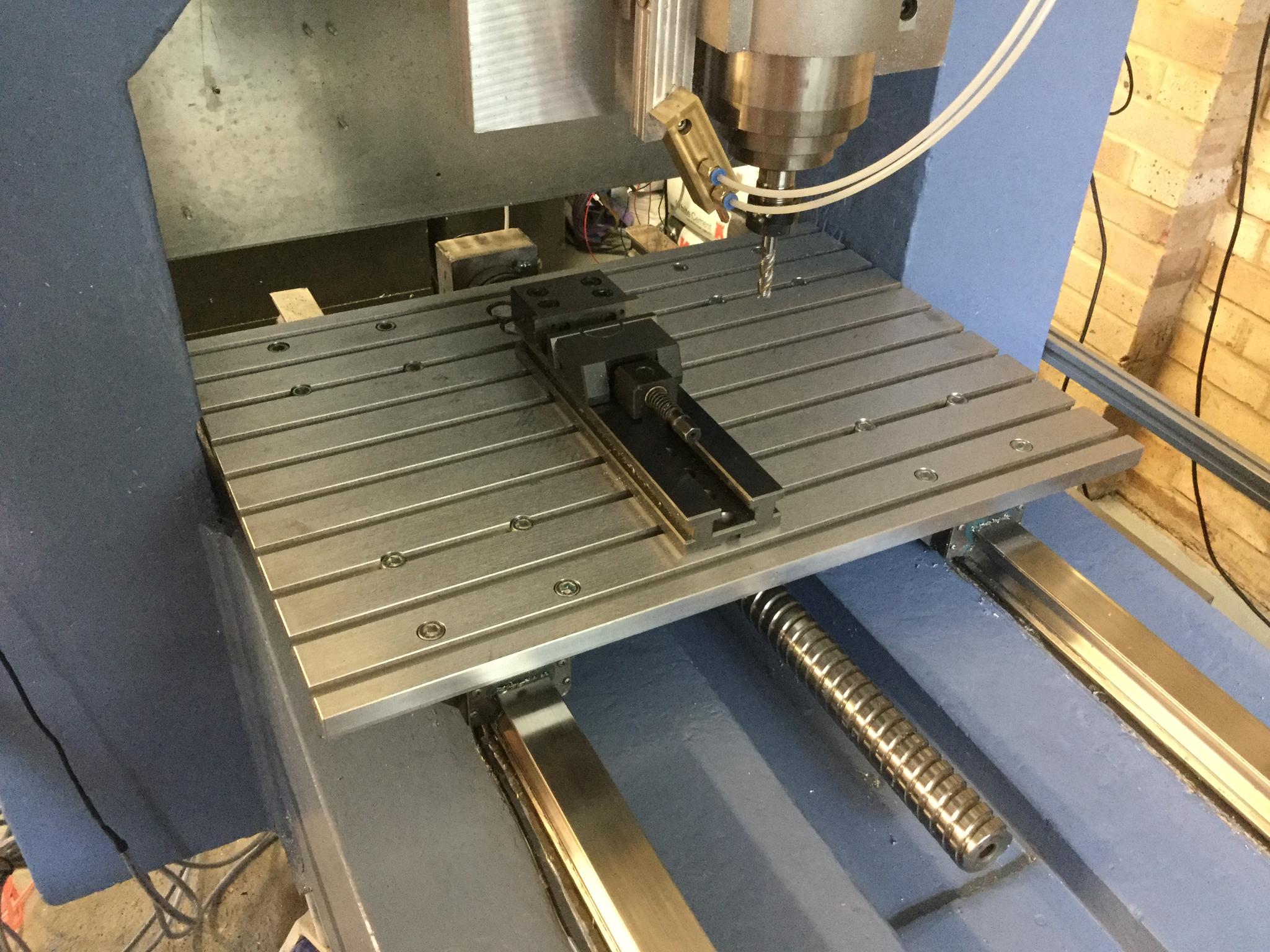

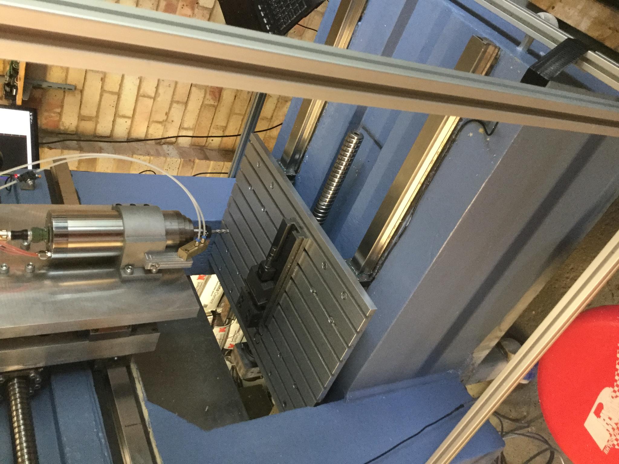

Ill post some updated pics of Thor this weekend as I complete the new table and a few bits.
I have also bought a lathe (another thread) that I was going to convert into CNC or build a new one. I then started to think of a 4th axis for Thor which I could use the same headstock for. Perhaps not good as as dividing head however this then opened up a bit of a Eureka moment this morning in the shower (one of the many places for inspirational thinking).
Here's my thoughts.
Take the headstock, mount on Thor's table. Find a way to fit a motor and spin the headstock at lathe type speeds.
Create a new Mach 3 profile, I assume that that I can now assign different axis to different channels, using the CS Labs plugin. This means that my current X can become my new Z (for lathe use). I can then either use the current Z or Y to do the lathe X. This will depend on where / how I can mount lathe tools.
For the lathe tooling, this needs to be mounted on the current spindle mount plate. I can move the current spindle and aim to have more than one 'device' hanging off the main Z plate. From this - I can either try and direct mount some tools however the best approach is likely to mount a turret of sorts. This will allow tools that profile and face to be used, as well as anything that needs to drill or bore.
Any reason this might not work or is an obvious bad idea?

It is doable, however, the big question I'd ask is, how much effort is it going to be to swap between lathe and router?
Re: Thor, or should that be Zeus?
m_c
Understood. If the lathe tools / turrets are mounted to the right of the spindle, it could be as easy as just starting the correct Mach 3 profile, no other work needed.

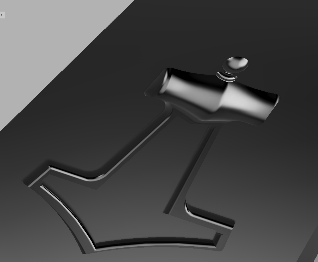

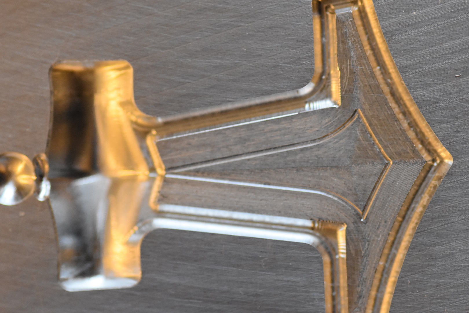

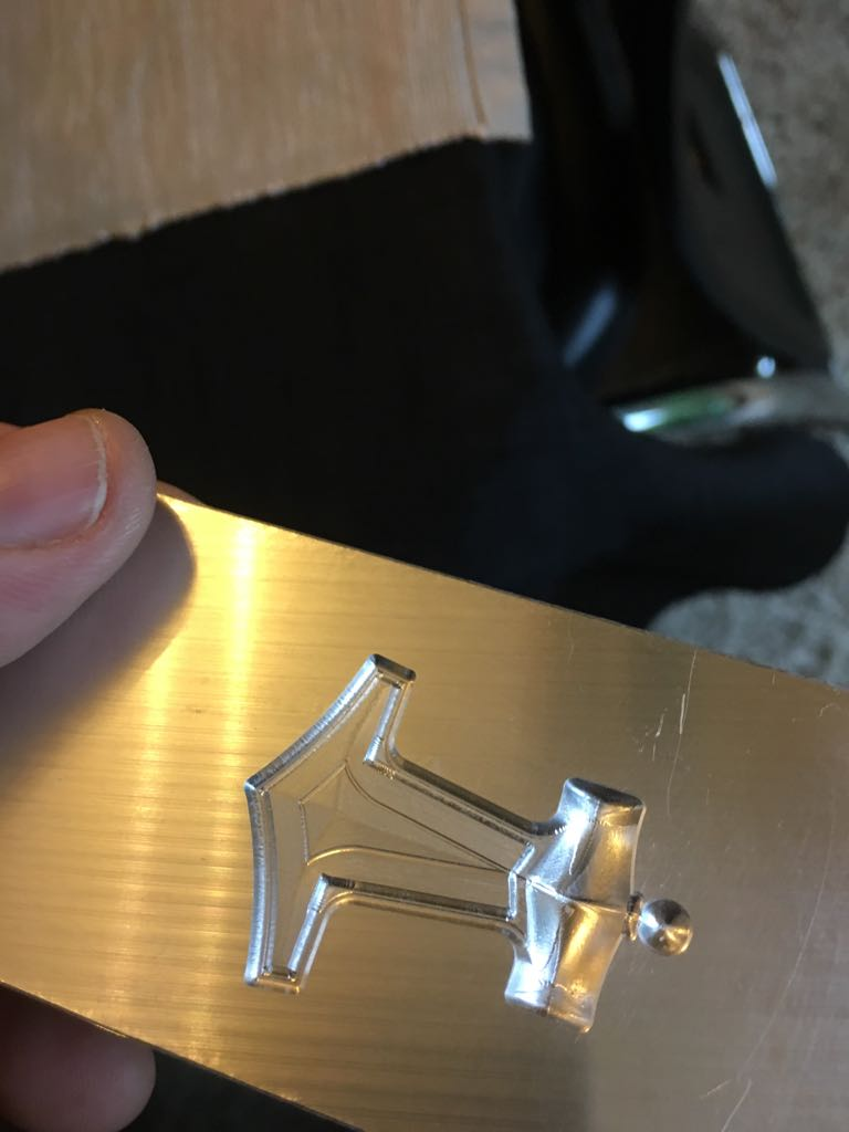

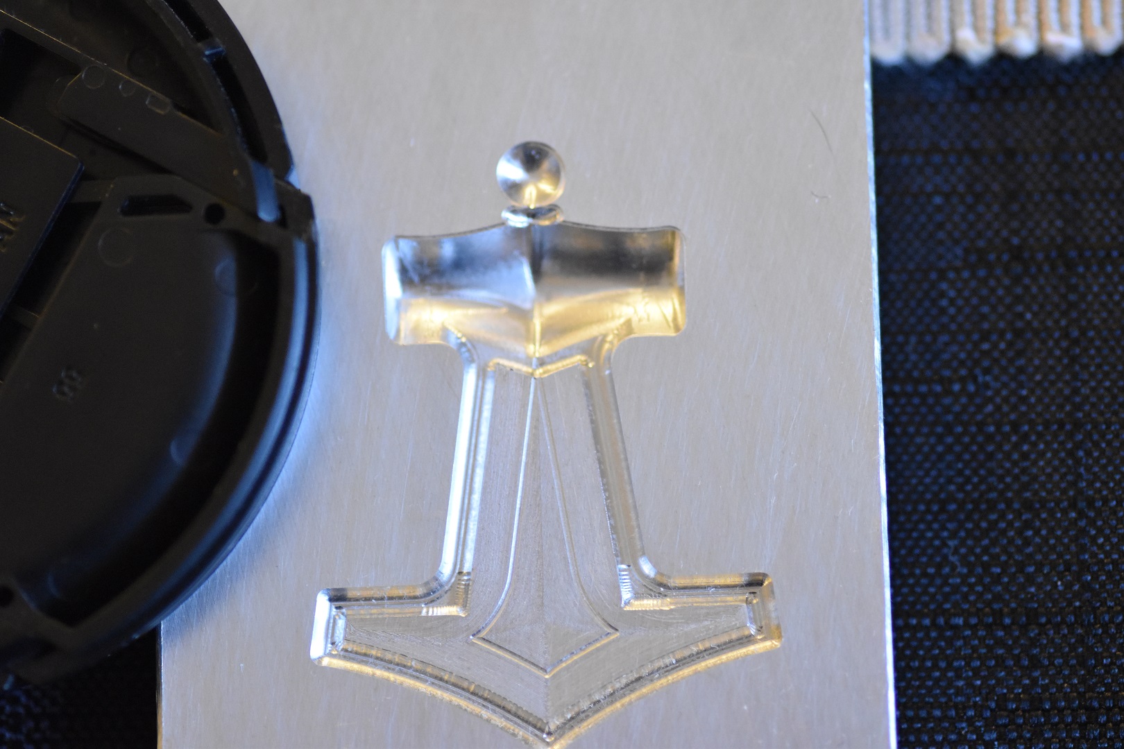

So Ive finally gotten around to doing something 3D. Took Thor's hammer (Mjolnir) and then cut in half and milled it out. Looks like an anchor unfortunately.
However .....
1.5mm ballend mill, 24K RPM, 0.1mm stepover, scallop operation in Fusion 360, around 25 mins.
Normal camera pic and then two high res macro pics to show warts and all. From the naked eye the part looks good. Polishing / Finishing will improve it even further.
Attachment 22284Attachment 22285Attachment 22286Attachment 22287

Thanks for taking the time to take and share the macro shots, its nice to see exactly what the finish is like from different machines.
No problem, Ill do more of it as I do more machining and work out the good / bad / ugly of the machine's ability.
The macro shot makes the part look fairly horrible however in reality, its not. Its 'as it comes' and can easily be polished up.

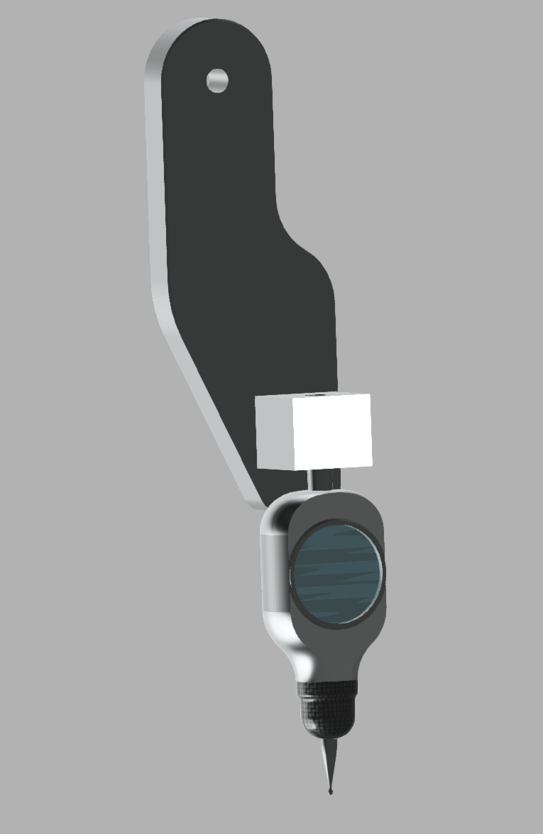

So Ive bit the bullet and bought a 'proper' probe. Its mechanical, not electrical and I want to make an arm for it like the Datron has that comes down, probes and I can then move it back in the 'up' position when not needed. Thinking to use some form of offsets to make this work.
How do I manage with an arm to rotate 180 degrees? Arduino Uno and servo? Id need a fairly strong servo me thinks ....
Thoughts?
Attachment 22695
Thoughts?
Attachment 22695
Do you think it is possible to rotate about a hole/pin and get the repeatability ? How about sliding the arm up and down with a piece of spring steel to hold it against a ground edge? Could have a slot in the middle with a fixed dowel pin to give top and bottom end stops. Then add detents for top and bottom position. Manually move it up and down as required or drive it via a motor with a cam?
Well, I'm bad with this type of thinking. Datron have this on their machines (it pivots 180 down), so there must be a way but im not against it going up / down instead, anything I can look at on Youtube for inspiration?

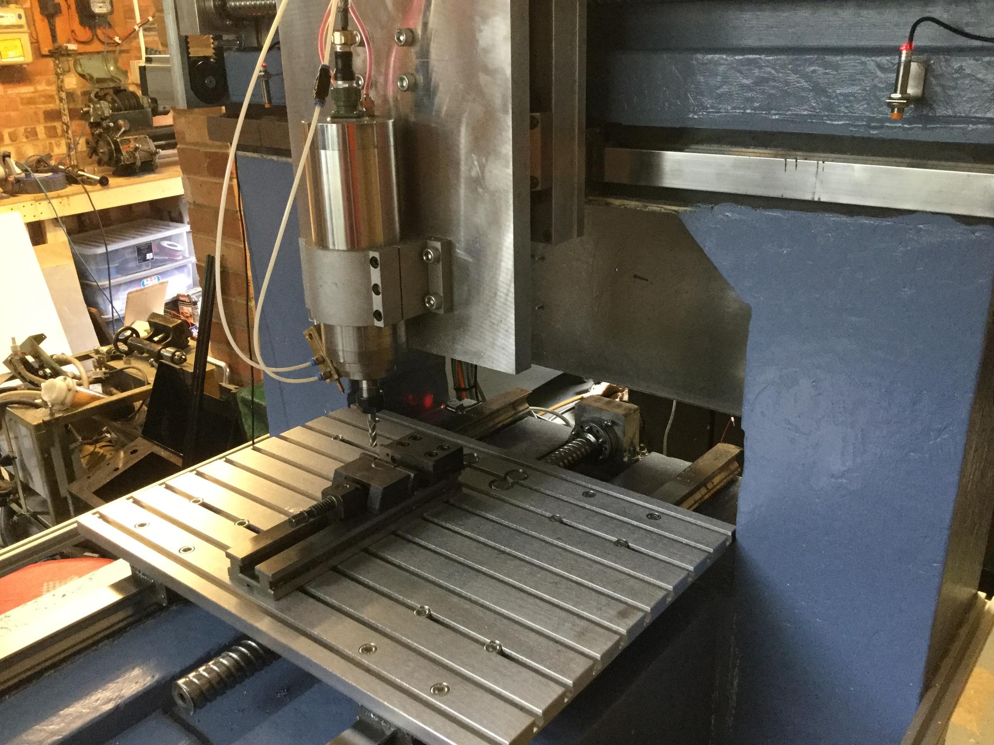

A quick test cut. Looks like Ill be ordering more tool holders. Happy with the initial results. My Z is fairly heavy however (As predicted), might need to look at changing the gearing on both X and Z axis now.
