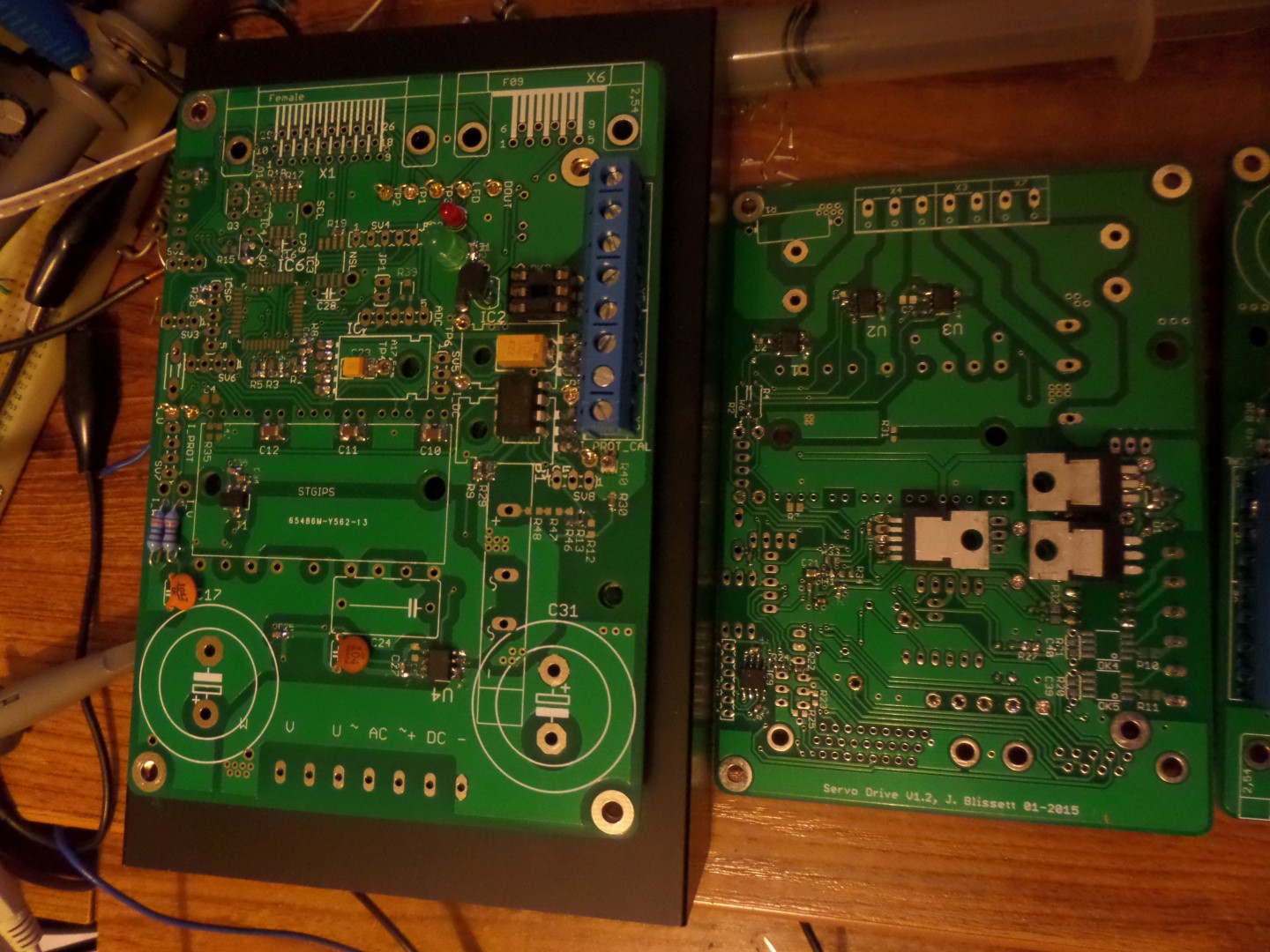

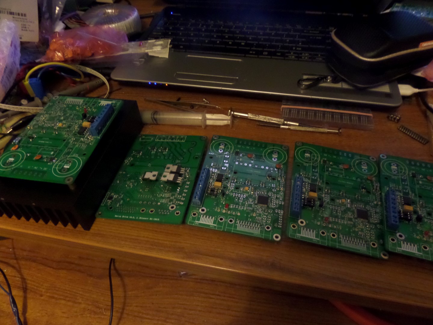

Really trying to keep the ball rolling with this project, but my PhD work and related things keep getting in the way as I tend to be spending 9am~8pm in the lab. Still, I have however done some more soldering on a few of the PCBs. Here are a few pictures:
http://www.mycncuk.com/attachment.ph...id=14924&stc=1http://www.mycncuk.com/attachment.ph...id=14925&stc=1

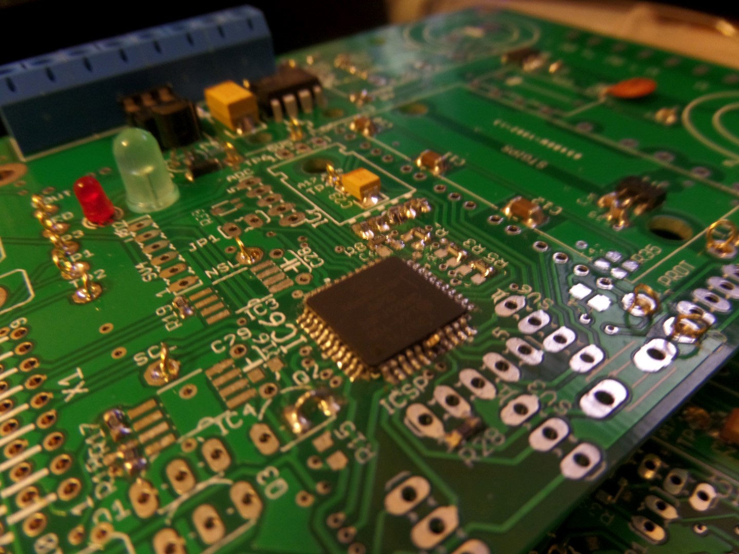

Can anyone spot the mistake in this one...
http://www.mycncuk.com/attachment.ph...id=14926&stc=1

I cant see that great on my phone, but is it that component across the pins on the microcontroller?

Yes that's right - I accidentally connected the core voltage regulation filter pin to Vss instead of the capacitor. Fortunately that pin is only connected to a capacitor, so I'm instead lifting that pin and soldering an 0402 capacitor between it and the adjacent Vss pin. Bit fiddly, but it works ...
I've not found any other mistakes yet.
