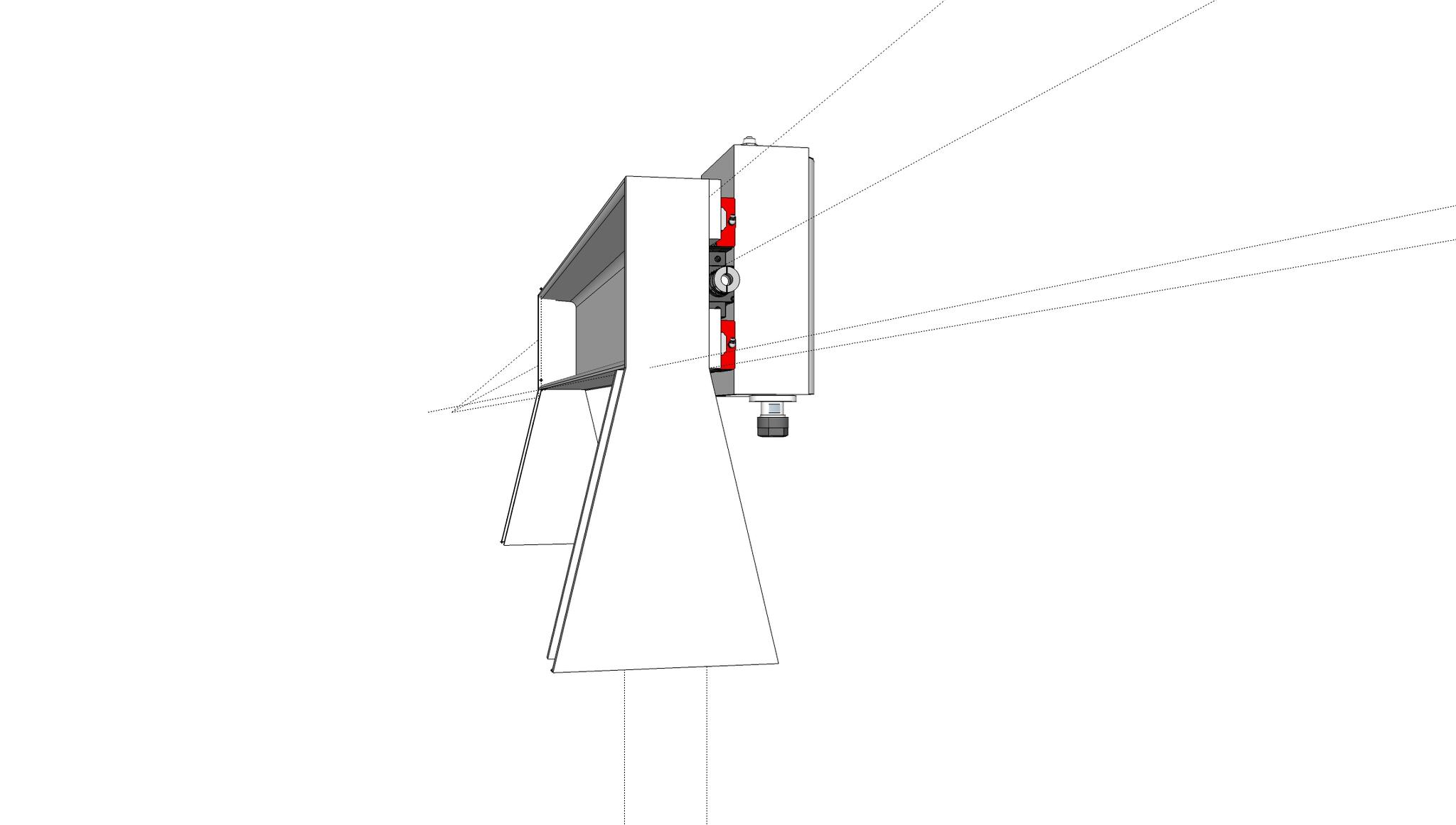

what about the ballscrew diameter? how its calculated? i have 2 x 1300mm length 25mm diameter and 2 x 1000mm but 16mm diameter (1605 i think that is the model).
will be the 16mm very small for the Y Axis? im thinking abt purchase 20mm Hiwin rails as you guys recommend me maybe 2 x 1000mm to get close to 800 mm of travel.
As i have 1300mmm i need to cut it and will waste like 400mm :(
cut the 16mm will be better for me, because can use the UPN that i purchased today and think that will not fit the 20mm rails + 25mm ballscrew because have just 160mm width.

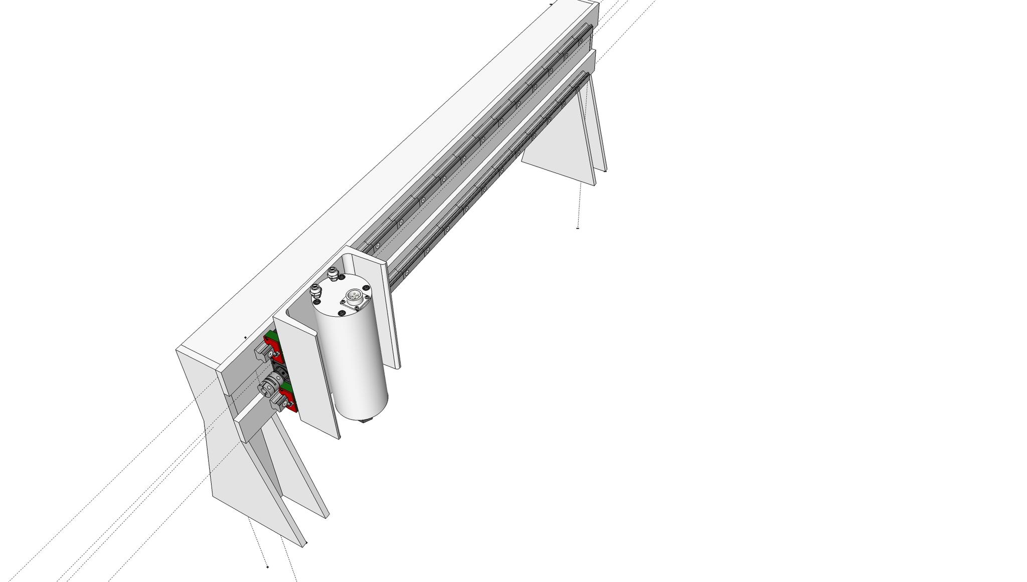

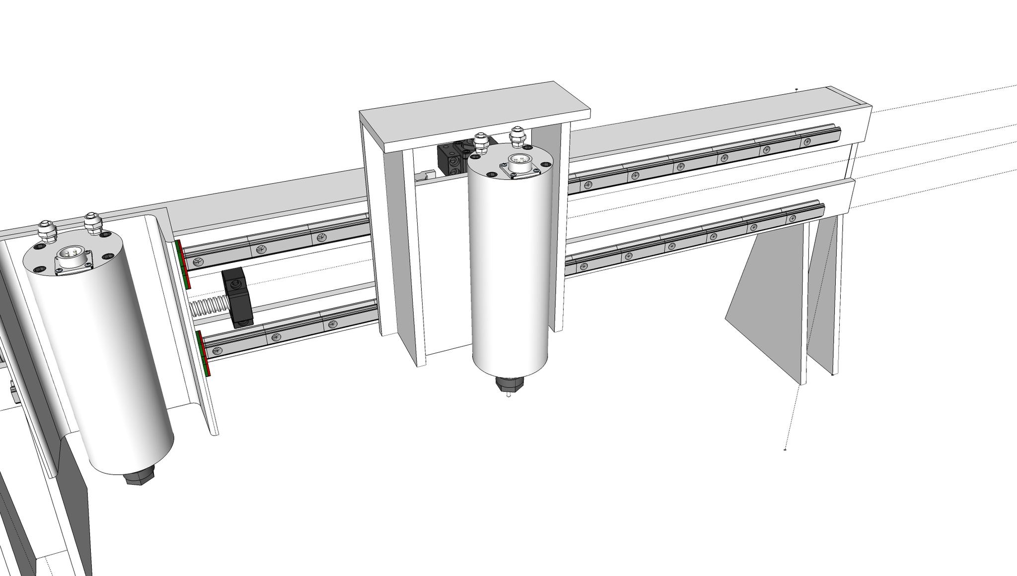

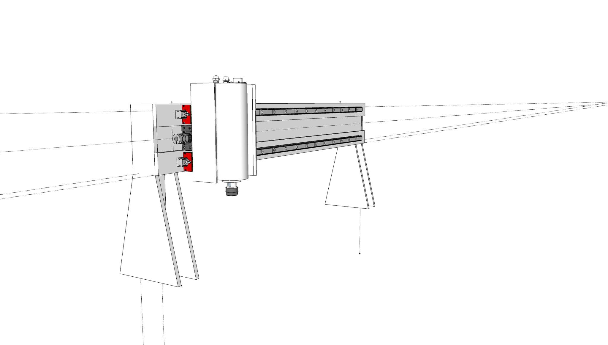

Well my first idea was something like this for Y fixed gantry...
Attachment 18584Attachment 18585Attachment 18586
i can reinforce the tower welding a plate in diagonal and can reinforce the back of the UPN too welding it too.
if close the structure can fill with sand or similar to get more weight.
i dont want high Z Axis, think that 70-80mm travel will be enough.
Its my old Z Axis idea, i want to avoid welding the parts and use an UPN as show in first image
Attachment 18587
Sorry for my english
My first observation is that you have to be able to build it and assemble the parts have you thought how you would bolt the bearing blocks to the z plate (I think the blocks are to close together). This is why you should draw it out to see these problems.
